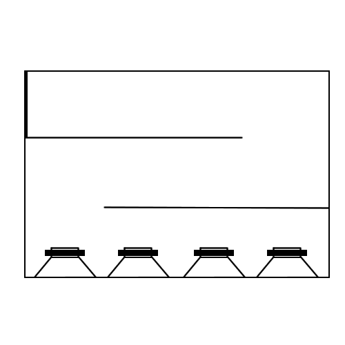

I am playing with the idea of one of these systems to get ultra low bass in my system. I will probably opt for decent car audio subs that tend to be low sensitivity and high power handling, as amplification is not an issue, and I will be using it in conjunction with a conventional sub, this will only be needed to fill in the low end.
I thought maybe using a design utilising a square cross section pipe that has been folded and maintains a constant area throughout the bends, with four subs, probably 12" mounted along the front face.
If this idea would work, where does the pipe 'begin', or is the chamber immediately at the rear of the woofers still the pipe? And will having some drivers further away from the pipe cause issues?
Or if there is a better way that I can reach at least 20Hz, with usable output down to 15 Hz being preferable. As for finding a driver with a low enough fs, could I simply take measurements and add mass to the cones? I know that this will reduce sensitivity, but I have enough amplification and car subs are generally high power.
I want to use car subs because drivers of reasonable quality can be had rather cheap and are easy to find.
And to tune the pipe, do I simply make the length 1/4 of the wavelength of the lowest frequency I wish to reproduce? What about width? What speaker parameters do I need to know?
Here is a picture of the design I mentioned above. Pretty self explanatory, with the thick line top left being the vent exit. Cross section is square throughout the pipe, the diagram is birds-eye view.
