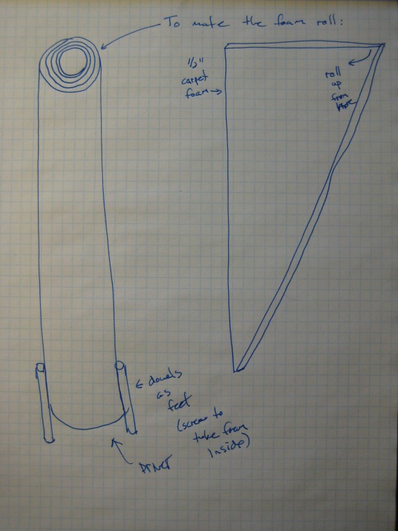

An easy way to achieve both stuffing and tapering that I've suggested from time to time:
1) Cut a sheet of foam (I've used 1/2" carpet foam...thicker works just as well, but gets harder to work with) into a right triangle.
2) Lay it out on the floor with the 90 degree angle next to your right hand.
3) Start rolling from the corner on your left--the small end of the foam. You want this on the inside.
4) Roll all the way to the right. You should now have a foam tube with an inverted cone on the inside. Look in the wide end and you'll see the cone taper towards the other end. Look at the narrow end and you'll see either a closed spiral or a small hole depending on the proportions of the triangle.
5) Slide the foam into the outer tube. You have now both stuffed and tapered the tube.
Simple.
Yes, there are better ways, but this is cheap, easy, and fast.

the stuff your link shows should be perfect! I personally don't think that you need to get really thick walled tubes, the inherent strength of a cylinder does not require a huge thickness. On the other hand, I have not looked into the issue of resonance - I am using commercially available (in the U.S.) sonotube which isn't more than 3/8" thick. I have not experienced any resonance issues either. All the sound (air pressure) is coming out of the mouth of the tube. Use the cheapest stuff you can get. Also, using an 18" car sub would be great. I used a cerwin vega car sub because it is what I had unused, and it works fabulously. I also laid my tube on it's side because of space issues and I have heard that most speakers are not designed to be oriented in a horizontal plane. Anyhow, I think the main thing is that you just build it and experiment for yourself. I don't think you will be disappointed.😉
Any rigid tube will suffice. I tend to use MDF for my transmission lines, but I've used PVC pipe at times; other people prefer cardboard tubes. The thickness doesn't increase the density per se, but it does tend to increase the rigidity, which is what you want in the final analysis.
Be afraid...be very afraid of car woofers. They are far from flat. They tend to have a very pronounced hump ca. 80Hz followed by a strong rolloff. It's nothing to see a car woofer that's down by 15-20dB in the 20-30Hz range. Yes, it can be equalized, but why should you have to go to such strenuous efforts to get something like flat response? Also bear in mind the phase aberrations you introduce with the eq, etc. Ugh.

Hi Prof. Smith,
The best explanation of all your questions is in Martin J. King's website:
http://www.quarter-wave.com/TLs/Alignment_Tables.pdf
Give that paper a read over at least once or twice, and give it time to sink in. It's fairly straightforward and very well written.
Tapering the pipe increases the impedance of the open end, and if you work through the equations on page 3 you'll see the relationship to pipe length.

I've attached another one of my terrible drawings, which might explain what's going on. I have this strange ability to picture things perfectly in my head, but drawing them out the way I see them mentally always turns out to be a mess... I think I'm spatially challenged when it comes to drawing.
Let me know what you think, and we'll go from there.
