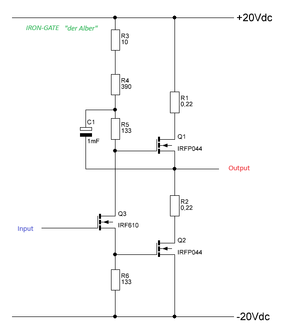

The three ideas of "the Iron Port" are merely ideas in every respect. 1 & 2 are not fully developed at the present time, I would not give a functional guarantee (suitability for everyday use). To be honest, there are still a lot of design issues - and the hours spent on the simulator just fly by. You could follow the structure and method of the Siemens BUZ-Amp or Marcel van de Gevel's example ("Audio power with a new loop" EW02-96), but that would basically be like writing it off.

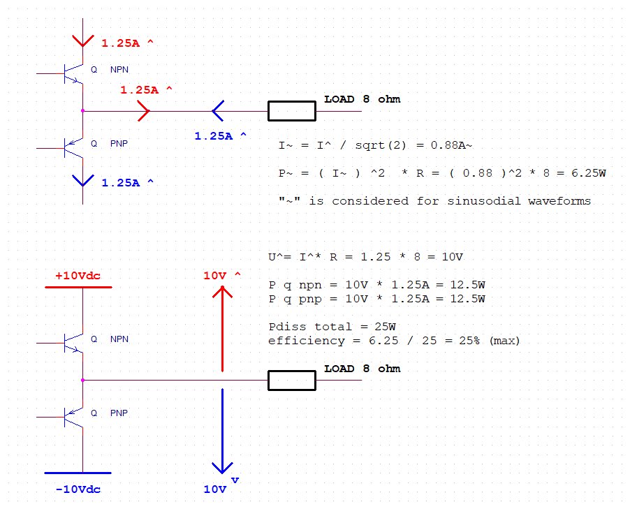

If we stay (briefly) with possible A operation in push-pull mode and assume a static load of 8 ohms, then (in my opinion) a quiescent current of 1.25Adc should flow permanently through the output stage. The famous >0.8A comes from the 1.25 / sqrt(2) idea, but is that really true? That would be nice.
But now we would already need two pairs of IRFs.
Considering that the fets are actually there to switch loads, for example PWM or motion controllers, unwanted behavior is always to be expected. And the same applies to the first two ideas, the JLH-like output stage.

Power and class issues
Basically, U*I=P
and for direct currents the topic is really easy to understand. If we remember that we are talking about an area (the product), it becomes even easier.
A practical example; Elektor magazine (issue 10/91) advertised the "Class A LFA" as a 50 watt amplifier with an optimized Class A setting. Further on in the advertising text we read, "and remains in class A up to the -3dB level limit /clipping /max swing".
The output stage is a compound arrangement with the famous Sanken ring emitters BJTs. The quiescent current is a total of 1.255Adc, the power supply is regulated at +/-30Vdc. This means that the output stage can be savely driven at least up to 27Vpeak without clipping if the power supply can also supply the necessary load current. The load is specified as a static 8 Ohm and everything is considered in steady state.
Peak power (under sinusoidal control),
(27V)^2 / 8Ohm = 91.125Wp Now the power supply unit should be able to deliver at least 3.375Ap. However, the power comparison is based on the identical heat that a direct current would cause, so we should (or even must, or we must integrate) use the effective values of the voltage and current - RMS - for the calculation. Everything else is just eyewash.
(19.092Vrms)^2 / 8Ohm = 45.563W, the addition RMS is usually omitted.
10 *log(45.563W/91.125Wp) = -3dB
However, the quiescent current is only 1.255Adc.
Break
(1.255A)^2 * 8Ohm corresponds to 12.6W or 10.04V * 1.255A according to the known formula or the calculation of a square area.
However, Elektor speaks of 50W in an optimized class A setting (see the power rating of -3dB), how can this be explained?
Quite simply, one considers the case dynamically, i.e. in ac-view, and imagines two identical sources in parallel -> in push-pull, not single-ended mode.
Now we can calculate with (2*1.255A)^2. This results in the 25Wrms for a static load of 8Ohms in a stationary state (that we have already assumed in the back of our minds). The peak power under the sinusoidal consideration is simply twice as much, i.e. 50Wpeak.
Single-ended = 12.5W vs. push-pull = 25W.
Conclusion
In reality, the Elektor amplifier is a 25W type.
Let's take the MF-A1 as another example, with the typical 0.8A quiescent current and calculate (2*0.8A)^2 * 8Ohm = 20.48Wpeak.
If the 0.8A represents the absolute peak, the maximum level of the current curve over time, then we can now speak of 20.48Wp -> for push-pull A operation this is logically 10.24Wrms.
But sqrt(8Ohm * 20.48Wp) = 12.8Vp, i.e. conversely, a little more would be possible in terms of voltage. And the A1 is known to be controllable up to the rails (at this moment it goes up in smoke, but that's another topic). (20Vdc)^2 / 8Ohm = 50Wpeak ---> 25Wrms.
However, these maximum 25 watts are no longer A-class watts.
Correct
for 20W the power amplifier must be driven up to 18V - peak. This corresponds to a current of 2.25A - peak. As a comparable RMS value, this is exactly 1.591A. Tim de Paravincini has halved this value due to the dynamic approach of push-pull operation and therefore arrives at 0.8A quiescent current.
If only that were true, it would be so nice - but unfortunately it is not.
2 times the quiescent current corresponds to the maximum peak current in push-pull operation shortly before the end (smoke) and the begin of true Class-B. In between lies the AB operation.

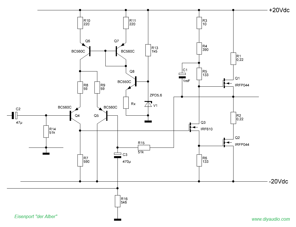

(I want to submit the latest iteration of the first idea right away, simulated, i.e. in the computer, it is already detailed ... which definitely leads to extreme sleep deprivation. I'll draw up the circuit diagram in a moment and then I'll start a test setup in the next few weeks. The exciting result for me, however, is the fact that the distortion spectrum almost corresponds to the current A1 publications, at least in the computer, if I remember correctly).
Second stage
A classic negative feedback, three resistors and a coupling capacitor and the inverting amplifier would be ready. It already simulates itself really well and is almost rail-to-rail controllable, and as an inverted version it is also completely uncritical and stable. The bandwidth is greater than 300kHz. Even if I have absolutely not copied (from Nelson Pass), the whole scenario is ultimately no coincidence. The tools are the same, the rules are the same ... R_load equal 8Ohms.
Reactions: cumbb
Ok 🙂, i'll try it.
First stage plus ...
If I remember everything correctly (the file is at home on an old computer), this is the result of my nightly simulations. Of course it's not complete, but it gives an impression. Some tricks and physical couplings are still necessary to compensate for the thermal drift. But I am very confident and completely satisfied with the predictions. The construction will ultimately show.

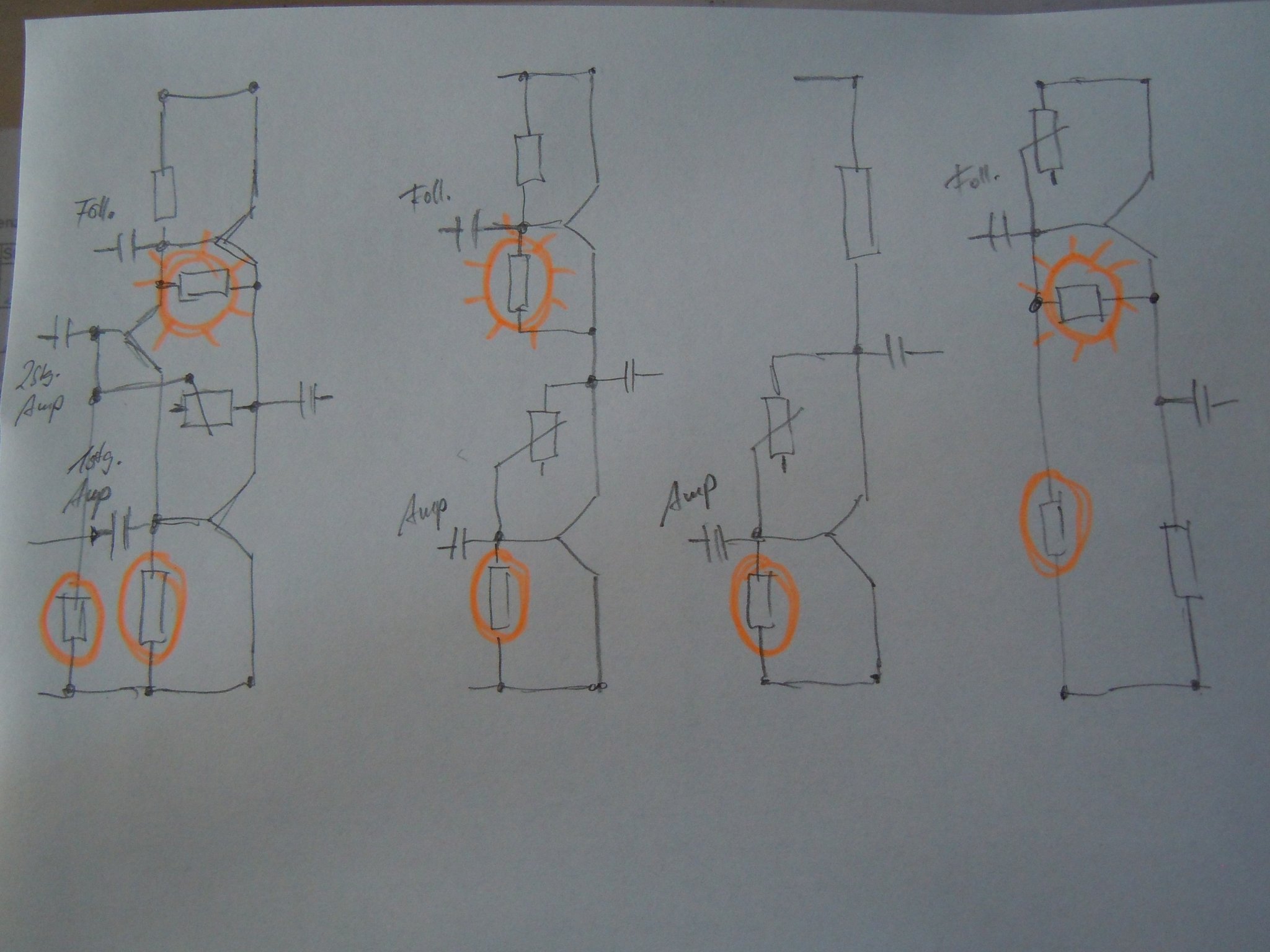

The JLH, i.e. the three trannies, is incredibly stable. I've built dozens, and none of them ever needed emitter/source resistors. I also see this as an advantage, because good-sounding resistors are rare. The wirewound, ceramic ones sound gray, grainy, coarse. As power resistors, film resistors in TO- housings are the best choice.
Getting the feedback via a differential amplifier adds a transistor unnecessarily. Compared to feedback via the input, the sound is doughier and less clear.

Metal film or MOX should fit well. But why not be specific - and make an exact component recommendation? A source of supply would also be great. I would be happy to try it out.
