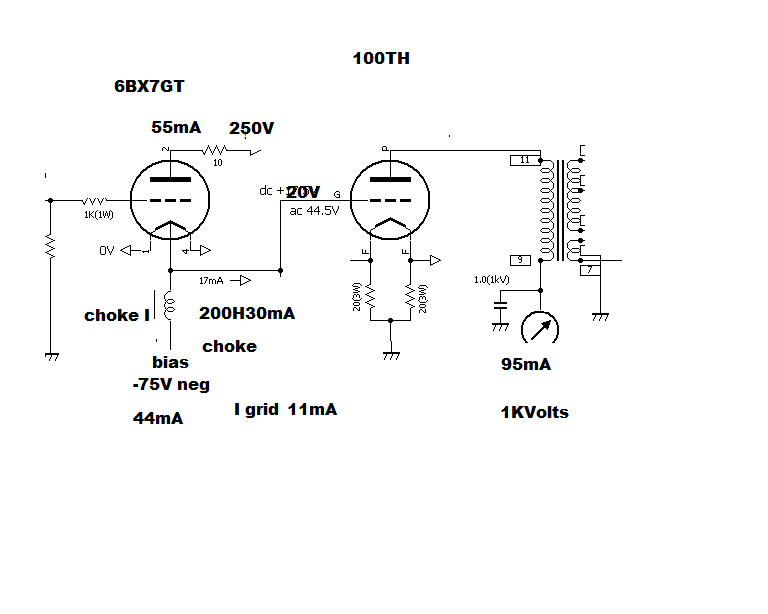

the proto amp i build sound fantastic input stage 6SN7 and CF choke loaded driver parallel 6BX7 direct coupled to 100TH grid

this was the starting point ended with 6BX7 and mosfet regulated +B +- 300V fixing 100TH bias

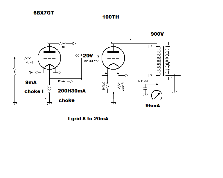

also try this attached schematics but the initial simplest do perfectly the job
should not push to 100Watts SE for tube life these are pulse triodes
power grid should be positive and draw current so direct coupled to driver cathode yes

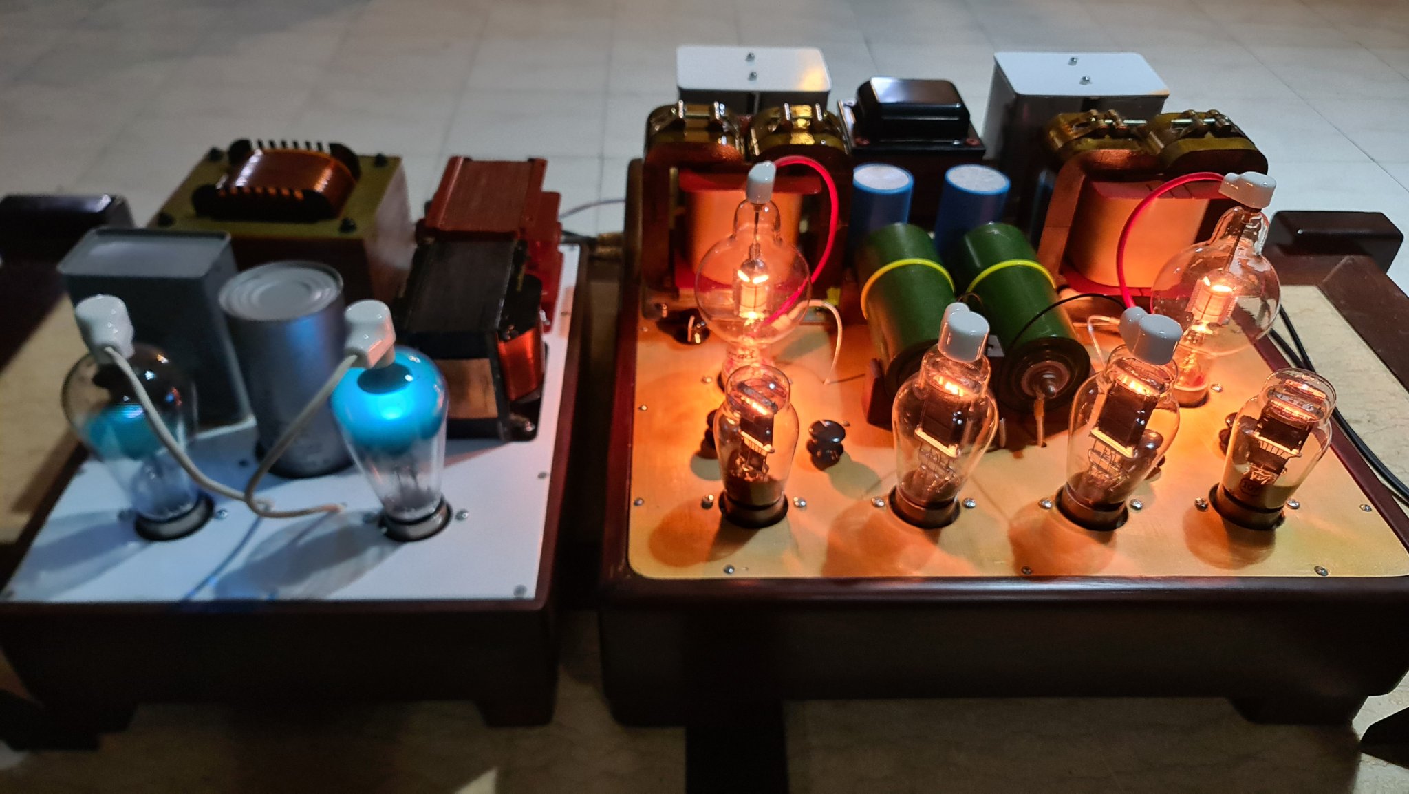

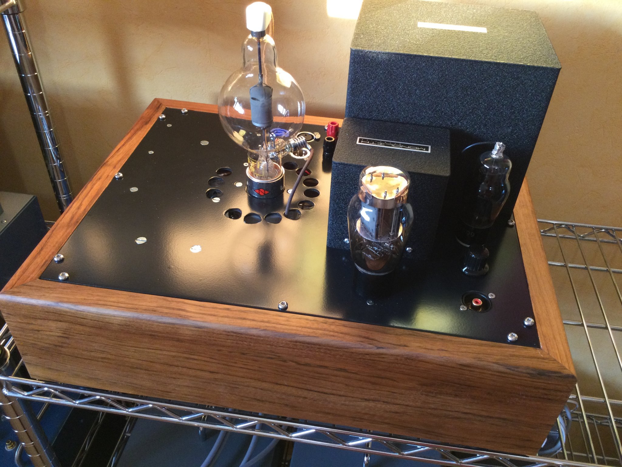

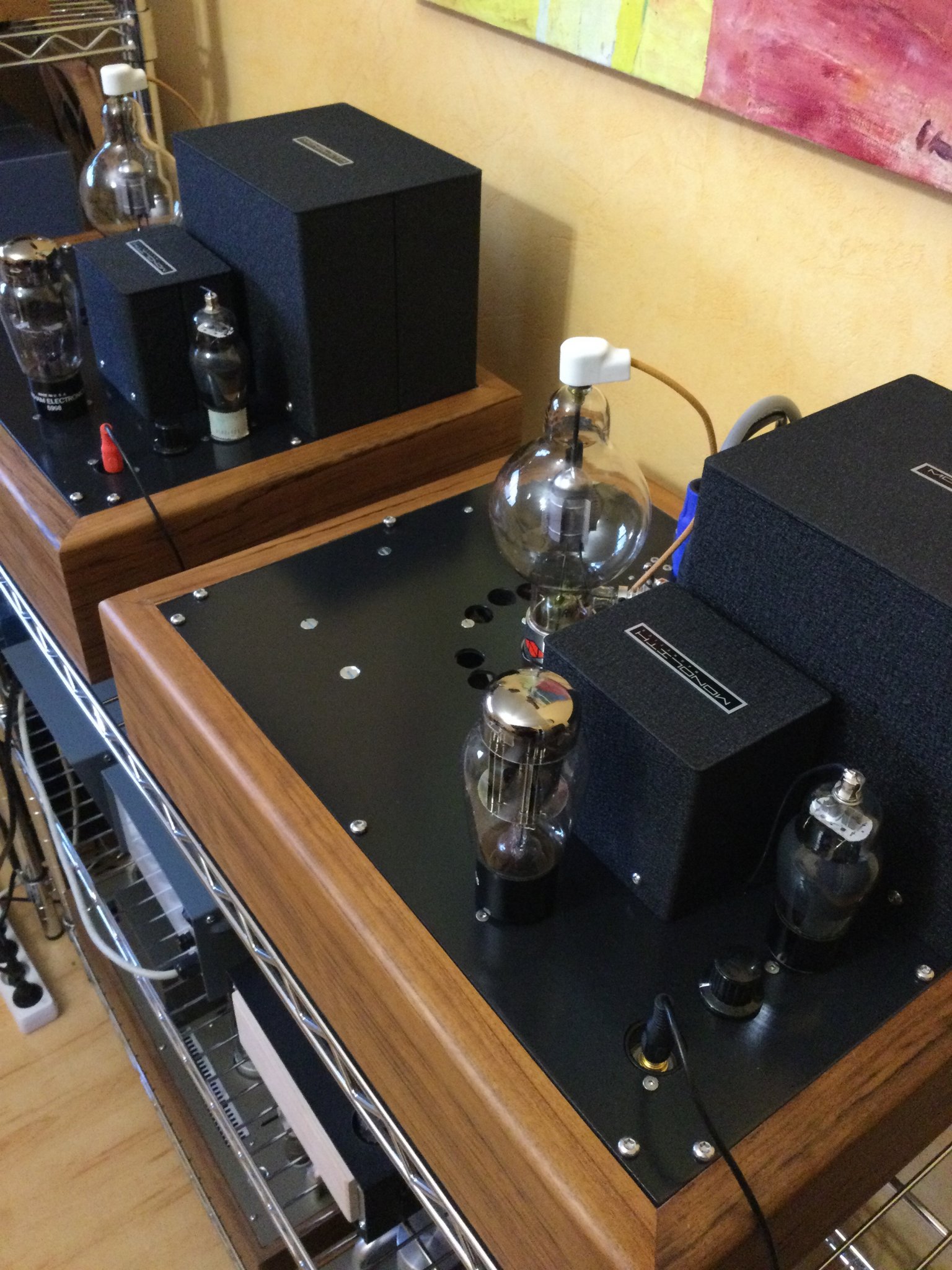

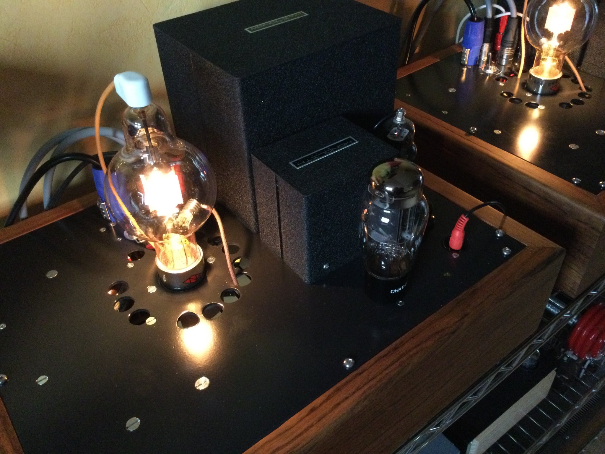

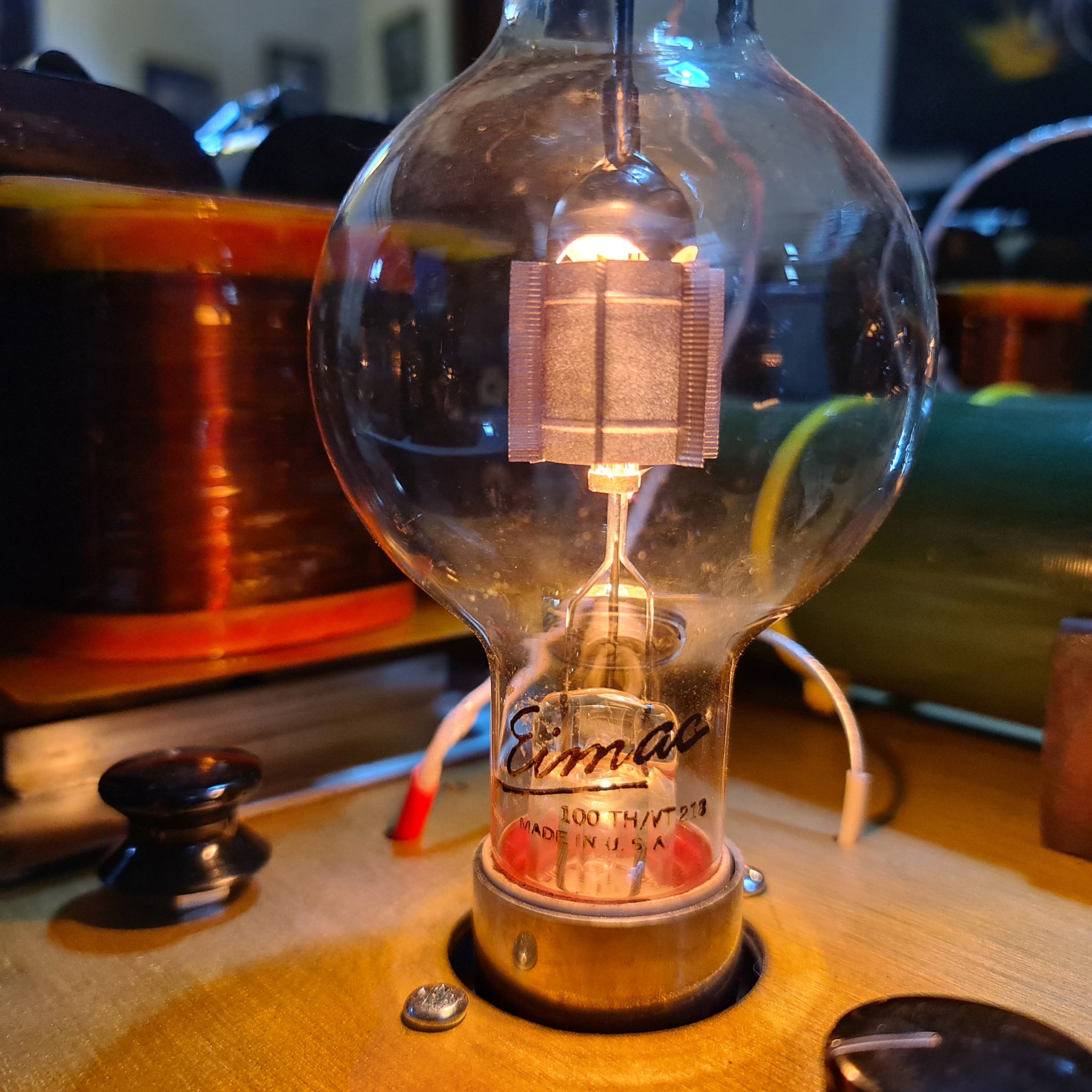

Hello all !
I just finished two 100TH monoblocks and the sound is amasing, power and clarity from highs to lows without fatigue.
Far away from a tubby sound !
The power is 20 watts rms.
Some pics :
Some pics :

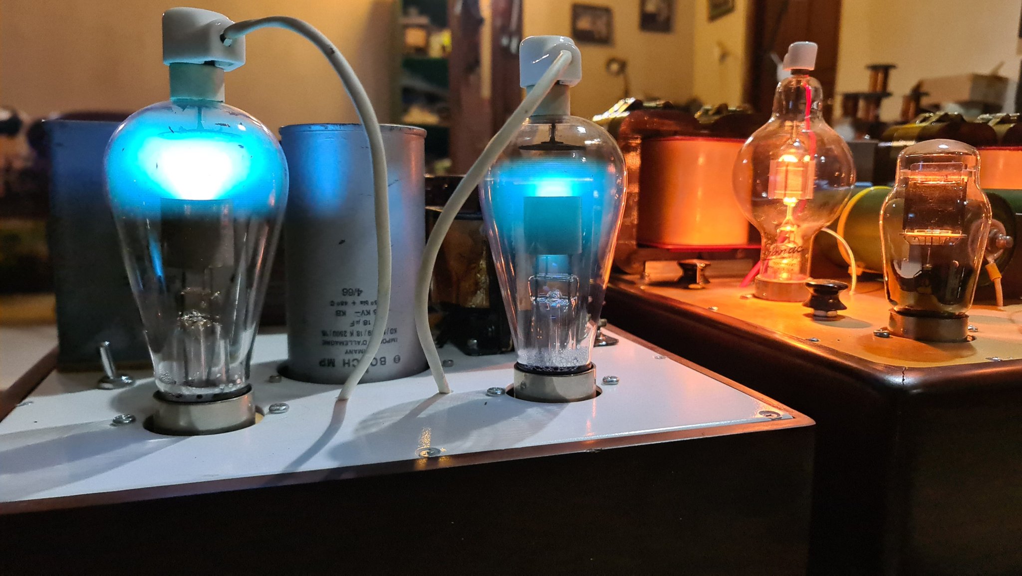

Those sharp looking Mullards with the ice blue beams between the discs are coming in a close second for me. This is VT "porn" at its best - thanks for making me feel what it's like to "want" again ;') Look but dont touch!IMO nothing beats the looks of that spherical bottle & magnificent light.
Hello, I have some L&K 100TH, they are ok and thé sound is perhaps a little less refined vs wings Eimac,Beautiful, félicitations !IMO nothing beats the looks of that spherical bottle & magnificent light.
Does any of you 100th builders have an opinion on Lewis & Kaufman JAN-CBOP-100TH ? They are available locally. I'm slowly gathering parts for a build myself.
usually they polarise hotter than Eimac in same circuit .
I had one faultly but you always need more 100TH you need because some are bad by all makers.
Behold a whole new market: When the blue pills fail, turn on the blue lightsThis is VT "porn" at its best - thanks for making me feel what it's like to "want" again ;') Look but dont touch!

this amp still running but with SV572/160 , the TL304SE run with four 100TH, two in parallel each channelBehold a whole new market: When the blue pills fail, turn on the blue lights
