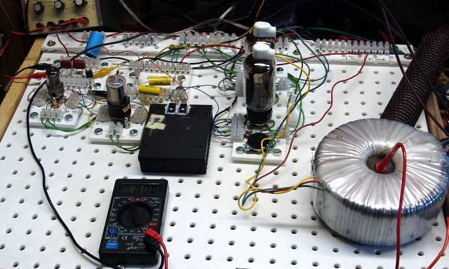

I haven't built a tube amp of this magnitude in about 10 years. The previous ones were guitar amps made with power transformers used for OPT's, and distortion was the norm. I have had a long time to dream up ways that I would do it better. I briefly experimented with screen drive a while ago, and decided that I would like to try it again, but had no plans to build anything for lack of an OPT. Then I read this thread, found out about the Plitron, and the snowball started rolling downhill. I will probably try out several different circuits, and maybe some different output tubes until I get what I want, and then the real building will start. In many respects Shawn has a head start, since he already knows what he wants.
At this point it is just an ugly breadboard. I have developed a solderless breadboarding system over the past few years that lets me turn ideas into reality rather quickly. I can usually turn a dream into an amp in a few hours. This one has been slowed down due to some head scratching caused by a bad scope probe and an open clip lead. I didn't have a "module" for 4 big sweep tubes either, so I am making a new one.
I enclosed a picture of the previous 80 watt screen drive amp on the breadboard. I have reconstructed it with a few changes. The driver is up and running making over 300 volts P-P. The output stage is still under construction.
I said that I would flip the switch today, and I did. The good news is that nothing blew up. I guess I wasn't thinking too much when I hooked it all up to my bench power supply. My power supply goes up to 555 volts, at 250 mA. Thats 138 watts. Somehow I was expecting it to power a 300 watt amp. Well it really doesn't like it! I pulled out 2 of the output tubes, and wired the 8 ohm load to the 4 ohm tap. I can do some "reduced power" testing this way.

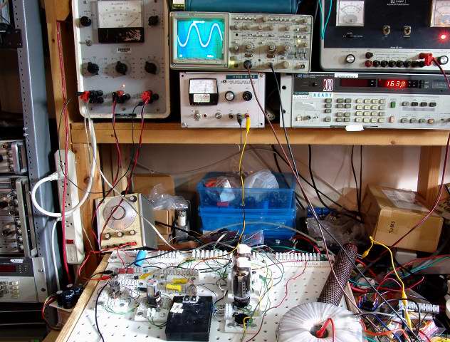

I ran some basic testing on the low powered version. My power supply breaks into some weird oscillation when I try to draw over 400mA. Turning the drive up to the edge of this effect yields 180 watts. The hottest thing on the bench is the 500 watt load resistor. I have been reminded by people much smarter than me that this is not a "non inductive load", but I am not connecting my new load box up to this arc welder, so some measurements may be off.
I ran a frequency response sweep at 150 watts. LF 3 db point is somewhere below 20 Hz. The power supply freaks out whenever I try to go there! HF 3 db point is 55 KHz. Response at 50 watts is 6Hz to 55 KHz. Ruler flat from 20 - 20. Not bad for a $134 transformer. There appeared to be some saturation effects below 25Hz, but this could be my power supply expressing its distaste for my experiments or DC imbalance. This transformer will probably do DC to daylight with your lower powered design.
I have discovered some DC imbalances in my non adjustable drive circuit, so I am modifying the circuit to make it more adjustable. Some crossover distortion is evident at low power, and hum shows up when the power supply drops out of regulation (over 100 watts). I guess that I am going to steal the Antek toroid from its happy home in a SE amp and make it work for a living. Not to sure when all this will happen, got to go see mom next weekend. Have to make a 2000 mile road trip right after that, but I will hit the Dayton Hamfest.
Picture of the test bench. Scope and audio analyzer across the output. Audio analyzer set to display "watts into 8 ohms". It reads 163.8. Current meter on power supply is buried.
