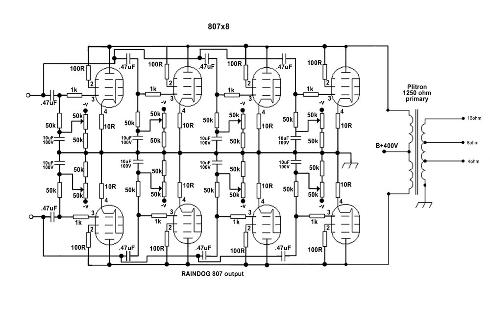

To drive 8 X 807 (or any tubes), consider a PowerDrive circuit with a seperate mosfet for each tube.
807 x Eight Output
I have revised a little bit more..I like it very much this way.
I think it will work fine and I sense you folks may think it is worth a twirl around the block. The big question; what will drive it?
The 100R's could be exchanged for 150R's or even better an inductor type.
The 47nF has been corrected to .47uF
The 680R is swapped with a 10R
50K bias R's and pot are still 50K's

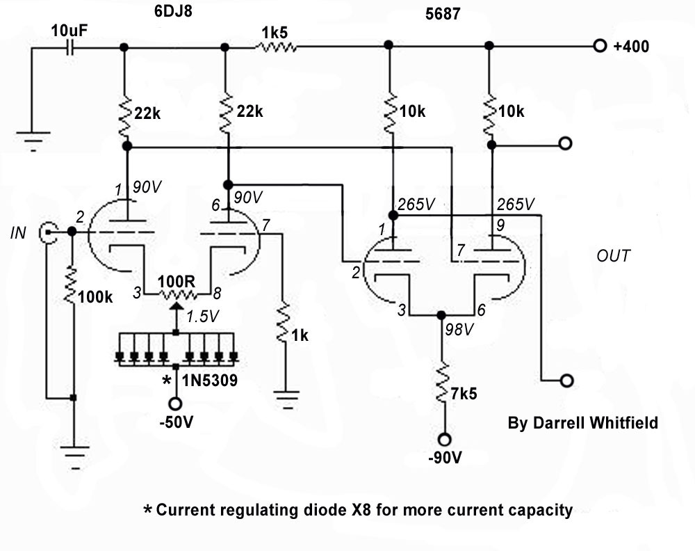

807 Pre by Darrell Whitfield
Folks,
I pulled this up on Photoshop and tried to draw it again so perhaps this time a better look see. I posted it already but it went by without notice or criticism. I would LOVE to hear your thoughts 'cause I though it was ingenious if not wacky?
Check this circuit out and tell me what you think. And don't forget to look at the tube data sheets before...!
Shawn.😉

still think you need a follower (either tube or mosfet) though.

agent.5 said:still think you need a follower (either tube or mosfet) though.
Your thoughts just like everyone else's are very important to me but I would like more detail. Show me the achilles heel that you see.
Shawn.

a little dual triode does not have enough current to drive the capacitance of the grids of 8 output tubes.

agent.5 said:a little dual triode does not have enough current to drive the capacitance of the grids of 8 output tubes.
The tubes can change. The support components can change. I like the simplicity of the "Whitfield" circuit the most. It may cause me some power supply grief but I would rather complicate the power supply a little vs. adding more stages that "may" not be required in the amplifier.
Thank you for taking the time to comment. I hope I'm not being too stubborn to you all. Most of you have light years of experience ahead of me. I feel honored to have this exchange with you all.
Shawn.
The Whitfield circuit has a cathode follower. I think it is in disguise...please study the schematic. Perhaps I am wrong?
Shawn.
Shawn.

TomWaits said:The Whitfield circuit has a cathode follower. I think it is in disguise...please study the schematic. Perhaps I am wrong?
Shawn.
not on the schematic posted on post#44, as the signal outs are taken from the plates. A cathode follower means that the signal outs are taken from the cathode.
On your earlier schematic, the diff amp performance is degraded by paralleling already-mediocre current sources. Use a single discrete CCS in that critical spot. And then you can lose the balance pot. Also, you'll probably need to connect a leak resistance between the two grids of the second diff amp.
SY said:On your earlier schematic, the diff amp performance is degraded by paralleling already-mediocre current sources. Use a single discrete CCS in that critical spot. And then you can lose the balance pot. Also, you'll probably need to connect a leak resistance between the two grids of the second diff amp.
Yes the current source on the 6DJ8 needs a true discrete CSS and the second stage with the 5687 remains a little wonky. Still I thought it was clever ramping the current up and using a greater power supply difference on the second stage to achieve a higher voltage swing.
I'll try to tweak it.
Shawn.

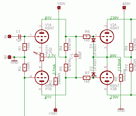

Hi SY
I still would keep the pot, because the 2nd stage is DC-coupled. The CCS only guarantees AC symmetry, but not DC symmetry.
Also, in such a setup - LTP followed by diff amp - really perfect AC symmetry by a true CCS is not strictly needed, since the diff amp will deal with slight non-symmetries easily, after all that is one reason diff amps are for.
For such setups, I feel that stabilized feed voltages for the 1st stage are much more important than a super-duper CCS.
Tom
(frontend extract of one of my amps attached)
Tom
