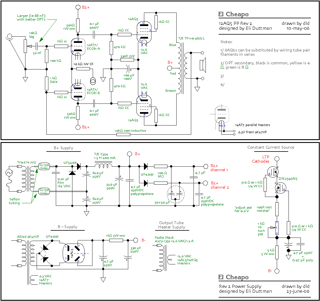

You can "lift" the cascoded MOSFET CCS from the "El Cheapo" schematic I've uploaded. McShane has all the parts needed for that "beast".
As SY stated, even the simplest CCS works well in the tail of a LTP. So, the popular IXYS 10M45S is a decent choice.
You can do much better than shown in the HF89 schematic, for a bias supply. Full wave bridge rectify the power trafo's discrete bias winding using 4X Schottky diodes and follow with a CRC filter. The 1 A./130 PIV rated Fairchild FMKA130 is well suited to the job. 100 WVDC caps. are fine in the bias supply filter. Caps. have a surge margin, while "sand" diodes fail if subjected to excessive voltage.
At a minimum, use a separate bias trim pot. in each channel. FWIW, I'd use combination bias, with a shared 100 Ω/470 μF. network under each PP pair's cathodes. Combination bias makes a single trim pot. in each channel work well and it also "eats" some of the potentially excessive Volts in the B+ rail. Please notice that using a 100 Ω cathode bias resistor makes setting the "idle" current very easy.

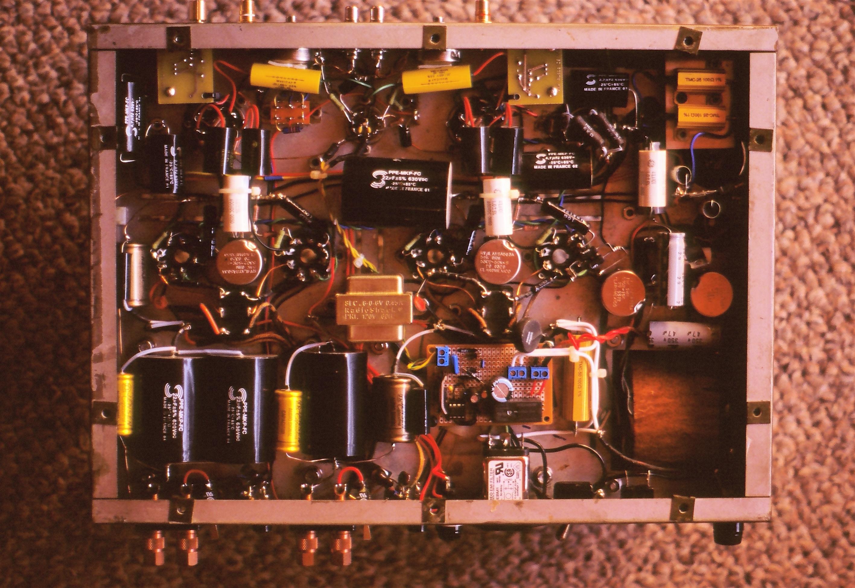

John - beautiful work. You've got a lot going on under the hood!

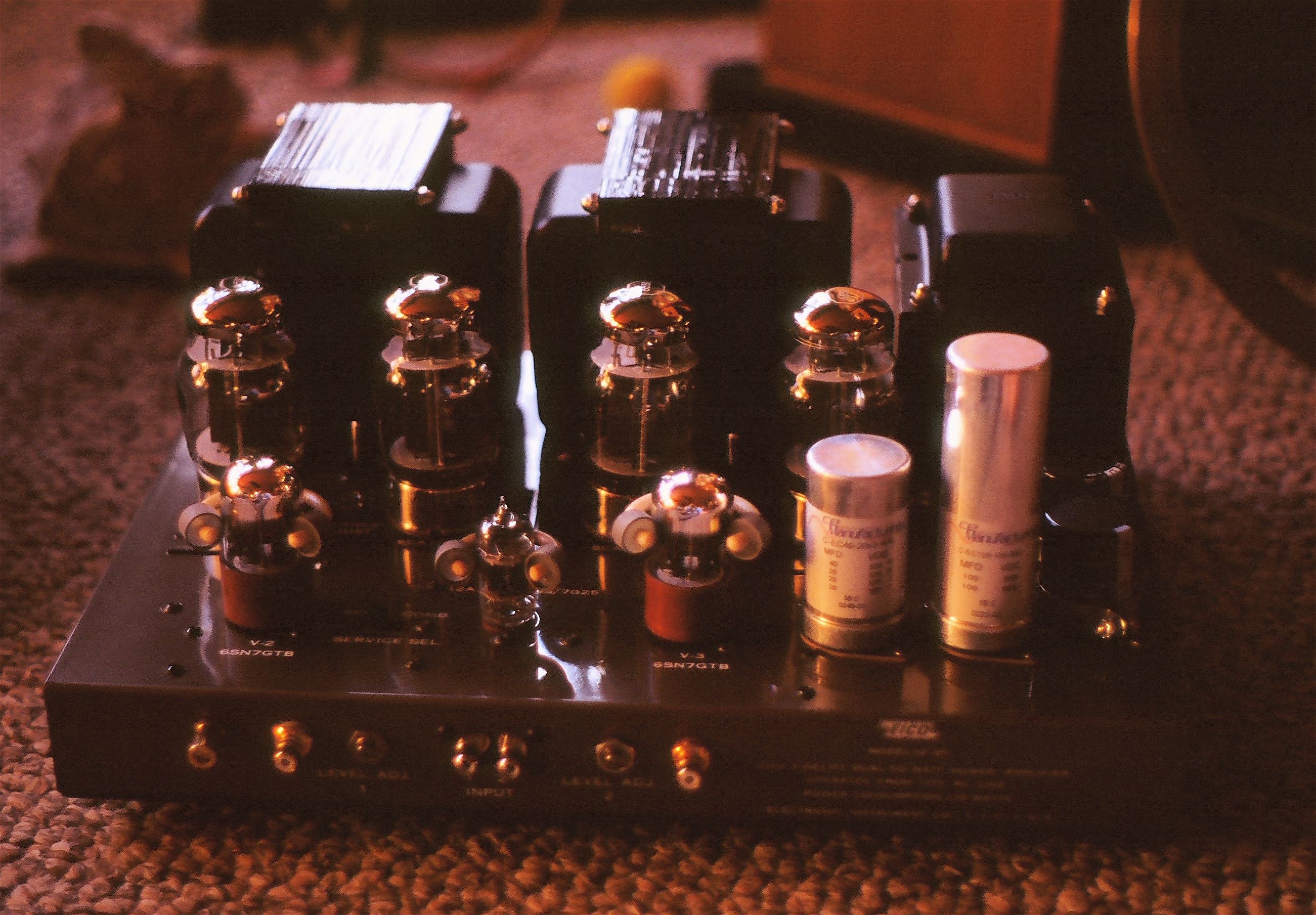

Do not use capacitors that are physically too large like in the HF-89 above.
Heh, heh. I did this rebuild years ago in my "bypass capacitor phase". Those large film caps are local B+ bypass caps. Probably would use Genteq 1uF film (the oval ones) for most of that now. The big 50uF Solens (two each in series) was an attempt to try for an Ultrapath connection with a fixed bias amp. Used a diode between them and the 100uF PS caps for isolation.
Things I wouldn't change: star grounding to replace the stock "chassis ground", separate RC strings for each channel after the PS doubling caps, CCS "tail" for the driver stage, triode/ultalinear switches, repurposed stereo/mono switch to enable reduced feedback with triode operation, and a more modern turn-on delay circuit.
That's all moot now anyway. I haven't used that amp in years for anything more than a doorstop.
The HF-89 cannot compete with my Class A fully differential triode PPP KT-120 transformer coupled mono-blocks using Lundahl amorphous iron in the signal path and Lundahl iron in the PS. CCS cathode "tail" impedance for all stages, including the output, and separate CCS fed active shunt regs. for the input and driver.
