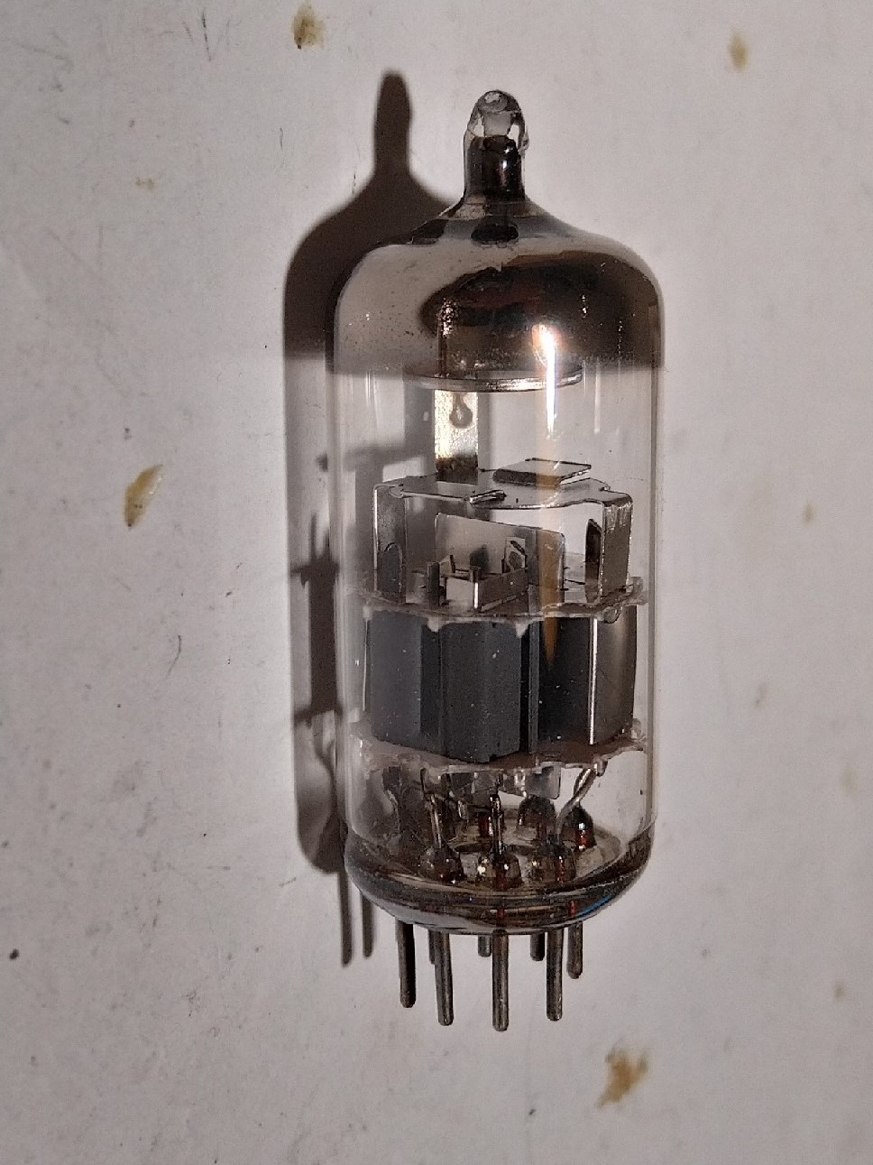

They are not the same tube and can not be swapped in the circuitry if made for one of this tube OR the other...but if the circuitry is dev from the beginning for that. The heater have not the same current cunsumption also.
The e88cc has not mica for instance if I am correct so is less quiet.
Look at the numbers you already know one support 220v the other 130V. Ok curves are close as I have said close brothers. But not the same.
6922 usa said equivalent is 150V so not the same exactly than e88cc...etc.

E88CC is not a good tube for audio (and not made for that iirc. ECC88 or E188CC are.
I have read Ei purchased old production machinery from Philips Holland and elswhere. As the machinery was old second hand and Ei produce indeed latelyy tubes with them, those tubes was not said to be very good and nowhere a true equivalent of the older made in Holland Germany and France with Philips machinery.
If a Philips made by a Philips factory, there should be a factory logo, like the Delta and so on, no ?
This looks like a rebadged tube perhaps....
it is rebrand. EI very popular when american and western european tube factories quit prodution but kept selling and rebranding. EI was independent not philips factory. they had some philips tooling--look at the glass.
EI they bought telefunken tooling and made their own smooth plate ecc83 on the very same tooling TF ulm made their ECC83 smooth plate.

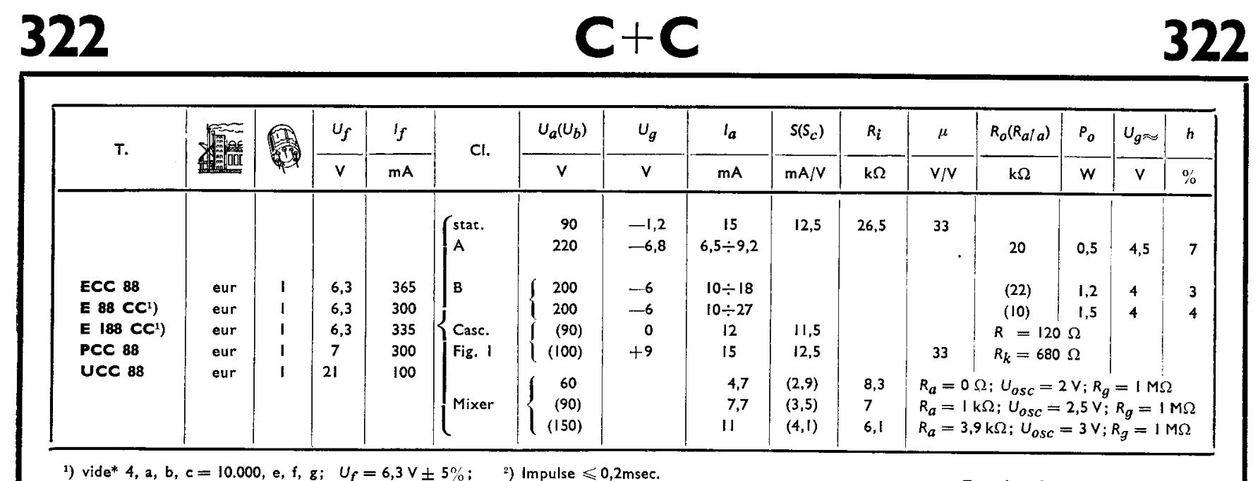

ECC88 and E88CC are different tubes.
For example E88CC datasheet define positive grid voltage curves, ECC88 not.
Curves are similar, but not exactly the same.
Substituting ECC88 with E88CC is possible (slightly different If), the opposite is depends of the design (mainly Ua).
p.s.
E88CC/6922 equivalent noise resistance is 240R, ECC88/6DJ8 has 300.

Unfortunately, I have to correct you again, I guess I know the history of my former country much better than you do.
In the same year that Ei started working there was a rift between Stalin and Tito and it is impossible that Ei received russian tools then, on the contrary the West then decided to sponsor Tito and that's why Philips partially entered Ei like many other Western companies that got partners in the former Yugoslavia. All tubes made in Ei are made on original Philips tools with their material even the boxes are made in Philips with the Ei logo.
This is the reason why tubes with western markings and manufacturers have always been used in Yugoslavia, just as Yugoslavia never fell behind the Iron Curtain.
As for the sound of Ei tubes, I'm sorry that you're disappointed, it seems to me that the better tubes ended up among collectors from the countries of the former Yugoslavia while the worse ones were sold on ebay and elsewhere. Sonically, they are no worse than Philips or Siemens, while some tubes are even better. It is known that the final control was somewhat worse, but I can easily find a pair among my samples if I need them as was the case with the Ei ECC88 that I used in WCF.
As for the E88CC, I'm not sure that Ei ever produced it, I've seen 6DJ8 Elites, but I've never seen an Ei E88CC.

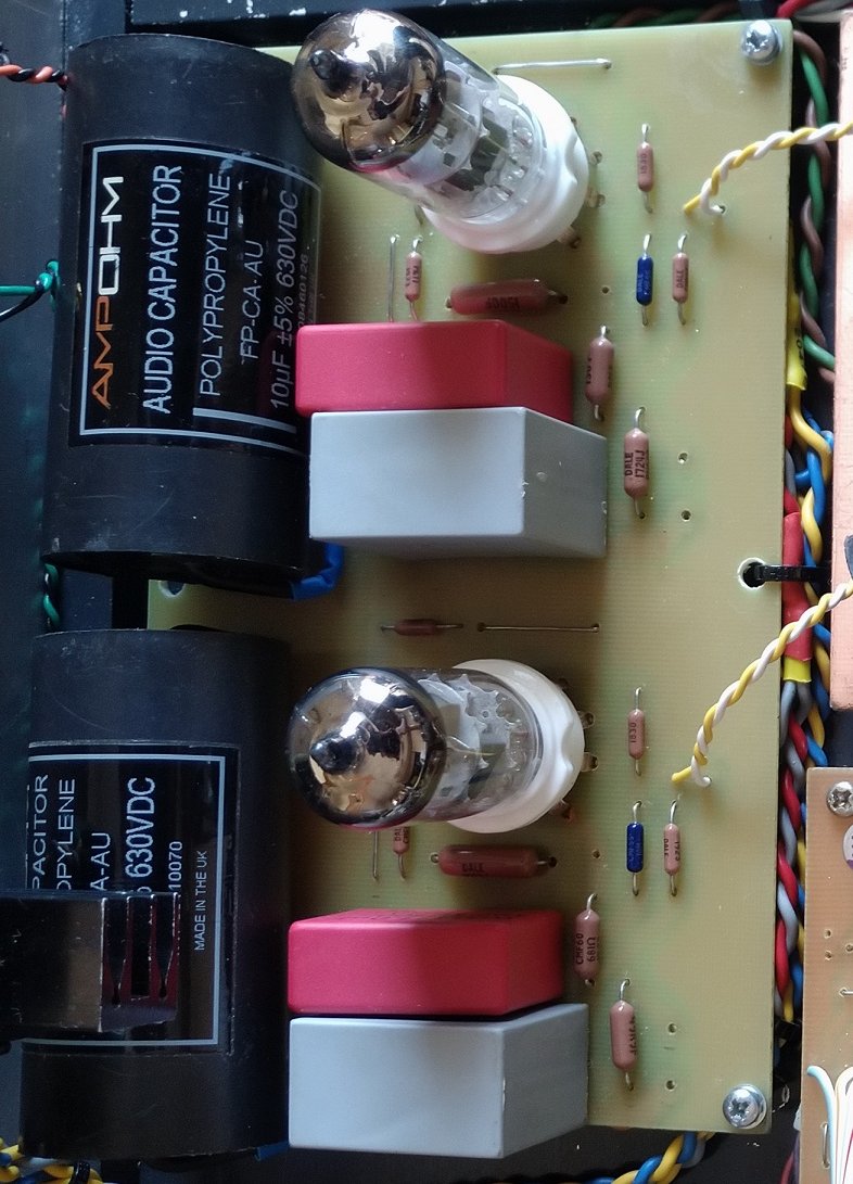

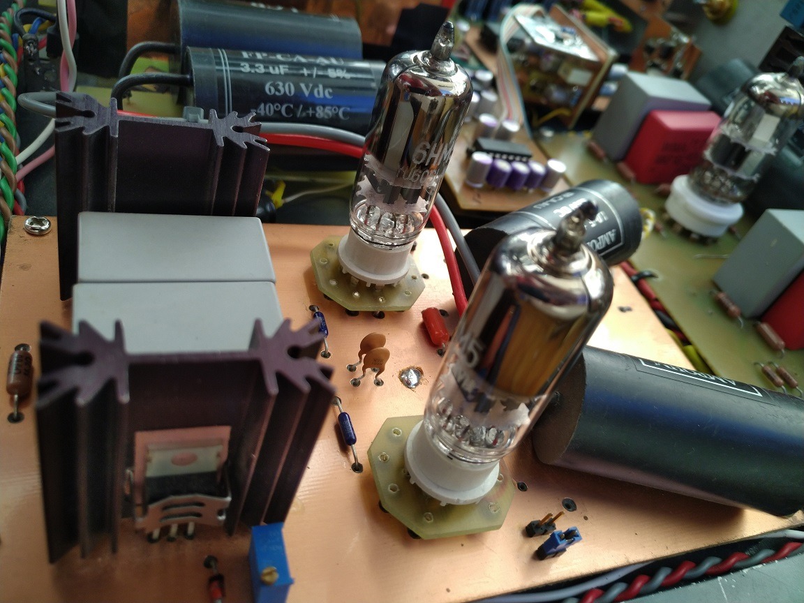

And I forgot, in the first picture are tube from which manufacturer?

The E88CC was not a super ECC88, audio/vhf/uhf wise at least. E88CC was just a less quiet ECC88 (so more noisy and microphonic) but SQ tube (10 000 h) for comutation pirpose and the dispersion between the two hal triodes is even worse than the ECC88. The super ECC88 for our purpose is the the E188CC (7308 named in US) ( quieter and long life, appaired 5% max from the plant).
Amperex made both ECC88 and 6DJ8 (american name of the licencied ECC88 invented by Philips)
Some company stamped Philips had no Philips tooling. And some Philips tooling were given to some company for the production to be continued like Ei (Yougoslavia) or Polam (Poland). (I transcript from a french Forum). There was not Philips tooling elswhere from Holland before 1958. Ei had Telefunken tools and only after Philips tooling (lately as far I have read from a guy that written several book about tubes). So some ECC88 were made with Telefunken tools under licence. And Siemens too, known as the worst(least quiet/ no mica, for economical reason), so with their own tooling).
So 6DJ8 equals not E88CC (6922) And Wikipedia is not Britanica or Universalis Encyclopedia. There are a lot of things on Wikipedia written by students not rulling their subject and writting false verity. Or at least the word "versions" is confusing. Well it is free, you got what you got.
Looks like it was Philips according to this short and sweet summary on Wikipedia.
Wikipedia isn't absolutely right here. I have some evidence (an article published in the German magazine FUNKSCHAU in early 1954) that E88CC was first in this row. TV manufacturers found out that this tube outperformed the PCC84 in terms of noise and amplification that has been used as the 1st Cascode amplifier in TV frontends until then. Anyway, the E88CC`s SQ property led to other issues in TV's, mostly in terms of warranty etc. So, tube manufacturers developed the PCC88 as a consumer tube with nearly the same performance. Next was ECC88.
