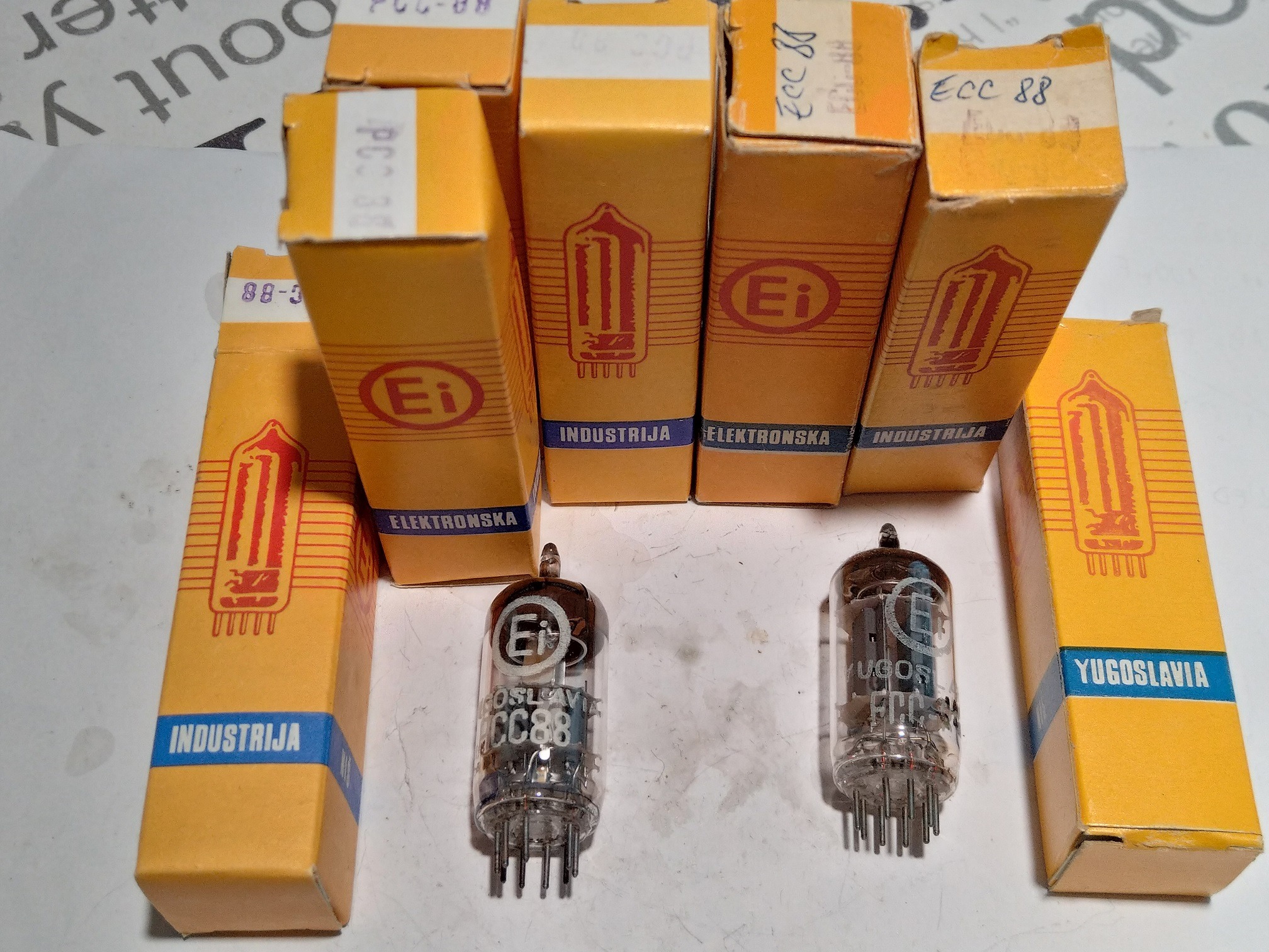

Does anyone have knowledge and experience with EI e88CC made in Yugoslavia? Do you like it compared to Siemens or telefunken sound ?
It is a bit confusing. You ask about EI and compare with Siemens and Telefunken, with a picture of a tube from Philips?
Where are the EI tubes from? What age? Maybe they are equivalent quality to the ones you are comparing them with since they were made in different factories to fulfill orders for the same companies in the old days.
This was a simple question. A tube with the name Philips was made by a ei factory..... and interestingly, I can't see the same with a ei box. Why? Isn't it sold under its own name? Have you seen this tube with the factory name? The main manufacturer? And about the sound comparison...if anyone has used this tube can they tell me how it compares to the tel or other....where is this confusing.

Are you getting this from the code on the glass? It does say 'Made in Holland'? So presumably it has been faked at some point? The two digit code for an E88CC is 7L, that looks like 5C (XY81)? I am still confused!
rebranded. not faked. tubes are identified by manufacture not brand.
buying from factories and selling under your own name is and has always been common practice.
most european tubes in use and in circulation have manufacturers codes etched one to the glass or stamped on tag or structure inside the bottle.
in this case the OP's phono removes any ambiguity whatsoever for those in the know.
Every tube factory that gave the tube to other for Rebrand... also gave the tube to the market under its own name. For example:Siemens gave e88cc t o .rca but we can by e88cc under the name Siemens .
Philips has given e80cc to the tel, but it is also in the market with philips name. But why .....ei e88cc .... is not in the market? Does anyone know ?
Perhaps Ei Yugoslavia did not produce SQ tubes. There might have been also a commercial agreement between Ei and Philips.
interesting. now that you mention it, ive only seen amperex NY and philips holland produce philips and amperex SQ and PQ.
but for miniwatt was used by philips for just about any european rebrand. but philips used miniwatt on many tubes, even those not otherwise branded philips.

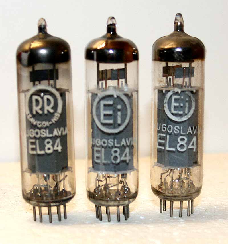

Ei was founded in 1948 and produced tubes under license from Philips with their materials and machines. The logo has varied over time, as can be seen in the picture EL84. They sound great, but they have the disadvantage of uneven characteristics so you need more of them to match.
