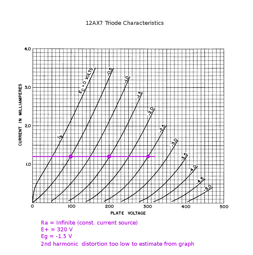

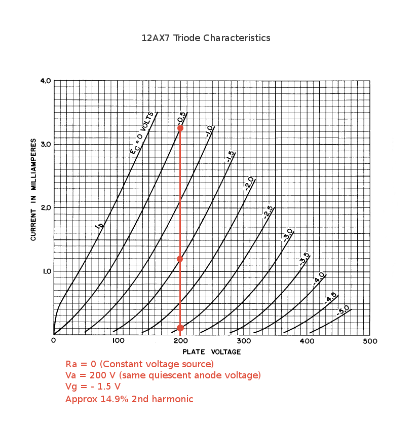

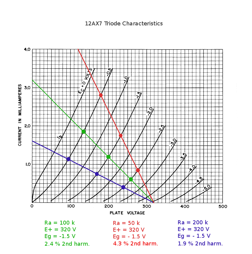

See the attached images I put together while thinking about this. The first image shows a range of plausible resistive anode loads for a 12AX7 stage; next are the extreme cases of near-infinite (CCS) and near-zero (cascode) loads.
Put together, they make a pretty convincing case, no? 🙂
Second-harmonic distortion estimates were made graphically, from the asymmetric lengths of the load line wrt the quiescent operating point (the three dots on each line).
