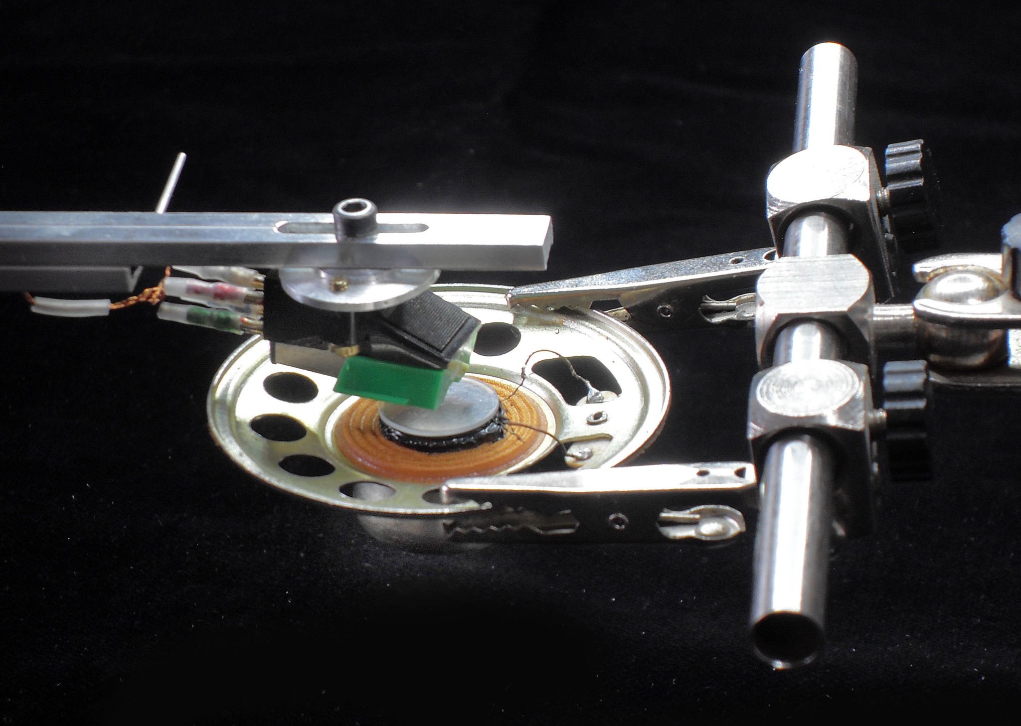

Some of this is above my pay grade, but I have calculated EM for several arms. IMO, the problem for most is that they didn't build the arm and therefore don't know the mass of the various parts. Often you can't take it apart to measure. To me, that suggests some different method than calculation is needed. One thought I've had is to use a small piezoelectric block, or maybe a small speaker, and excite the thing through a load cell. Force and frequency should get you the EM.

I think the speaker excitation method you posted was part of the discussion where Hakkaplan posted his static test. I’d forgotten that. I thought the dynamic test was a good approach, but because the static test is so much simpler and seems to work, I never followed up.
Carlo,
The dynamic test - applied to four or five equidistant spots across the Thales circle - might answer, or at least give a hint, about PLT effM.

That was quick. That’s what I thought was being suggested. Have you tried a signal through it yet?
Doug
Doug
yes - it was just an attempt to bypass the uncertainties of the signal on the test disk; so we got those of the loudspeaker in exchange.
Tried (also without the cartridge) for wand resonances not EM calc.
c
