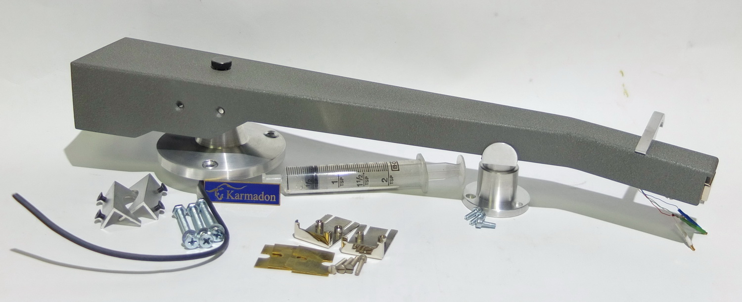

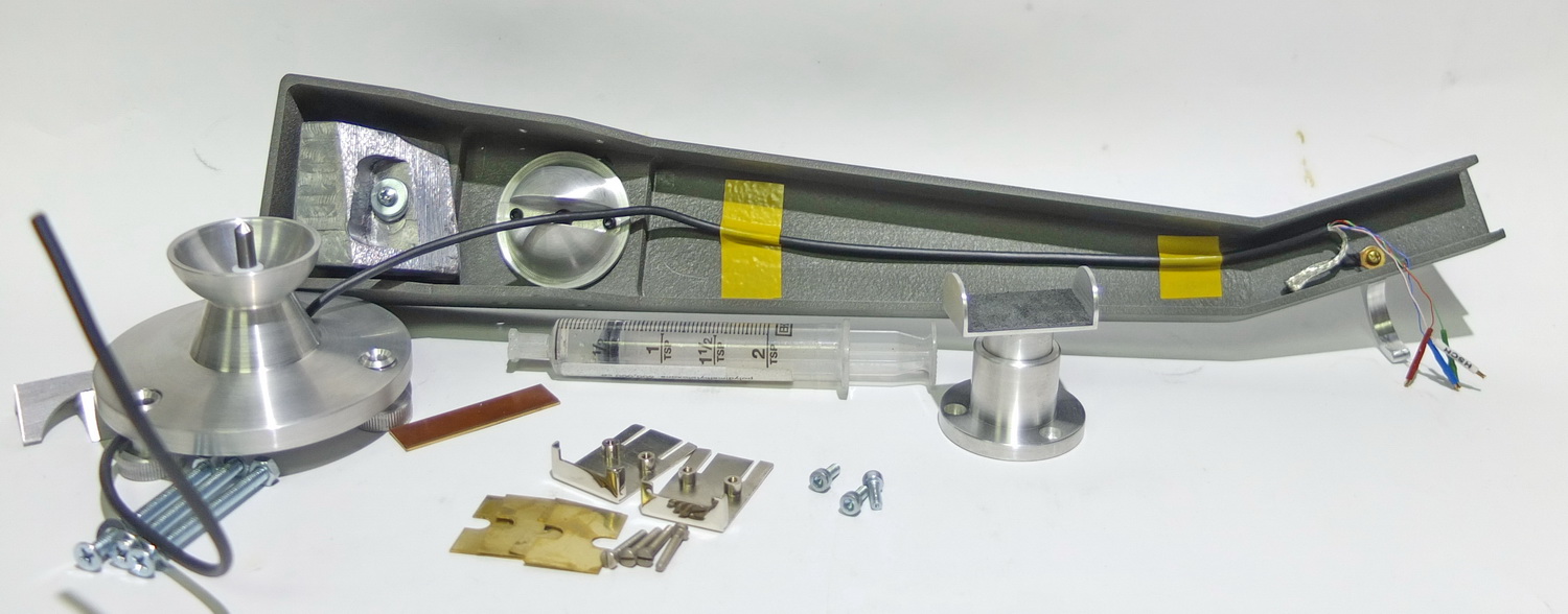

unipivot with secondary bearing
Just to let you know the Basis Vector and the Super-Arm tonearms are unipivot designs. But it has a secondary ball bearing wrap around the up-pointing spike (see pictures below or this video at 1:26 mark) and it requires the armwand housing to "lean" on one side to create a second contact to limit movements to horizontal and vertical so essentially it disqualifies it as a true UNI-pivot tonearm. The leaning force is done by using a counterweight with offset mass, the semi hollowed out area.
I dislike traditional unipivot for having infinite degrees of movement, especially azimuth rocking or instability. But hybrid designs allow creativity in the secondary bearing and the Basis Vector solves the issues of single-point bearing admirably. It retains the unipivot advantages of a loaded bearing, good mechanical grounding, low friction, simplicity but it eliminates azimuth rocking. Yes, the leaning force may generate an unintended horizontal force. The counterweight's hollowed part is on the left side so the potential extra lateral force will be swing to the right side which possibly creates an antiskating force that might actually benefits the design. The Vector belongs in the genre of unipivot with secondary bearing a la Graham Phantom, Continuum Cobra, Simon Yorke S7, SPJ Lyla, etc... If I am in the market for a unipivot arm, I would definitely look for something similar.
PS, what inspired Basis designer AJ Conti to design the Vector arm was his dissatisfaction with the Grapham Phantom. Many Basis turntables were furnished with Graham orignal tonearm but Conti did not like the newly introduced Phantom's use of magnet in "following", the phantom part, the movement of the main bearing housing. He believed magnetic force is compliant and he much prefer a more rigid secondary bearing, hence his invention of the Vector tonearm.
The secondary bearing concept for a unipivot was done way back in a Gray 102.

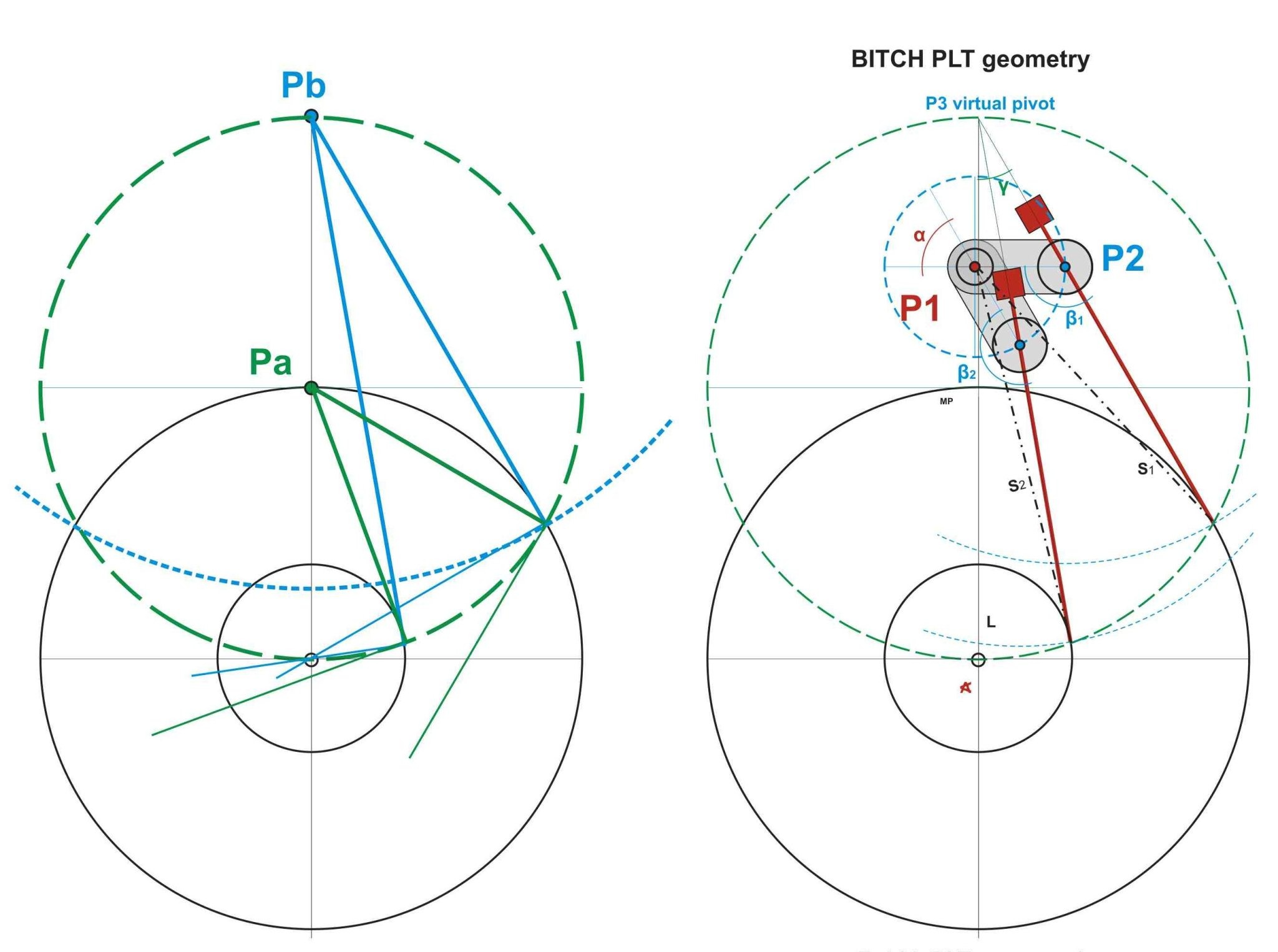

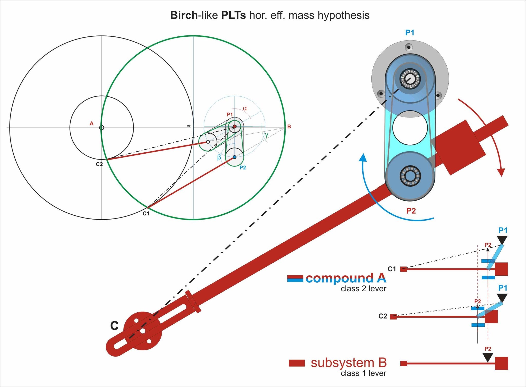

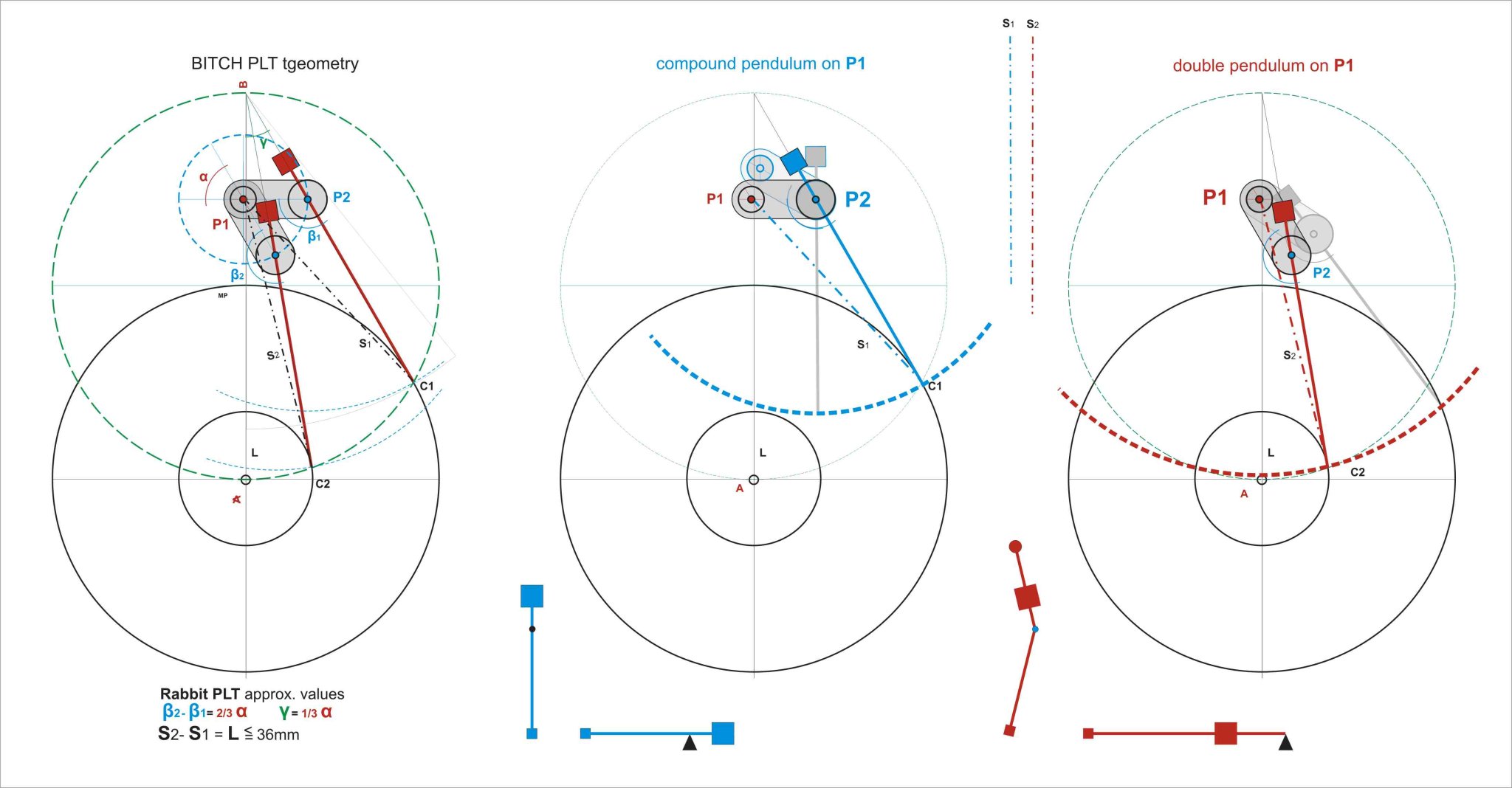

Hi friends, once i had posted (on angling for 90°) this hypothesis when trying to calculate the eff mass for my belted Birch TA, hoping for some qualified contribution
I realized that for the horizontal EM two different systems are combined, one of which is variable: something too complex to investigate, for me.
So before looking (rightly) for more precision, maybe it would be better to understand the system to which we intend to apply it -
c
PS in my ignorance I still don't understand why H and V EM should be different: I understand it's damn hard to make them the same, practically impossible on LTA and PLTA, but to do it deliberately...

Carlo, the movement of the tonearm is the superposition of two turning motions: once negative (CW) around the center of the Thales circle and once positive (CCW) around the stylus. You have to add the two effective masses calculated from the two movements.
Sorry, I have some difficulty understanding your reasoning, could you detail the calculating procedure or make a graph, please?
On my old graph I see A (a1st type lever?) as a compound pendulum on P2 pivot - which I could therefore calculate with the usual Pivoted TA formulas, if only it could be free to rotate on P2
Then I see B (a 2nd type lever?) as a double pendulum on P1+ P2 pivots, but again the rotation on P1 is not free, but in relation* to the rotation in P1, so I don't know where to start.
The H eff mass derives surely from the combination of the two: you talk about a sum, but I fear it is variable during tracing and far from linear. Not only the B value, but even the A/B ratio.
A PLT is a rigid set, but in which the various masses assume variable distances and mutual angles-
What a mess, at least for me - carlo

Hope this sketch could clarify a bit my previous confused words.
c
Ciao 2wice - even if i'm not up to that math, i know vaguely about Steiner, and was wondering how you could apply it to a PLT.
But looking better at your drawing I see something (... cart?..) very different from usual PLTs and very interesting, can you anticipate something?
c

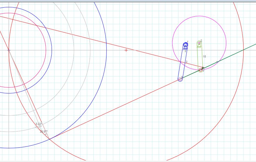

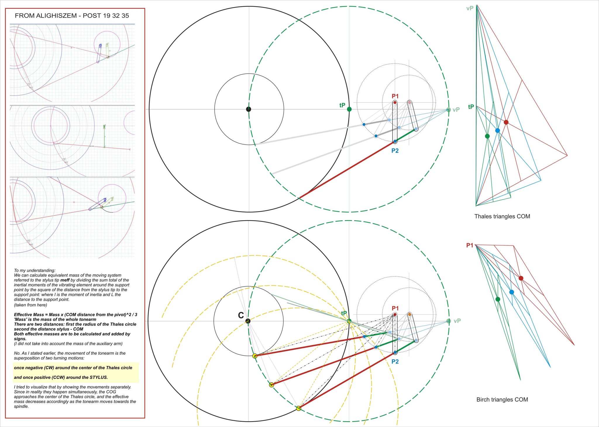

To my understanding:
We can calculate equivalent mass of the moving system referred to the stylus tip meff by dividing the sum total of the inertial moments of the vibrating element around the support point by the square of the distance from the stylus tip to the support point: where I is the moment of inertia and L the distance to the support point.
meff = Σ I ⁄ L²
(taken from here)
Effective Mass = Mass x (COM distance from the pivot)^2 / 3
'Mass' is the mass of the whole tonearm
There are two distances: first the radius of the Thales circle
second the distance stylus - COM
Both effective masses are to be calculated and added by signs.
(I did not take into account the mass of the auxiliary arm)

So, if I understand correctly, you suggest to calculate it with the method* we all use (even me) for common pivoted arms-
Unfortunately here I don't see any usual PT around: neither on the - green Pa- radius of the circle nor on the - blue Pb- leg of the Thales triangle; the single COM distances shoud be fixed and the pivot unique and free: conditions absent in a dual pivot Birch.
I only see still the very complex situation that I have tried to highlight in those drawings, Very difficult to calculate for me even empirically, and above all, variable during the arm stroke; just as the relationship between SF and SD that moves it.
Two considerations that weakened greatly my interest for PLTs
thanks for your interest - carlo
* the moments of inertia of the single elements are measured at the COM to Pivot distance, not COM to stylus, using the specific formulas for the different solids (cylinders, tubes etc.).

No. As I stated earlier, the movement of the tonearm is the superposition of two turning motions: once negative (CW) around the center of the Thales circle and once positive (CCW) around the STYLUS. I tried to visualize that by showing the movements separately. Since in reality they happen simultaneously, the COG approaches the center of the Thales circle, and the effective mass decreases accordingly as the tonearm moves towards the spindle.* the moments of inertia of the single elements are measured at the COM to Pivot distance, not COM to stylus, using the specific formulas for the different solids (cylinders, tubes etc.).

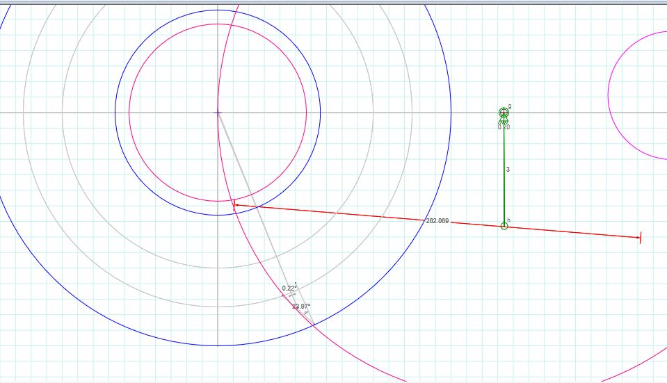

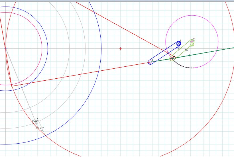

Hi Carlo,
Thank you for your patience.
The attached video will hopefully help you to understand what I meant.
The red auxiliary arm is moving the blue tonearm around the center of the Thales circle, and the gear moves the tonearm CCW around the stylus.
The result is the movement of any Birch tonearm.
