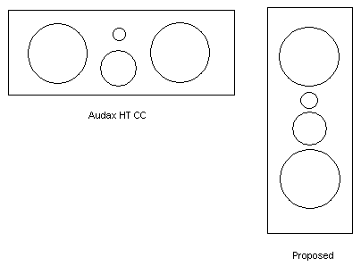

I considering building the Audax HT design CC as a FRONT PAIR. The why, you may ask is that the drivers are all on sale at PE and the CC seems to get rave reviews. So, regardless of the flames resulting from this proposition and questions of good sense, can someone humour me and answer this question:
If the drivers and baffle are reorientated as in the attached drawing into a WTMW alignment (the two W's stay in the same spot in the baffle and the baffle dimensions as well as all other box dimensions stay the same), does the speaker response change significantly (i.e. enough to require crossover redesign)? I'm not sure I know all the theory to answer this.
Thanks. Drivers are ordered.
I have a follow up question that is related. Since the speakers are to be fronts, I would ideally like to tune the box for more bass extension, yet I'm not ready to delve into a test & measurement rig.
If I reverse-model the response of the woofers in one of the modelling spreadsheets available, then play with the tuning of the box, but still maintaining the same sound level at the crossover point with the mid, can I expect to avoid any crossover mods at all (even padding adjustment)? Once again, the baffle would remain the same.

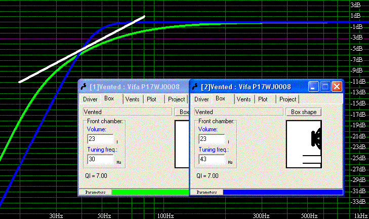

for an overdamped alignment
(assuming its near maximally flat)
simply use one port instead of two.
It will have no effect on the crossover.
The graph shows an example where two ports is the
flat response and one port is the overdamped case.
🙂 sreten

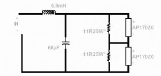

The woofer xover for the design is shown below.
It appears to me that the 2 woofers are padded down significantly to match the efficiency of the mid (87.4 dB for the mid vs 89.3 dB for the woofer, both 6 ohm impedance). I believe the calculation is 2 woofers in series = 92.3 dB efficiency, 12 ohm nominal impedance, and the 22 ohm parallel resistor cuts about 4 dB (I'm not sure how to calculate that).
Can I leave out 1 woofer and recalculate the padding resistor value and also expect minimal impact on sound?
The woofers are not padded at all in terms of voltage
sensitivity, the impedance is reduced by the resistors.
You could remove one driver and resistor and double
the value of the capacitor and halve the value of the
inductor.
Voltage sensitivity will be the same as the series pair.
Nominal power handling will be halved.
Impedance will be halved.
You'll also need to redesign the enclosure - half volume.
🙂 sreten.

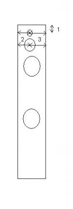

sounds fine to me.
But as a note MTWW is easier because this allows you to simply
add an angled internal section at the top as a midrange enclosure.
Offsetting the drivers (and mirror imaging) will also help matters.
I'd suggest ratio's of 1:2:3 of distances from the centre of the
top driver to the top and the two sides, vertically align the other
driver.
🙂 sreten.

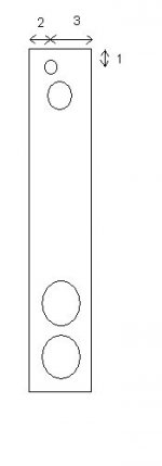

leadbelly said:
Thanks. Like this?
Yes for the tweeters, but mids directly below tweeter.
But I've got to say no for the bass unit placement.
(You'll get too much mid bass)
One driver should be directly below the mid unit.
The other midway between this and the floor.
This will give much smoother room gain and reduce floor dip.
which program did you use for that graphics in this topic???
WinISDbeta available as freeware. Save image as
bitmap and convert to a GIF using windows Paint.
🙂 sreten.
Like this?
