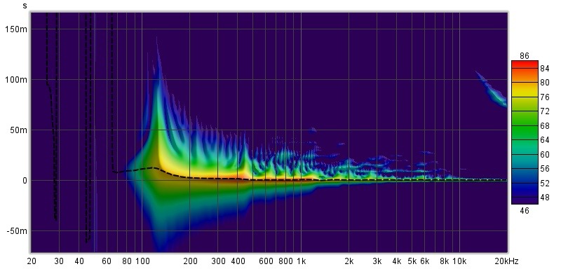

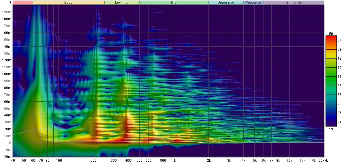

I've been playing around for some time trying to find the best way to mount (or not) my DML panels. Recently I've noticed that using the wavelet spectrogram in REW gives an interesting perspective. The wavelet spectrogram reveals some things about the time domain response that the regular frequency response does not. (Thanks @homeswinghome) In particular, it seems to be pretty good at identifying which frequencies continue to reverberate (i.e. ring) long after the signal has stopped.
Below are the wavelet spectrograms for the same plate mounted three different ways. The plate is a sandwich composite with carbon fiber/epoxy skins (0.25 mm) and balsa core (1.6 mm) that is approximately 406 mm x 584 mm.
In the first case, the panel was suspended from wires attached to the panel along the top of the long side, at about 130 mm from either end. This condition roughly approximates a free boundary condition.
In the second case the panel was mounted to a rigid wood frame using squares of a 3M double sided tape (about 12 x 12 mm) spaced about every 50-75 mm around the entire perimeter. This 3M tape is called 3M Indoor Mounting Tape and is about 1.5 mm thick with adhesive on both sides. I believe the foam substrate is a closed cell polyethylene. This foam is quite easy to compress, and rebounds quickly when you stop squeezing. This condition rougly approximates a simply supported boundary condition.
In the third case the panel was mounted to the same frame, but this time with continuous strips of EPDM rubber, about 10 mm thick and 20 mm wide. The strips ran nearly the length of all four sides with the exception of about 50-75 mm from each of the four corners. This foam is still soft (though not as soft as the 3M) and rebounds more slowly than the 3M tape. This condition also roughly approximates a simply supported boundary, but with a bit more constraint than the previous condition, and hence slightly higher natural frequencies.
Here are the REW wavelet spectrograms for each of the three mountings (1/6 Frequency resolution):
Wires
3M Indoor Foam
EPDM Foam
Note that with the "Wires" suspension, there are a large number of vertical lines in the spectrogram, indicating a large number of natural frequencies that continue resonating (ringing) long after the original signal. This I would consider not to be a good thing. Also note, however, that the SPL level of these resonances is relatively low in comparison to the initial signal.
With the 3M Indoor foam mounting, there are fewer long resonating frequencies. But wow, some of them (like at 200 and 400 Hz) ring with an SPL similar to the initial signal. Probably also not a good thing. Maybe even a worse thing than the Wires mounting.
On the other hand, with the EPDM continuous mounting, the only clearly resonating frequency is the fundamental. This, I believe, is a good thing. I feel pretty sure that the reason for the difference is the damping effect provided by the EPDM foam compared to the PE foam and the free edges.

Thank's for this new thread.
Do you have a ranking of those 3 panels from subjective tests?
The wires seems to have more long resonances
The 3M, less but strong resonances at for example 200 and 400Hz (red portion)
The EPDM seems more controlled. Too?
What might be interesting here is to get the experience of other wavelet spectrogram users and to make the relation with our auditory system. What is too long for the auditory system according to the frequency ?
By the way, I am pretty sure my panels have such behavior, probably not like the "wires" as I find them subjectively highly dynamic.
In the main DML thread, we should find one of my post where I open the hypothesis of a limitation in the bass for the DML linked to the decay time. See #6683

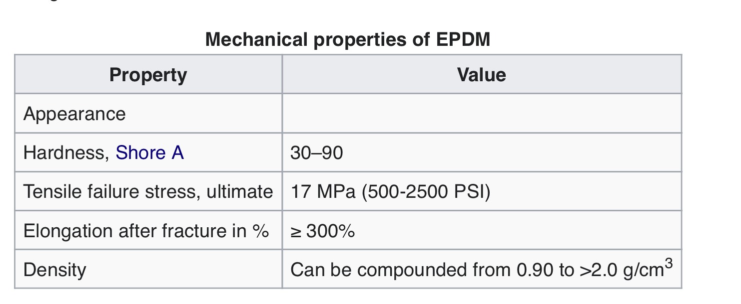

Note about EPDM from wikipedia, EPDM is made from ethylene, propylene, and a dienecomonomer that enables crosslinking via sulfur vulcanization and has functional rubbery properties only when crosslinked. Sulfur vulcanization is a chemical process for converting natural rubber or related polymers into materials of varying hardness, elasticity, and mechanical durability by heating them with sulfur[1] or sulfur-containing compounds.
It all means that there i a huge number of different ”EPDM” material to chose from, shore is one value to look for. I have tried two different variants weather sealing from tesa moll and and an epdm foam used for lining ponds. There is a difference in how soft they are tesamoll is softer. It is clearly less ringing with tesa moll.

Thomas,It all means that there i a huge number of different ”EPDM” material to chose from, shore is one value to look for. I have tried two different variants weather sealing from tesa moll and and an epdm foam used for lining ponds. There is a difference in how soft they are tesamoll is softer. It is clearly less ringing with tesa moll.

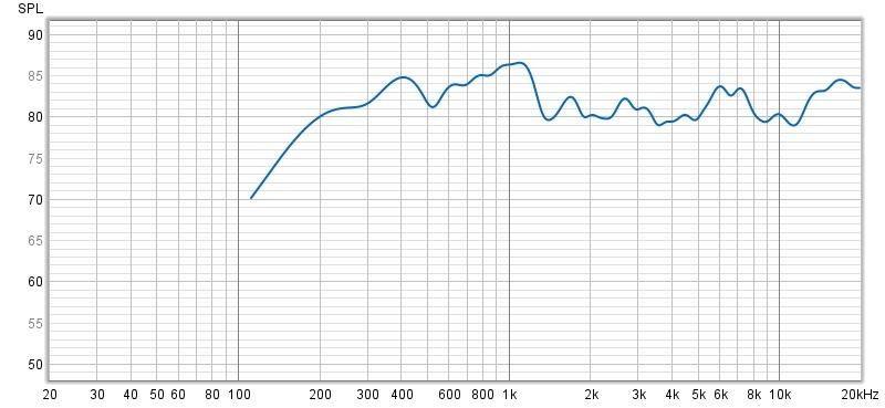

No doubt you are right that there are almost infinite variations of EPDM. I'll have to take a look at tesa moll for sure.
I don't understand your last sentence, can you explain a little more, even if it didn't work?
Eric

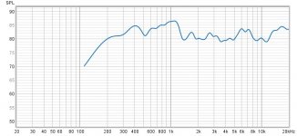

Thanks. Right, the 3M Indoor foam really rings. But don't count out 3M mounting tape products. I have also used a product call 3M Extreme (a mounting tape for exterior use), which seems to perform similarly to the EPDM (low ringing). Which is better (EPDM or 3M Extreme) seems to depend on the panel.Nice measurements and info! From what i recall from the bibliography, a damped boundary gives the most smooth bass response. With 1.5 mm width the 3M frame doesn't seem to be able to damp to much.
So, apparently, there is also this ringing advantage with such boundary conditions 🙂
Eric

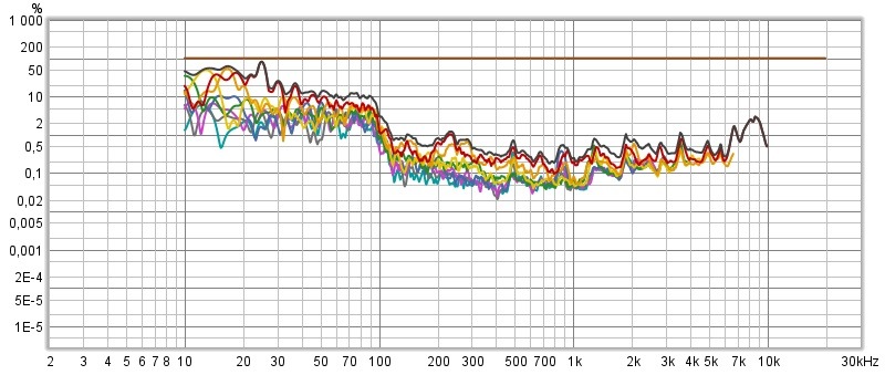

That looks really good. I'll have to try outdoor measurements some time. I can't seem to work up the motivation to lug it all out!Found some old measurements on my small speakers. Diaphragm is 2 mm balsa core with CF skins 0,15mm in total 2,3mm it's 190x250mm surrounded by EPDM foam "tesamoll weather seal". and mounted to a solid frame. The measurements are done outdoors.

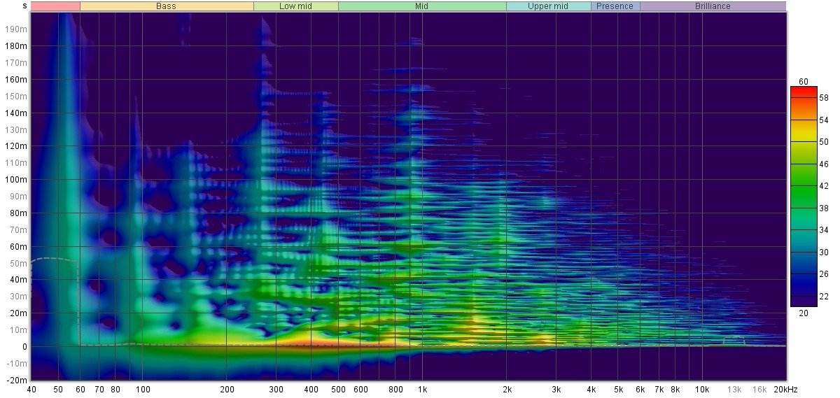

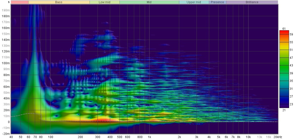

Tried the wavelet feature.
View attachment 1131893View attachment 1131894View attachment 1131906
Eric
