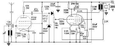

Scheme
This in the scheme, nothing extraordinary, is anything rong, do you have any sugestion for impruvement?

There are a couple of things you may want to try.
I think you need to put a low pass filter between the detector diode and the volume control, other wise the output stage is amplifying pulsating RF rather than just audio. Try 1 meg resistor and 1nF capacitor in parallel from diode to ground, then coupled to the top of the voulume control with a .01uF capacitor.
If you are in the mood for experimentation, you might want to try to put in an AVC circuit to keep the output level. To do this dont use the diode connected to ground, reverse the direction of the other diode, and add another low pass filter by connecting for example 33K resistor from the top of the volume control, to a 100pF capacitor going to ground. Connect the junction of the resistor and capacitor to the grid of the EF184. I dont know anything about the EF184, so I dont know if this will work, or it the R and C values are suitable, but it is something you could experiment with.

Hi Michael,
It's likely that the RF section will oscillate due to it's high gain and layout factors.
The selectivity (the bandwidth when tuned) will be very wide, causing several stations to be received at the same time. The bandwidth is defined entirely by the Q of the tuning circuit.
The circuit values look rather random, but something might happen!
Best have a look for some better RF circuit. Try a search for "Regenerative TRF"
