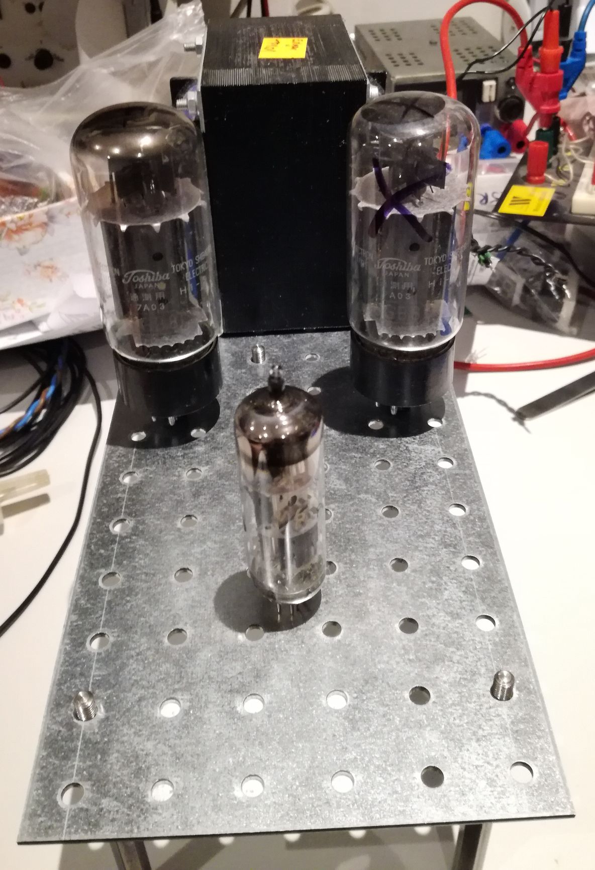

And, you also get the advantage that all the magnetic fields of each magnetic device is conducted to all the other magnetic devices. Hmmm, Buzz, squeal.
Exactly! That’s why I use mainly 4 mm thick aluminum and sometimes 3 mm thick for smaller pieces.
Regards, Gerrit
It's alive!
I finish 1 channel, measured 33W output power before limitation.
I used ECF82 instead 7199, set around 85V on anode and balance with trimmer on g2 of pentode (thanks for hint). Now I need do the same, but also with painting, for the 2nd channel. 😎
Just for information, this amp works well 2nd year now... without any problem, so I just recommend ECF82 replacement. Go for it 🙂
