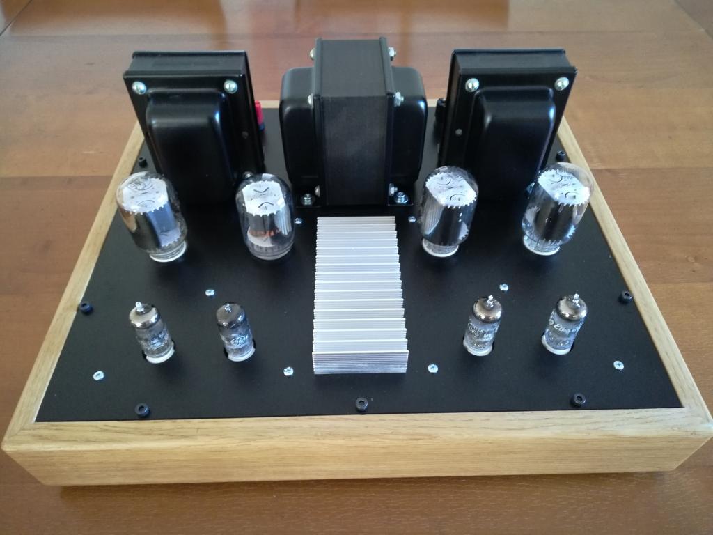

The Edcor are fine, but you need to really like their blue bells (or order the black ones if they offer the option). I hated their blue color so much I dismounted the bells and gave them to the paint shop. granted this is an affair of taste but when you invest so much blood and tears into an amp, you want it to look good. This one (Millett Engineer) went to my son.

Yeah, I was planning to ask for them to be painted black, or to paint them myself.
That's a nice looking Millett amp you gave to your son. I just finished building Pete's "NuHybrid" headphone amplifier, and after some tweaking it sounds pretty good.
I'm actually waiting for the transformers from Edcor to arrive for Pete's "Jonokuchi" headphone/speaker amp. I stuck with the classic blue Edcor transformers for that one, because I think they'll look good with the silver case from Front Panel Express. They're still 5-10 weeks away though, based on the initial lead time estimates from Edcor.

I did end up using the Toroidy brand transformers. I had done a few tests of the setup, but just with my bench speakers because I hadn’t built a chassis yet. But as of today, my amp is complete. It sounds absolutely marvelous with my restored Bozak Rhapsody speakers.
Here is a picture of the amp. The chassis is made of laser cut cherry-veneered MDF.
I’m very happy with the sound. Thanks to everyone in the thread for the assistance and encouragement.
