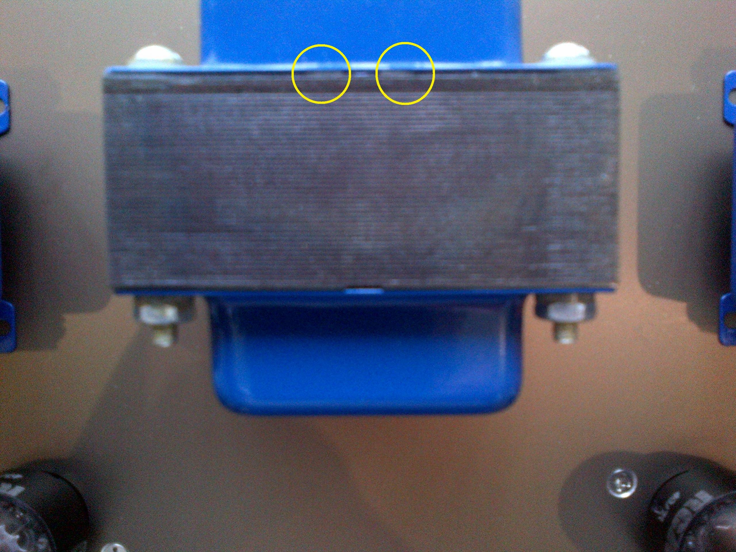

Had a bit more "fun" with the transformer overnight...
I re-wired it for 120V input and used the variac to see how the hum levels were.
Interesting that under load it still hummed at 50Hz operation, not quite as loud, but still annoying.
So, I took off the bell covers, opened it up and found that it is very solidly constructed, nothing loose whatsoever. I had some spare thick insulating pad left over from another project (similar to the rubber pads which sit between a toroidal transformer and the chassis - but made of a black foam with an adhesive on one side). I put some under the core of the transformer, between the chassis and transformer. Then I also put three pieces on each of the inside sections of the bell cover.
Sealed it shut tight again, re-wired it back for 240v and hey presto the buzzing has been reduced by about 50%. It's tolerable now. I have no idea about the heat tolerance of the foam adhesive I've use to dampen the sound....but it will have to do!
Thanks again for all the help - and a word of warning, it's probably best to get transformers custom made for your local frequency requirements!

By way of an update - I've received this response from Edcor:
"The photo show a peace of steel call a keeper. That is correct. The transformers that we have at 120V are 60Hz. Our 240V transformers run at 50Hz. Yes, a 120V 60Hz. transformer could hum at 50Hz. because the flux is so high. I am sorry, it is very hard to keep up with all voltages and frequencies of counties.
Thank you"

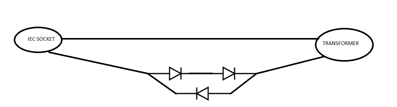

Certainly can try that - how will it stop the buzz?
Is the diagram I have attached correct & what are the best diodes to use?
Thank you"
we knew this all along, in my traffo builds i now use 260+ volts as design reference for traffos that will run at 240 volts....
Wire two diodes in series and a third across the first two going the other way. Place this in series with the AC line feeding the transformer. See how that affects the buzz.
Ok I tested it this evening, seems to have reduced the buzz a little. How does it do this? Is it simply dropping the voltage a little, or also blocking DC in some way?
At least the hum is at tolerable levels now!
It is providing a DC offset around .6 volts to cancel a bit of what is on the line. The next thing to try is three or four diodes each way and a 1000 uF 16 volt bipolar capacitor across the diodes. You can actually use just about any value of capacitor above a few hundred uF and if you don't have a bipolar a pair of normal ones also in parallel back to back.
