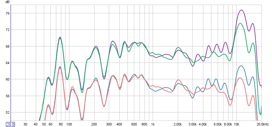

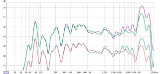

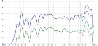

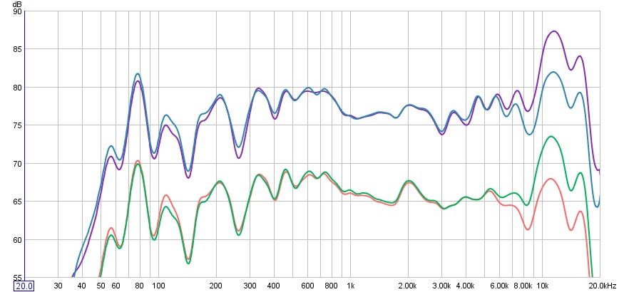

This is my testing of two ECM8000's.
Magnepan MG10.1, test amp, M-Audio MobilePre. 1m distance, roughly 2/3m height. Non-gated, 1/3 Octave smoothing.
The image below shows the vertical orientation mic 1 versus 2, the lower traces are the horizontal mic 1 versus 2.
My conclusions are that the two mics are pretty good up to 2kHz or so.
You can see an obvious deviation.
As for horizontal versus vertical, there's a clear difference, although not too much.
In my case, I am trying to design a notch filter / crossover for the top octaves, so 4dB separation is a really big deal.
I'm going to try some measurements near-field on a BG Neo3PDR to see if the trends continue.

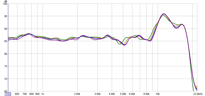

More data!
Semi-nearfield (14 to 16", 3' off the floor), MG10.1. 4 sweep average per position, 4 random positions. I would take one measurement and then move the stand in no particular direction about an inch. This was to see what effect positional variance had on the overall response.
Also, I ran baseline nearfield tests and got similar results, except you could see the phase cancellation. Moving back helped smooth this out. I did, though test my cable and ran tests with reference channel of both the sound card and the amplifier. All overlayed perfectly, meaning my amp or the mic cable I made is not causing any major errors. I tested the cable by literally holding the MobilePre onto the back of the mic during the test. I'm glad the cable wasn't at fault for anything because I really prefer to be seated during all the tests
Anyway, back to the results. First chart is the four sweeps at different positions for the horizontal mic.
Some variance with position, but overall you can see the important trends.
Small peak at 4500Hz, Dip at 6800 Hz, Big peak at 12000 Hz and then finally rolling off steep at 18000 Hz. Remarkably flat up to almost 4k!

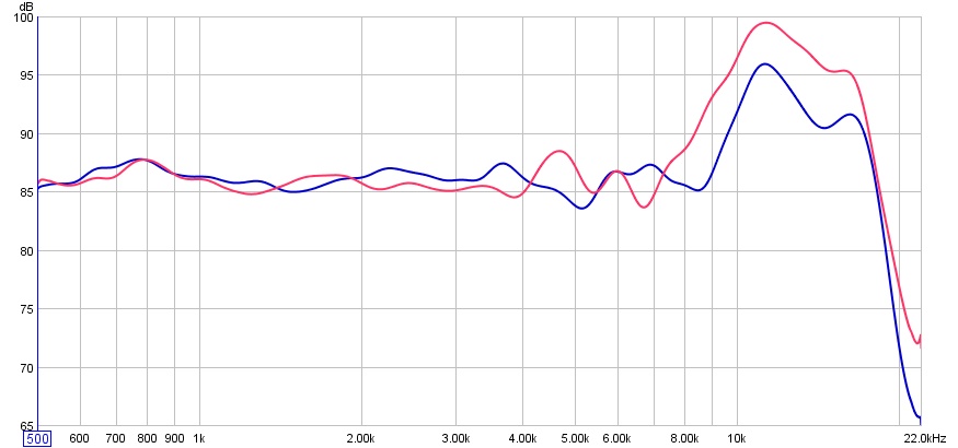

Here's the same test, but with the mic vertical. Again, four random positions all less than an inch apart. 4 sweep average for noise reduction.
Again, flat to 4kHz, a small plateau up at 6k to 7k, big hump at 12k-13k, and then the final roll-off at 18k or so.
Overall, in the vertical orientation the mic seems to have a flatter response to 7k with a much less pronounced peak.

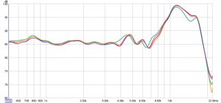

Finally, a representative sample from each overlayed for comparison.
Up to 4k, identical, or close enough for home-testing. But clearly the hump is of different magnitude and bandwidth when the mic is horizontal (red is horizontal, blue is vertical)
Neither of these is even close to any "standard" cal file I've seen floating out there.
D'Appolito talks about this in p54 of "Testing Loudspeakers". He predicts the "hump" in the response, but also mentions that true free-field mics control the resonance and damping to achieve a flatter response.
Obviously whatever is in my mic isn't working
I made cal files for my mic using these measurements. Granted, it makes a big assumption that my Magnepan's are flat from 1k on up -- but as a worst case, I'll be designing any speakers I build to their FR -- not exactly a bad target response
Eventually I'll spring for a thorough calibration but for now, I think this will work.

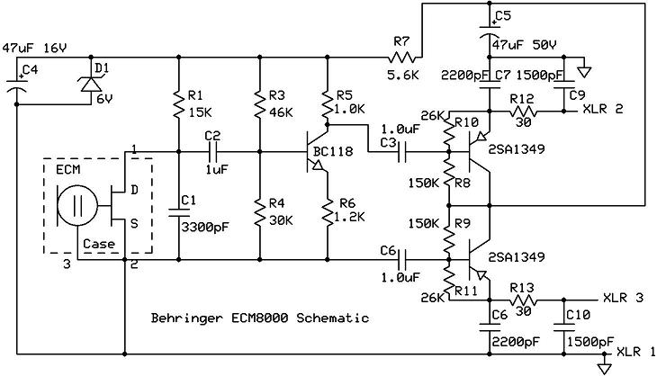

I found this schematic online. I don't know about the op-amp / transistor setup there to say if the voltage would affect anything.
But that's a lot of junk in there for a capsule that is supposed to just need 9V and some signal leads.
Maybe someone else here can chime in on what those sections do. It looks like a filter/compensation network, but I'm better with passive LCR circuits, not semiconductors.
That's a simple circuit! The two PNP transistors provide a current-source feed to the Zener diode (D1) from the phantom ppower common-mode dc feed on the XLR connector.

I wasn't quite sure how you meant that "simple circuit" comment so I'll clarify
The posted circuit looks needlessly complicated.
Similar DIY mics using the same capsules usually consist of a capsule, battery, and signal leads. -- That's the simple circuit!
So I was wondering what all the extra junk in there is for.
Also, does the 16V on that capacitor/zener section in the top left corner mean that it has 16V through it, or that it has to be rated for 16V, or maybe 16V is the zener trigger voltage? I don't know, that's why I'm asking.

Arc2v. The complication is due to providing a balanced output when phantom-powered. A non-balanced output mic is a trivial circuit, but this ECM8000 one isn't exactly complicated. It is only a single transistor gain stage with an emitter-follower after it. The (balanced) emitter follower is also the current limiter for the Zener diode dc feed.
