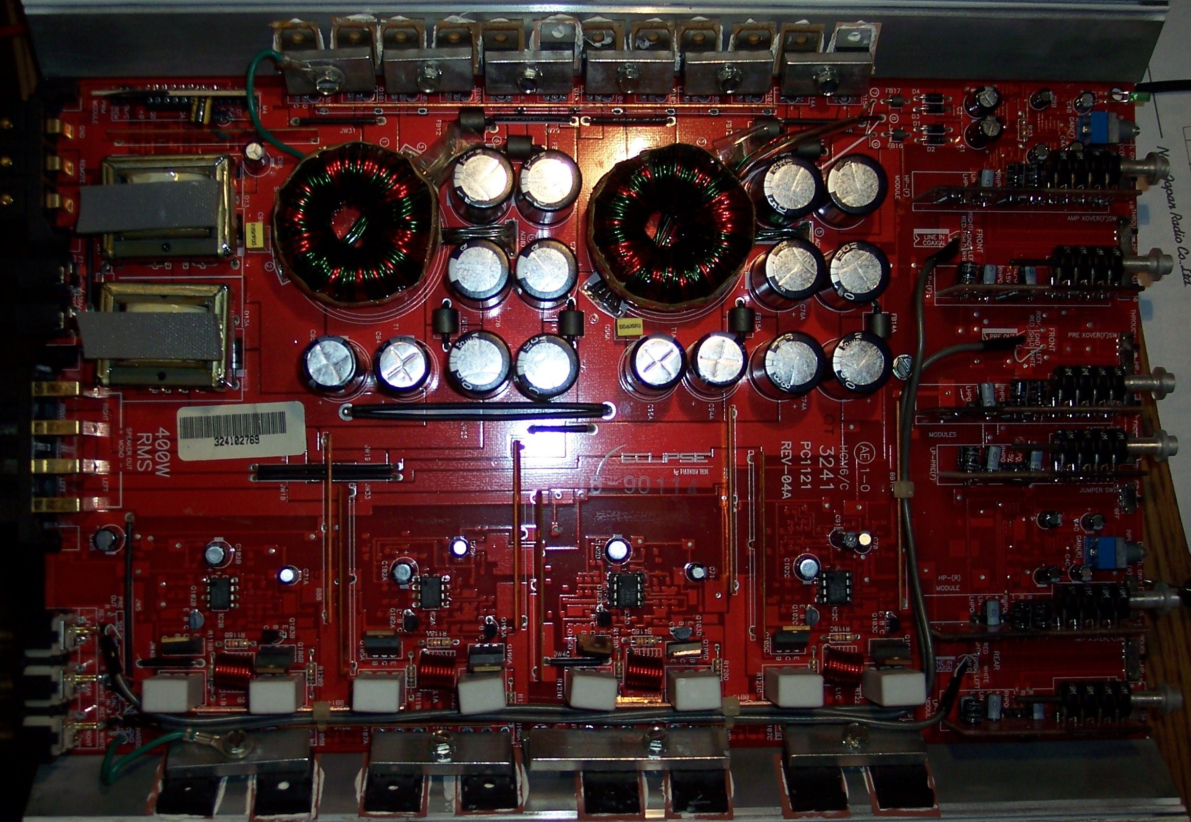

I have been reading the forums here to see if I can resolve my problem with out assistance, but I have to ask for some professional help.
When I got this amp I started by checking for shorted FETS, rectifiers, outputs, drivers and pre-drivers since a prior posting for this very model seemed to point that direction. What I found was one pair of TIP35C & TIP36C shorted on one channel. Once I found those I pulled the drivers, pre-drivers, and emmitter resistors for the blown channel off the board to check them out of the circuit but found them all to be ok. I remounted the components I removed and installed a new pair of outputs. I checked for continuity from the center of the coils to the input shields and to the non-bridging outputs and that is good. With nothing else glaring I powered it up with 5 amp fuse and a 3ohm resistor in-line with the B+.
This amp has DC on the outputs measured without signal cables & speakers attached as follows
RR -25.280VDC
LR 25.320VDC
LF -25.280VDC
RF 25.320VDC
It draws almost 2 amps at start up but settles down to 1.012A. I noticed that the power LED starts off bright like its good to go, but dims after it settles down to the 1A draw but it is not blowing fuses. This amp does not have a diagnostic set of LEDs unless the dimming of the one is just that.
I tested for audio output using an 8 ohm resistor in parallel with an 8 ohm speaker. The LR & RR have a very tiny audible signal that you have to put your ear up to the speaker to hear with the gain at maximum sensitivty and the volume all the way up on the source. The RF & LF have nothing. I fear that there is something wrong with the surface mounted components on this one.
This amp uses the 318D but I don't know what the expected signals should be on each pin.
Sorry for the long post, I am new here.
Rich

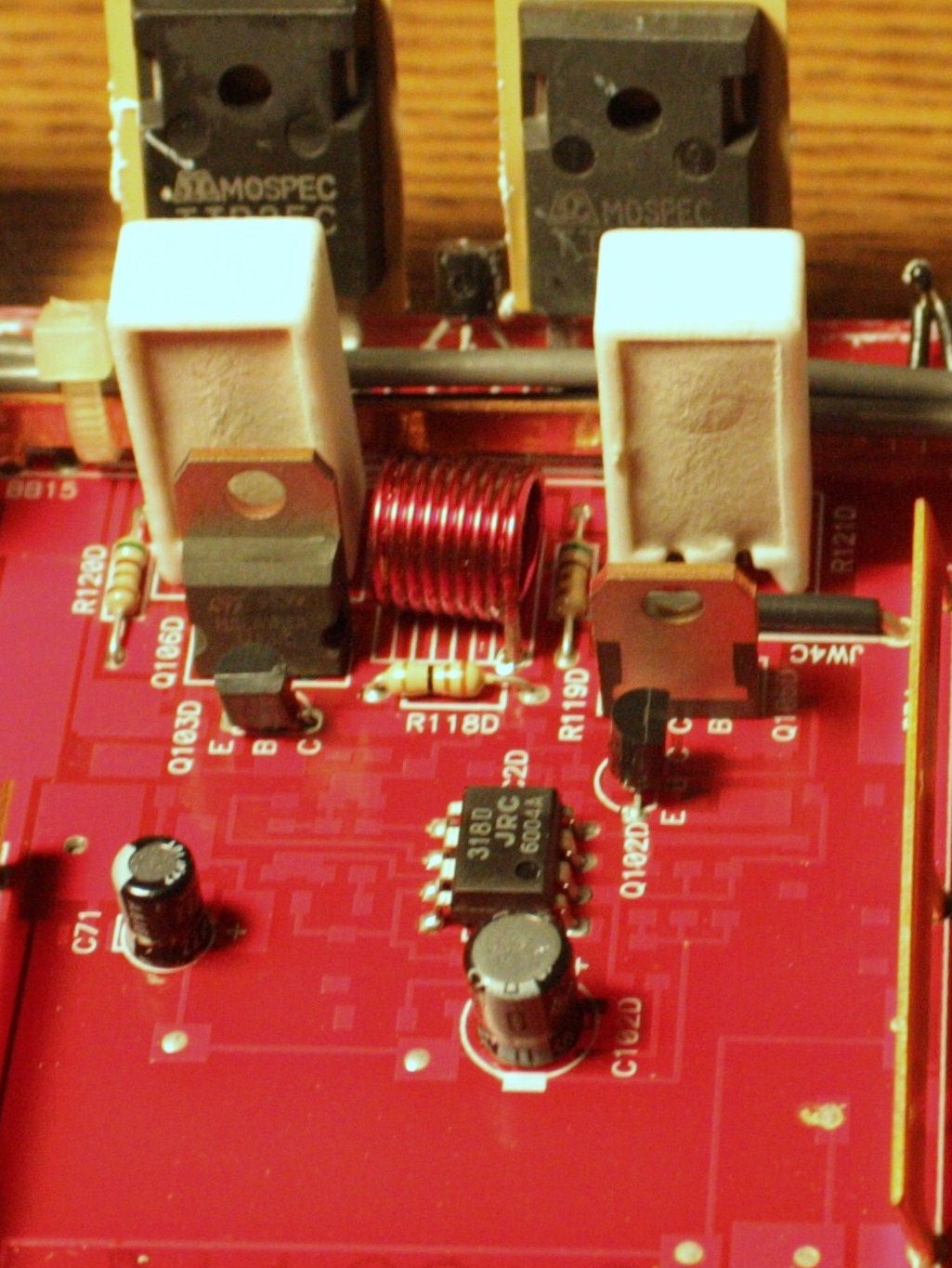

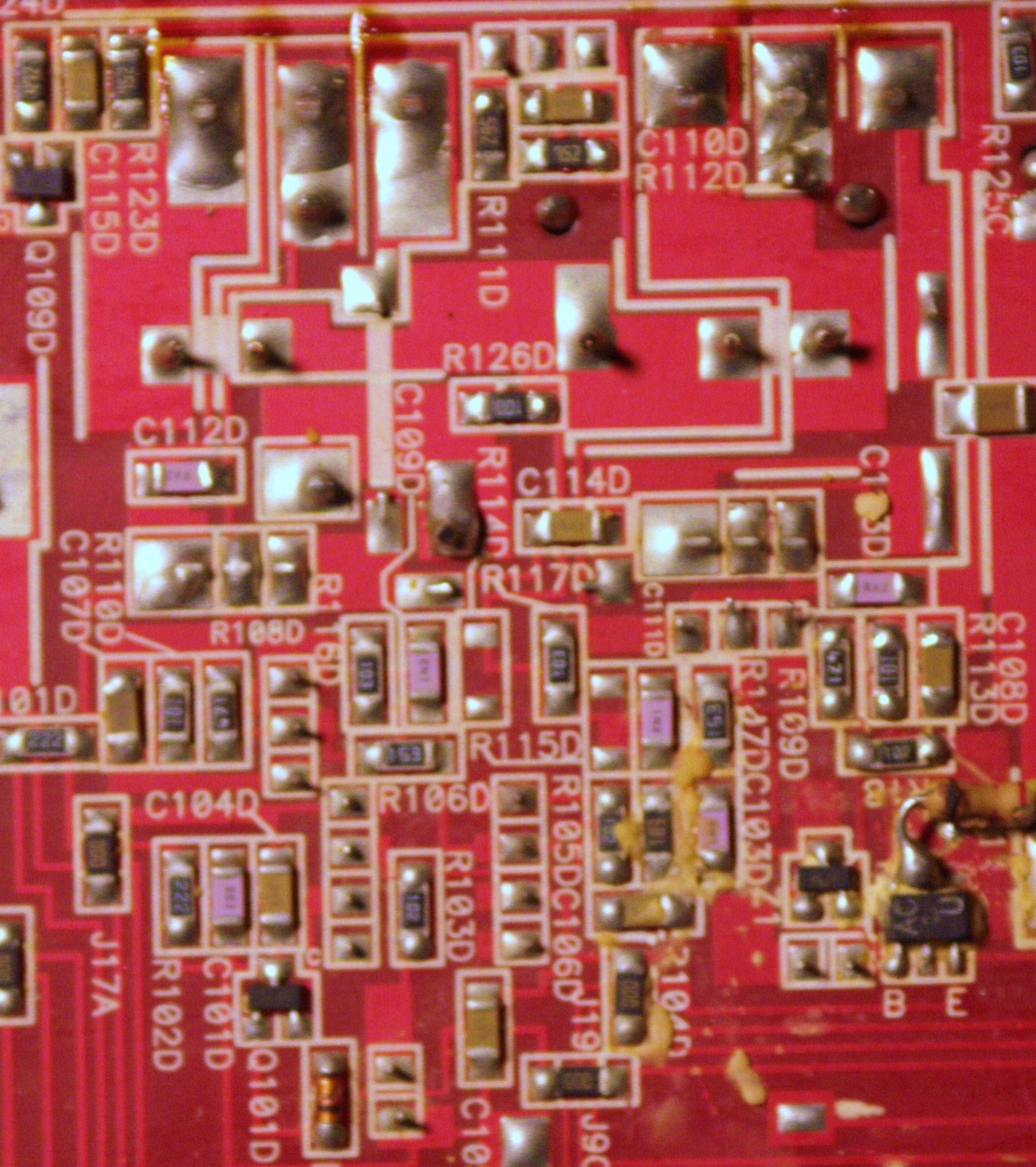

These were taken just before replacing the shorted outputs. The two pictures may not be of the same top and bottom circuit. The original pictures are too large to upload so these are cropped down.
I am giving up on this amp. I followed both the V- and V+ for all four of the op amps and could only find one area that measures suspect. Q115C and R19C measure low ohms but that doesn't explain to me why none of the four channels work. I did not find opens or shorts in those paths on the other three. Plus I don't have the proper tools to replace surface mount components, so I would just destroy this further.
