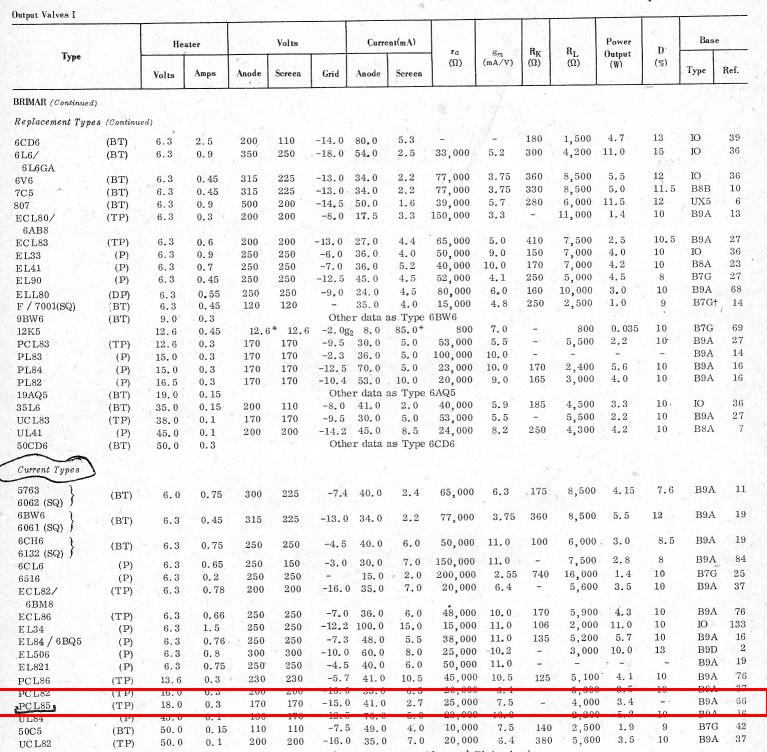

Futher background: This should be a small but good sounding amp to drive high efficiency open baffle speakers and headphones. Kind of a reference to compare with larger SE designs that are yet to come.
And I have ideas to use this amp as a driver stage for a larger triode (e.g. KT88 and larger). Kind of modulair concept.
These OT impedances are not that different as with ECL86. My OPT's are probably 7k so I think it is worth trying it. I run them on 300V/30mA...
Just calculated in my spreadsheet.
For an ECL85 @ 7k you would probably want a Va-c (anode-cathode) of around 250V running around 32mA for perfect center bias.
This will give around 3.8W output power.
Grid bias voltage will be around 29.5V, so you need around 280V B+

Ra ~ 7 kOhm is too much for the ECL85 / PCL85 pentode junction in SE-ClassA, and a transformer with a lower primary impedance would be much better suited as stated in the manufacturer's data (Brimar).
