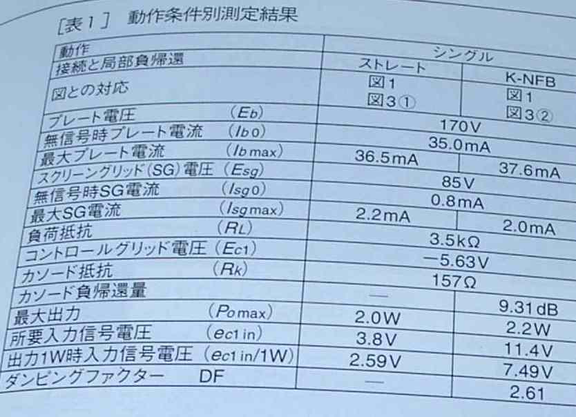

ECL85/6GV8-XCL85/9GV8-LCL85/10GV8-PCL85/18GV8 is a very good tube for audio amplifiers, very linear, with lower internal resistance and with lower supply voltages uses an output transformer of lower primary impedance (read: cheaper!) than the tube ECL86 / 6GW8-PCL86 / 14GW8, which is much cheaper and lighter to procure.
The improved ECL805 / PCL805 variant, which has an increased maximum platee dissipation (especially from TELEFUNKEN) of Pa = 11W, is even better, but it is also increasingly difficult to find.
The attached data refer to SE-class-A with the cathode feedback of the output tube connected to the 16 Ohm secondary terminal.

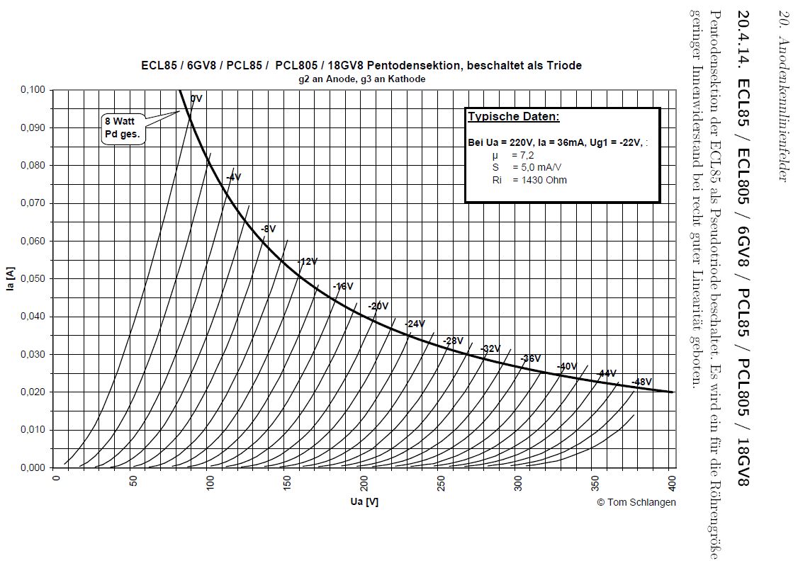

Hi Jeroen,
ECL85 / 6GV8 /PCL85 / PCL805 / 18GV8 pentode section strapped as triode can make a very nice and compact 5 Watt push pull amp. The rather lowish plate resistance helps with even rather "cheap" iron. Using decent iron, I prefer it to triode strapped PP using E/PCL86 any day.
I built several amps with that tube.
Kind regards, Tom Schlangen
EDIT: Uh, you were asking about SET, not tridoded PP. Anyway, my plate curves should be of help

If you want to run the ECL85 power pentode at 250 V plate voltage and 36 mA plate current, you can try a 7kohms OT. If you've got a ECL805 and run it at 250 V and 42 mA, hence 10.5 watts plate dissipation, the OT needs to transform to 6 kohms as a rule of thumb.

These OT impedances are not that different as with ECL86. My OPT's are probably 7k so I think it is worth trying it. I run them on 300V/30mA...If you want to run the ECL85 power pentode at 250 V plate voltage and 36 mA plate current, you can try a 7kohms OT. If you've got a ECL805 and run it at 250 V and 42 mA, hence 10.5 watts plate dissipation, the OT needs to transform to 6 kohms as a rule of thumb.
