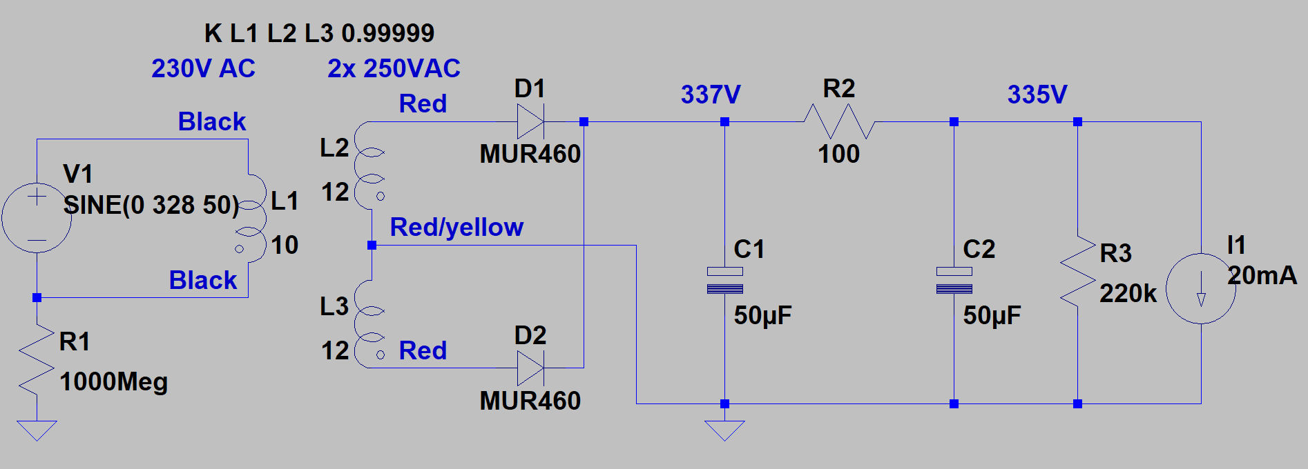

With this parameters (250V-0-205V AC, 20mA load) the output HV voltage would be about 335V.
