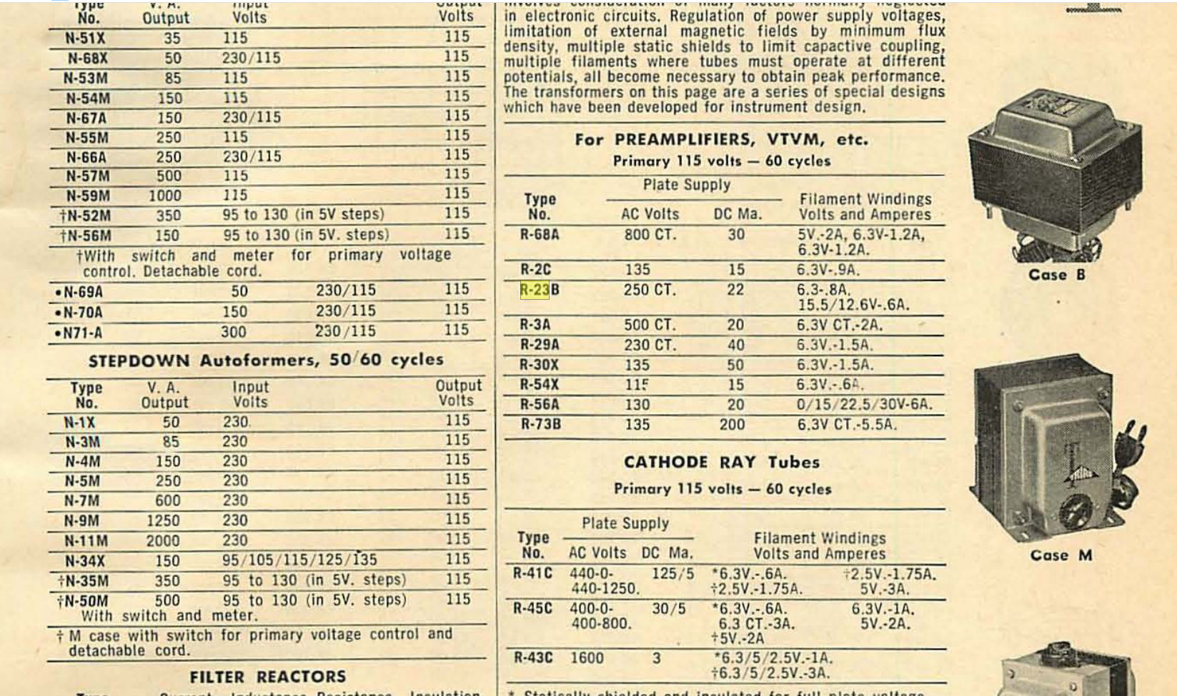

BTW you wrote, that have Triad R-23B transformer.
It's a 115V primary, 250V CT 22mA, 6.3V 0.8A and 12.6V 0.6A transformer.
Is this in this amplifier?
I work repair low voltage equipment professionally. I don't often work with AC, alothough I have studied it (and know how not to die). This is mt first AC PSU and it is with a Triad transformer from 1968. I have a tendancy to more advanced first projects, as opposed to easy ones.
I fixed the transformer section which was borrowed from another scheamatic.
Look at the schematic again.
250V CT 22mA
Rather seems like 250-0-250 (500V CT)
Is the high voltage winding's center tap connected to anything?
UPD: BTW, 1N4001s, being rated at 50V, are not appropiate for this application. Use something rated at 1000V or more (1N4007 or whatever).
"Rather seems like 250-0-250 (500V CT)"
250CT in Triad datasheet.
"Is the high voltage winding's center tap connected to anything? "
Red/yellow wire.
