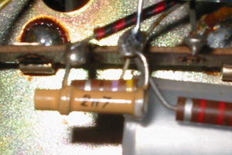

The colours of the feedback resistor (in pararel with the 2n7 condenser) are: Yellow/Purple/Black/Silver (47 ohm in theory) I have measured it and I read 135 Ohm at the meter . Strange
¿Isn't it?.
I can't find the grid leak resistor... Maybe I have spend too many hours this weekend with it and my eyes can not concentrate anymore. I think I better leave it for today

Not really..You can't measure resistance with a cap across it.
Un solder the cap at one end and measure again.
Cheers,😉
Strange ¿Isn't it?.
Cheers,😉

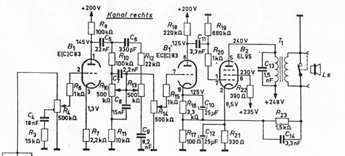

I have tried a NFB resistor of 10K and the gain rises a lot, but the tone is not as "clear" as with the 47 Ohm resistor (the high frequencies don't have "presence"). So now It looks fine with 120 Ohm.
I measure 250 V at the plates of the p.p. pentodes, 127 V at the second triode, 40V at the plate of the first triode.....
I still haven't received the Morgan Jones book, so I don't know how to calculate the optimum bias, re-disign it to run in Class A... 😀 😀 ¿what's wrong with Amazon.com? It takes too long
I've already replaced the 22K caps with Ruby 100K.
When you have tried the feedback resistor of 10k did you also change the value of the capacitor in parallel with it ? That would explain the absence of presence at higher frequency's.
Don't forget the dominant pole (3k3+470p) when you lower the feedback. It will rob the uppers 😉
As Sjef says, you will have to change the 2n7 also. Try removing it while you experiment with the feedback. Or at least keep the product of the resistor and capacitor constant.
Cheers,😉
No!!!...why not?
Is perfectly possible to measure a resistence with a ceramic cap across it!!😉
In the schematic of Manuel Guerrero amplifier he have not designed the connection to ground of the output transformer secundary...so when he mesure the feedback resistance he mesure the feedback resistor in parallel with the 180 Ohms resistor (via ground).
Not surprisingly it find 135 Ohms...the 180 in parallel with 470 Ohms, the feedback resistor!!🙂
Yellow.purple.brown.silver..😉

pingfloid said:40V at the plate of the first triode.....![]()
Hi
40 Volts is too low!...Have you used a high impedance voltimeter?
If yes the 100 uF capacitor in paralel with R1- 2,2K must be leaking...change the capacitor!
And check also if R1 and R3 are out of specs.

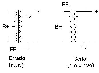

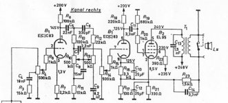

Horrible experiment
I have rewired one channel the Majestic ECL82 pp amp according to this schematic:
http://www.bonavolta.ch/hobby/en/audio/ecl82_3.htm
The result is awful: it begins to oscilate and motorboat like a mad thing. 😡
If I remove the nfb resistor the oscilation stops, but the sound is very bad.
I've triple-checked all the conections, and because I have the Rainer Zur Linde's book, I have followed all the indications.
¿What do you think that can be wrong? ¿Any other test that I can do appart of remofving the nfb resistor?

positive feedback
My guess is that you're applying positive feedback.
To solve: invert the secondary of the OPT, i.e. the (-) end you applied to ground must be positive (the one on which you will connect the FB resistor). The (+) end, on which you're attaching the FB resistor now, must go to groundlevel.
I hope my explanation doesn't confund you more.
Maybe a picture says more.
My picture is wrong, showing a PP trafo. However, the secondary connections apply to SE to. So, don't look at the primary, just the secondary.
Yes, that's it! Thank youy very much!
I did keep the original connection for the primary, but in this new design it has to be reversed.
The sound is much better than the original schematic. (I can compare since I did modify only one channel) so now I will update both channels with the Zur Linde's design.
No more worries about the 47 Ohm resistor at the feedback of the original design 🙄
Cheers! 🙂
