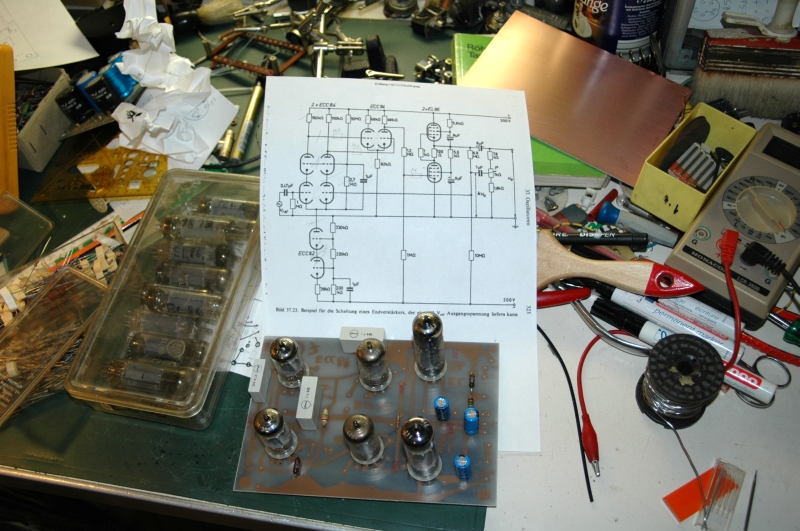

I'm currently playing with it, I bought ten of them cheaply on Ebay. It seems to be just fine for audio, with nice characteristics at lowish voltage. Only one thing should be kept in mind: there's a screen between the sections, which is connected to the grid of the section 1. This is intended to be used as a grounded-grid section, as the upper tube in a cascode. For audio, I do not expect any problems with this though.

I'm currently using 40V for B+ at 1.5mA in cathode follower configuration. From the datasheet, the operation region is not so linear but the sound is quite acceptable. Can you share your implementation?

I'm trying it in a differential amplifier with CCS anode loads. For it to become linear, it needs a bit more current. This goes for many RF tubes. My target operating point is 80V and 6 mA per section.

For common cathode/ diff pair, the miller effect will amplify the parasitic capacitance difference between both triode. The mismatch will become worse with higher gain. No effect in audio?
Nothing that cannot be compensated relatively easily should there be a real need for it. The capacitance at the inverting input should be compensated for anyhow in the feedback network, with that in place I don't see a problem in the capacitance mismatch, as the tube's impedance is rather low at its nominal operating point.
