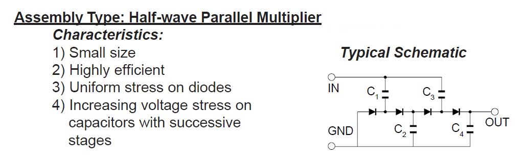

A voltage multiplier is definitely preferable. A 3 stage 1/2 wave parallel setup will yield approx. 200 VDC. A 200 VDC B+ rail is enough for a 12AU7/ECC82 section cathode follower (buffer). The big question is whether or not the 48 VRMS winding has sufficient current capability. If the RMS current capability of that winding is 6X the DC draw of 2X cathode followers, you are good to go.

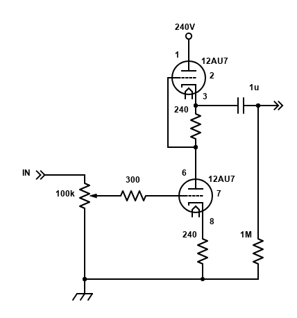

Ok. Since your transformer has enough current, expanding on Elis suggestion of a trippler, I say use a quadrupler.
All caps say 220uF, 160V+, all diodes 600V 2A (for reliability margin). This will give some 240V.
Ad your typical filter after this arrangement (CRC, CLC).
You can then use one tube per channel as included with great results...
EDIT: If you want gain, use the third attachment, but there's an error. Attach the 1uf cap to the bottom of the 240R not the top.

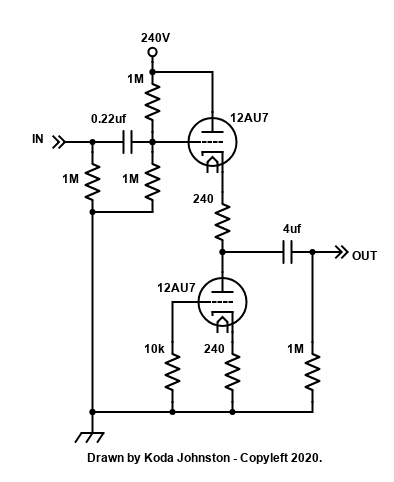

As long as sufficient RMS current is available, the number of stages in a 1/2 wave parallel multiplier can be increased "ad infinitum". The WVDC of the cap. in each stage progressively increases, but the losses per stage hold "constant".
Losses cascade when 1/2 wave serial, AKA Cockcroft-Walton, topology is employed. The stresses applied to the diodes and caps. are equal across all stages. However, 1/2 wave serial topology is both inexpensive and cheap (in the grammatically correct sense).
