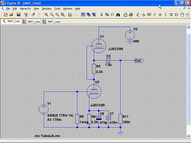

I searched through the DIY pages for The Valve Wizard and found this http://www.diyaudio.com/forums/tubes-valves/118966-valve-wizard.html
Check out the Wizard for SRPP there is a calculation for the output impedance. I believe your previous estimate did not return the best number, I think that is likely somewhat lower.
That thing may work better as a driver than you give it credit.

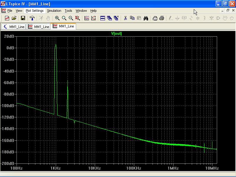

Ah, I only have a BEng in Electronic Engineering (including device physics) and an MSc in an unrelated subject. 🙁The problem is, I have MS in Electronics Engineering, and learnt physics of semiconductor devices in details... It disagrees with your statement.
On the other hand, even an exponential law has no 'sharp corners' in it, AFAIK...
SY, I suppose you suggest other than ecc types
according to this spec sheet. the ecc82/12AU7 have the lowest distortion of the commonly used ecc types, and seems pretty much independant of the voltage, as well as the gain...
Of the ECC types, the 12AU7 has the poorest linearity. See Morgan Jones's measurements in "Valve Amplifiers." The 3rd and 5th harmonic distortion were an order of magnitude worse than a 6SN7. Comparing my measurements, the ECC81 is similar to 6SN7 (not quite as good, but higher gain) and ECC83 is better yet (much higher gain and must be buffered).
Hi DualTriode
Thanks for your feedback.
The equation for the output impedance of the SRPP from The Valve Wizard is for cathode resistor bypassed, for unbypassed cathode resistor, the correct is
Zout = [Ra + Rk (u+1)]/2
It gives almost 54K for the SRPP.

Ohh, I probably forgot to mention that I graduated as well high school where learnt Algebra. Sorry. And AFAIK different curves can be described by functions of different orders. When you take smaller part of a curve you get more smooth transfer function than when you take it's longer part, and it looks more linear: higher weight of the 1'st order member than of higher order members. It works for both, function of power 2/3 ad for exponential function, but exponential curve is described by function that is sum of members of infinitely high orders. It is sharper by nature already.
Now, straightening the curve described by low order function by multiplicaion (negative feedback) you increase it's order. That means, making it more linear you make it bent sharper.
However, feedback applied to the amplifier described by exponential function does not do any harm to it: you can't increase it's order. That's why transistor amps always benefit from feedback in terms of non-linear distortions. But when you apply feedback to tube amp you increase order of it's transfer function, i.e. make it sharper.
Now let's go back to perception and think, which changes of waveshapes we got used to hear in nature and don't hear as distortions, and which of tem will be audible as something that our perception can't recognize as natural changes of sounds?
The keyword is amplify power. Amplifying power you can add distortions that are not heard as distortions, they are filtered out by our own perception. It sounds louder, but still clean. Now trying to minimize this distortions you add some other distortions that perception does not filter out, and hears as something odd. I is what happens when going for lower TD we remove distortions that don't sound as distortions, but add distorions that sound as distortions.
Do you hear e now?
