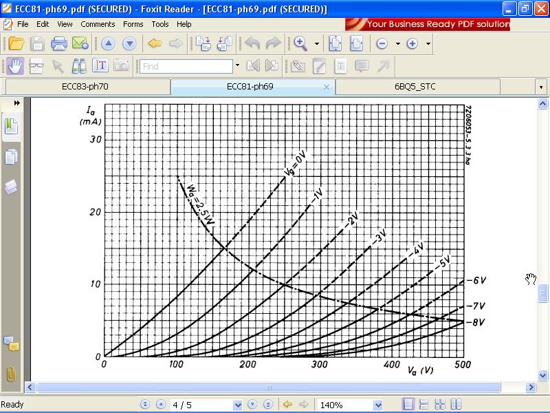

So your personal opinion that space charge reduces valve linearity in a thermionic triode is based on a photoelectric diode experiment to measure Planck's constant? The former is based on voltage change; the latter on light frequency and intensity. Have you ever wondered why the standard valve textbooks never mention this effect you have discovered?
I am aware of the possibility of language problems, which is why I have given popilin the opportunity to explain his ideas so I can see where he gets his strange idea from. I suspect he is confusing emission (whether thermionic or photoelectric) with total current. In the photodiode all the electrons emitted end up at the anode. In a normal triode this is not the case. Far from being a problem, the space charge is a necessity. Not to be reduced, but encouraged.
What has this got to do with linearity at audio frequencies?jmillerdoc said:Unfortunately, in triodes at higher frequencies, the capacitance between the anode and grid electrodes can cause positive feedback, regeneration, or oscillation, or other reactances with the circuit. As i rcall, adding various grid in part works by reducing the inter tube capacitances which effect a whole host of things.

With a low anode-cathode voltage (4V) a small bit of space charge will reduce current. No surprise there. Space charge reduces current in a normal valve too - that is what it is supposed to do. Photodiode operation roughly corresponds to temperature-limited thermionic valves: most, if not all, emitted electrons will go to the anode. Anode current will not vary much with anode voltage, but will vary greatly with light/heat. Once you have a substantial space charge developed (high light/heat) then current varies slowly with light/heat but quickly with anode voltage (3/2 power law).
Triode linearity does not depend on trying to do away with the 3/2 law, but ensuring that the anode and grid law are the same - then you get constant mu and low distortion. You are trying to reduce the very effect which makes valves work properly!

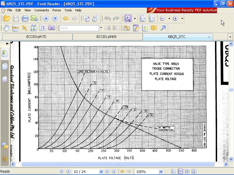

Lets a vacuum diode at zero total current i=0 now the thermionic effect dominates, we have only electron cloud/space charge and the current density j can be derived from Fermi-Dirac distribution, and is given by
equation (1) (Doesn't matter it's form)
For a given current density j (In the limit of large current densities) the total current i>o
Maxwell Equations=>Poisson Equation=>Child-Langmuir Law or 3/2 power law
equation (2)
For a transition from eq.(1) to eq.(2) we need increase the current. (increasing Vak par exemple)
As current increases, the electrons of the cloud are accelerated and go to the anode.
Not all electrons can escape from the cloud, increasing Vak more electrons can do it and the electron cloud effect tends to decrease as current increases.
From a given Vak, Ia vs Va graph tends to a straight-line.The 3/2 power law tends to a linear law.
Now, if we add a grid, we have a triode, and the analysis is more complex, however, for Vgk=0 the analysis done is a good approximation, and it can be extrapolated to a triode, even at Vg<0.
We must note that electron cloud/space charge ever exists, without it we haven't a valve anymore.
I hope I have explained the reason that most of us used the linear region to design a valve circuit.
Analysis is simple and crude, but can illustrate the point.
You still haven't understood Planck constant experiment, BTW the accepted value for Planck constant is
h = 6.626... x 10^-34 J s
Very close to the result obtained with less electron cloud/space charge !!!
I will try another approach
equation (2)
You still don't get it do you? If you deliberately run a valve in the region where the space charge is small then you are approaching the temperature-limited region. In this region the triode is not linear: it stops being a triode because the current depends on cathode temperature rather than electrode voltages. This is how a thermionic noise diode works.
Please go away and read up how triode valves really work. There is plenty of good stuff on the internet. I have tried to correct your misunderstanding but there is a limit to how much free tuition I can give to an obstinate student. Maybe someone else can take over. I have had enough.
Yes, electron cloud effect, that's one reason for tetrode and pentode invention.
The electrons between cathode and anode disturb the pass of new electrons.
Charges with same sign tend to repel each other.
I had seen that many times in the lab, didn't you made Thermionic Effect experiment, or measure the Planck constant?
Wasn't this the reason for g3 in a pentode and beam plates in a tetrode? Or ios this another effect?
