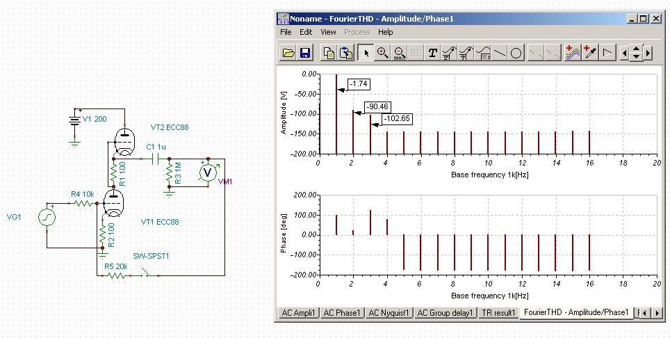

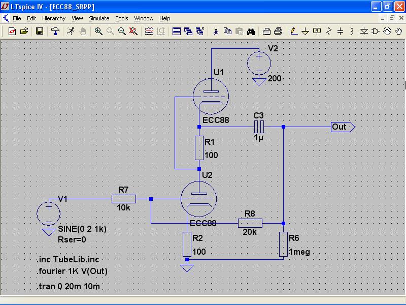

This is an inverting amplifier. I don't think you applied the feedback correctly. Notice all the "grass" in the FFT. This is open loop @ 1.16Vrms output @ 1kHz. Since this is driving 1M ohm, THD is very low. I changed the load to 100k and the open loop THD goes up a lot, as expected, and loop feedback brings it down (when the input level is adjusted to match the open loop output level). The "grass" remains unchanged. So, without loop feedback, and putting the volume control after the gain stage, means that you're basically listening to distortion and noise. If that floats your boat, then so be it, but it's not what audio engineers usually strive for in their designs. There's a very good reason that the volume control goes in the front of the preamp, and that's why it's been done that way for decades now.
Just two little details
1) Open loop you need a grid leak resistor.
2) Closed loop, output level is highly dependent on the impedance of the source, not a problem with a CDP/DAC, though.
A well implemented volume pot should help. 😉

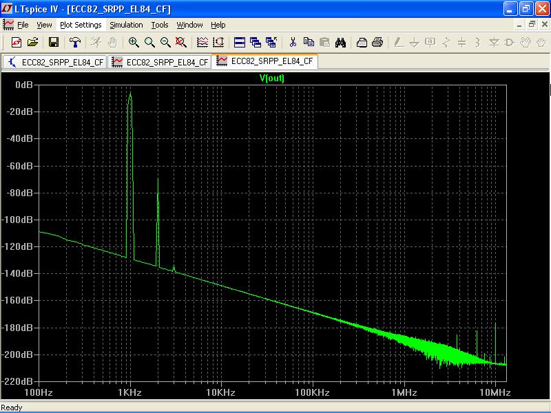

I would like to see a simple SRPP with 0.002% THD at 1 V RMS output for REAL. Without feedback, of course. I have never seen one.
Complicated is subjective but anyway it surely works great, and not just because I say it. It's a commercial product that you can buy as a kit if you don't want to go mad to understand all the tricks in play. It also has choke input PSU.
It's only a demo circuit. Please don't confuse it with real life.
Ah, silly me, it is just a simulation, nice excuse by the way.
Sorry, but when I make a simulation, it is supposed to work in real life, and quite often they do it. 😉

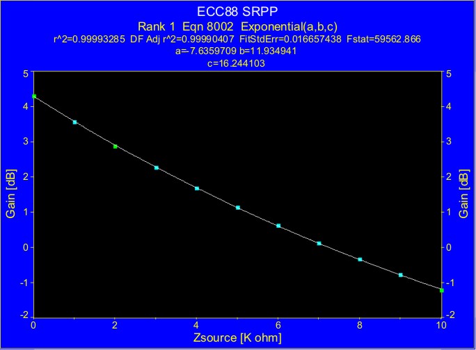

Your proposed circuit, on the best case scenario, i.e. zero source impedance, has a gain of about 4.32 dB, so at maximum volume expect an output voltage of about 0.52 VRMS.
Then, under this supposition, it is not as irrelevant.

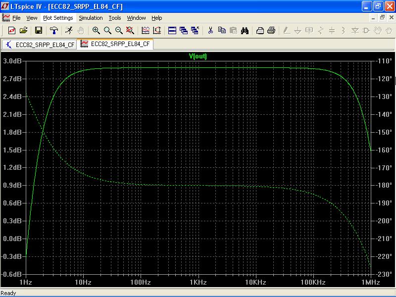

A reasonable equilibrium between THD, noise, frequency response, phase shift and gain.

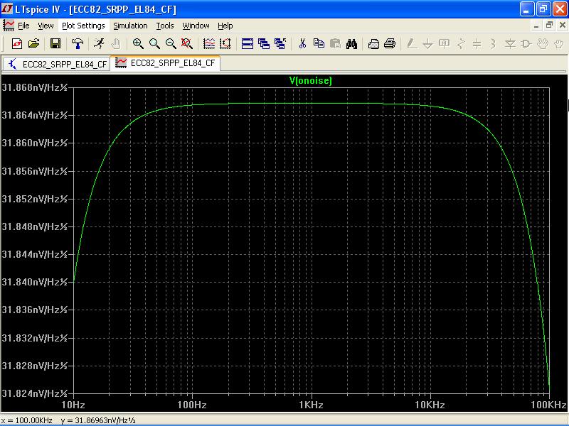

I have no idea about EL84 noise, so no calculation, sorry.
BTW, the volume pot is between both sections, sadly LTSpice doesn't allow pots, so two resistors is a good equivalent.
