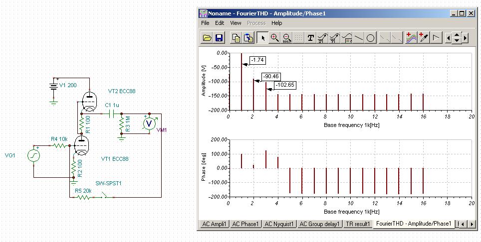

This is an inverting amplifier. I don't think you applied the feedback correctly. Notice all the "grass" in the FFT. This is open loop @ 1.16Vrms output @ 1kHz. Since this is driving 1M ohm, THD is very low. I changed the load to 100k and the open loop THD goes up a lot, as expected, and loop feedback brings it down (when the input level is adjusted to match the open loop output level). The "grass" remains unchanged. So, without loop feedback, and putting the volume control after the gain stage, means that you're basically listening to distortion and noise. If that floats your boat, then so be it, but it's not what audio engineers usually strive for in their designs. There's a very good reason that the volume control goes in the front of the preamp, and that's why it's been done that way for decades now.

The "grass", as you call it, is @ -150dB (at least that's what your simulation program wants you to believe). How is this relevant?Notice all the "grass" in the FFT.
I don't think you understand how your circuit works. Connecting the 1Meg load or not won't make much difference. In your schematic, the lower tube sees about (μ+1)*Rk + rp which is about 6K (ECC88). The upper tube acts simply as an active load. You'll need a much lower load in order for SRPP to work as intended (it's called "shunt regulated" for a reason).This is open loop @ 1.16Vrms output @ 1kHz. Since this is driving 1M ohm, THD is very low.
As a side note, closing the feedback loop not only applies the feedback but also lowers the effective load of the circuit significantly (20K at the output) and therefore changing the characteristics.
Good point.As a side note, closing the feedback loop not only applies the feedback but also lowers the effective load of the circuit significantly (20K at the output) and therefore changing the characteristics.
