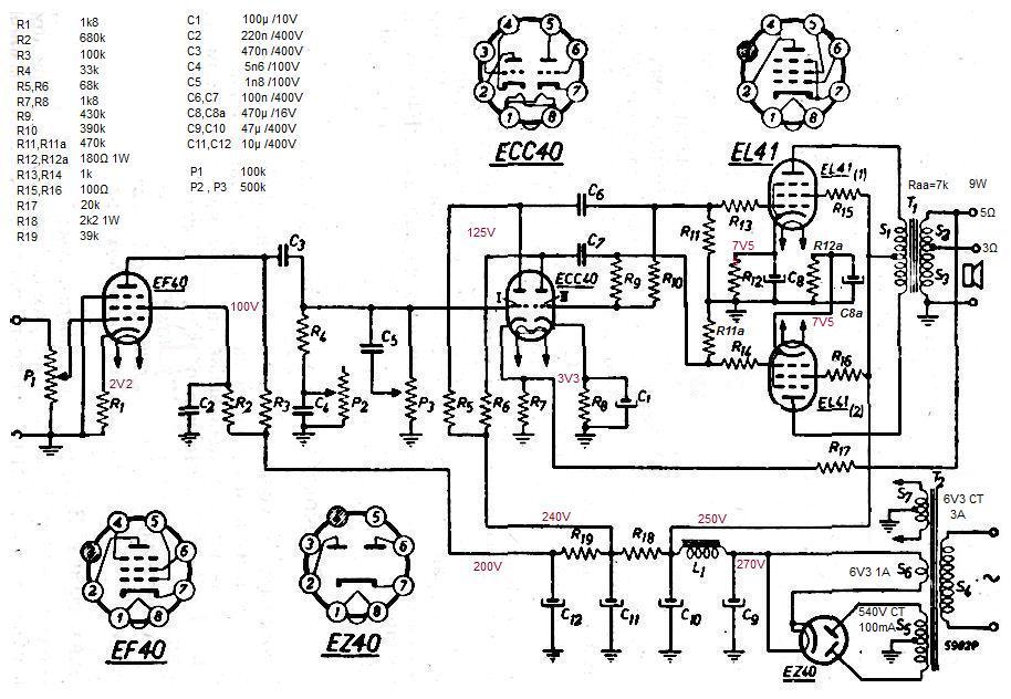

Another idea: If you've got yet some ECC40's, but no EBC41, you'd want to completely rearrange the PI section around the triode pair from the original LTP to a voltage amplifier plus a Concertina, see page 4, Fig. B in the yet mentioned Philips ECC40 datsheet. Total voltage gain will be about the same as with a ECC83 LTP, and as EL41's are frugal to drive, a Concertina will work as well. But be aware of it's poor PSRR, i.e. provide good plate supply filtering!

As said before, you can use the same tubes, but you may want to rearrange the PI section around your ECC40.
PSRR of a Concertina is bad due to it's arrangement as a voltage divider (as seen from plate supply), and is even worsened due to the different impedances at the tube's cathode and plate.
Best regards!
Let me propose some mod's and values 🙂 keeps me bizzy 😀
If you don't need the tone control, skip the EF40 and put the volume control on the first grid of the ECC40.

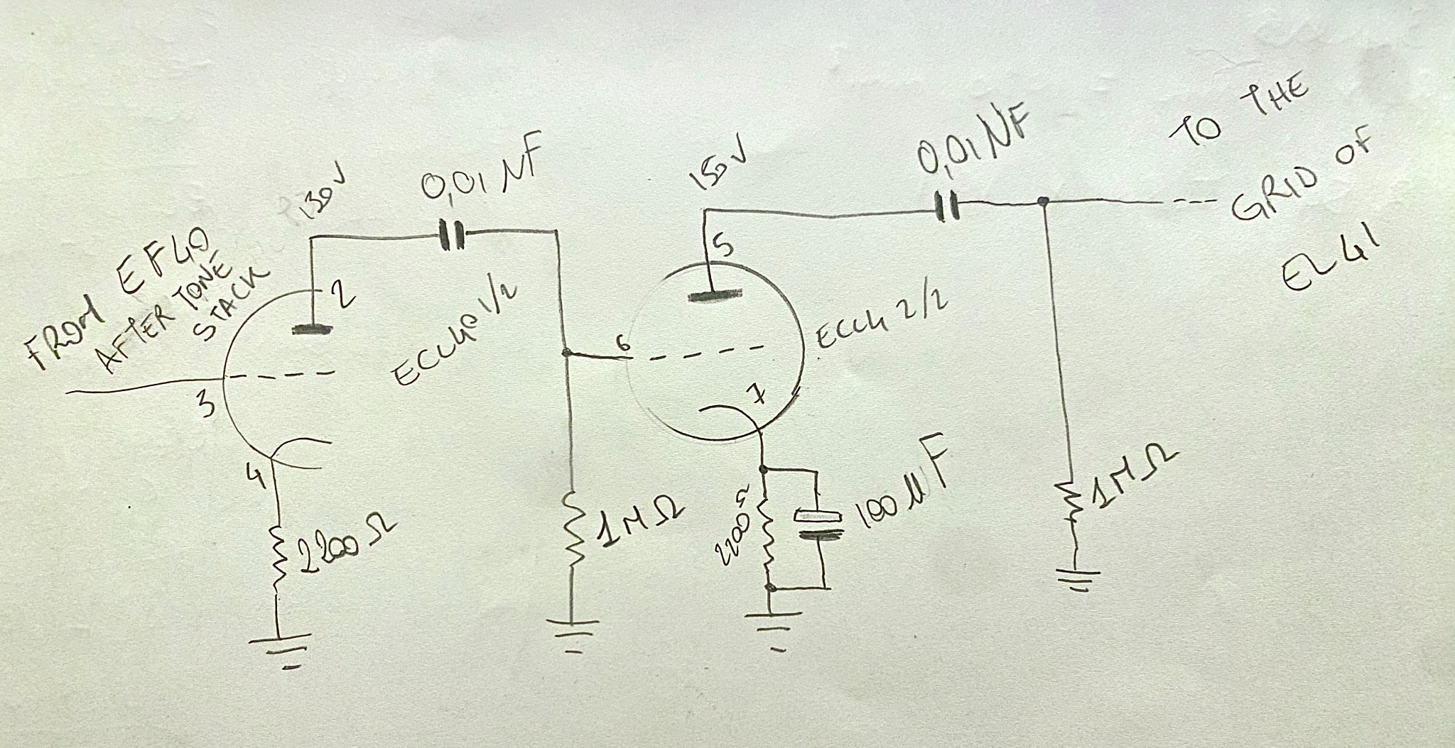

I have used this scheme as a starting point, i've basically done the same preamp stage, but with the ECC40 in cascode ending in a single EL41.
Tried everything, literally everything, but i can't make it sound. Long story short i putted the first stage of the ecc40 in the grid of the second stage and from the plate of the second stage to the grid of the el41. Even if i disconnect completely the second stage of the ecc40 and connect directly the output of the first triode to the el41 i have just a low mushed sound. And it's strange, if i connect the el41 to the ef40 i have more gain than the ecc40.
Yes i tried to swap the tube with a new one, the only concern i have is that i don't have enought negative voltage on the cathode and grid of the ecc40...
Well, let's see if someone will come out with a nice idea, i'm really stuck!

You are right, i mispelled the world from cascade to cascode, wich is a really unfortunate mispell.
Anyway, i provide below with the scheme, is the cascade of the ECC40, the exact copy of what i did.
I've measured the voltage on the cathode and it's close to +4v on every triode, and i forgot actually to draw on the scheme the B+ line, but i think you get it.
I hope this will be more helpful 😀
You still don't show what you did with the output stage.
Is it still running in pentode mode or triode ?
Did you adjust the cathode resistor for a single EL41 ?
Did you realize that the original PP output stage had feedback from the transformer to the 1st ECC40 ?
And that the 2nd ECC40 had no gain at all, just providing the inverted signal to the other output tube in PP ?
Did you just leave the FB out ?
Anyway, your cascAding is a major problem.
EF40 into ECC40 into another ECC40 into EL41 in pentode ... that is way too much gain.
The pentode input unbypassed) has gain of 30, the 1st ECC40 (unbypassed) gain of 20, the 3rd ECC40 (bypassed) another gain of 30.
Which gives: 30 x 20 x 30 = 18000 !!!
Anything more than 1mV of input will drive your EL41 into clipping.
And the sheer amount of gain in your setup will most likely cause oscillation, too, both high frequency (causing distortion) and / or low frequency (motor boating).
... i have just a low mushed sound.
unless there is something fundamentally wrong with the output stage or the FB , suspect oscillation
another indication that your amp oscillates
that could be a quick fix:
take out the ECC40s and connect the EL41 to the EF40 as you already tried;
now connect the feedback resistor 22K from the transformer secondary to the cathode of the ef40;
ground the other end of the secondary;
you should now have the proper gain for line input signals;
(if it doesn't work well, you have to reverse the secondary)
you need feedback anyhow to make pentodes sound;
and use grid stoppers - 1K resistors short and directly soldered to control grid pins.

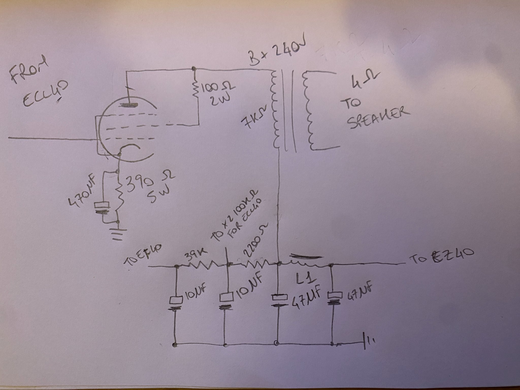

BTW, maybe i was just clipping the hell out of that EL41, and in fact with one EF40 it's just good, you're definetively right, i'm just an idiot and i haven't took in consideration the fact that the second ECC40 triode was just a phase splitter for the PP. But even if i was connecting only one triode it was the same so... definetively i'm missing something.
And yes, i changed the section of the EL41, and obviously with a different OT.
I've also tried to make 2 EF40 one after another, but i just multiply the noise XD....
I also tried to put grid stoppers, but if i use one EF40 does not make any difference, if i try to put it in the second EF40 (the one i added for experimenting) it make a real difference, but also basically exclude the tone controls.
I will also try to put just the ECC40 alone, skipping the EF40 just for the sake of see what happen.
I've created a benchmark (using an old radio chassis), to test various tubes and experimenting while reading electronics.
Thanks again 😀!!!

OK,
now the EL41 output is triode connected, which means lower gain, lower distortion and lower output power than in pentode,
don't expect more than 1 Watt undistorted with your 250V PS.
Yes, skipping the EF40 and with one ECC40 as input this should work without feedback. Take the one with bypassed cathode resistor.
But believe me, the output EL41 does require grid stoppers, 1K on the grid and 100 ohm on the screen, too.
I always use them and never experienced any negative effects.
On the contrary, I remember my earliest experience with a EL500 which seemed to defy ohms law when triode connected because current and voltage across the cathode resistor did not go together. Until I realized that a DMM one meter away, not connected to anything, showed OL whenever the power to the tube was on. It had turned into a powerful RF transmitter. It required stoppers on both grids to tame that.

Noooo, i committed a scheme crime. The G2 wasn't connected to the plate but to the beginning of the B+ of the OT.
But now that i know that i can do it i will try it 😀!
Today i also experimented a little with the ECC40. Basically with one triode of the ECC40 everything is fine, if i stack up the second triode (in cascade 😆), it start motorboat. I have to learn what happen when it start motorboat like that, is funny because the choke that is held just by a screw start oscillate too 😆, it's just funny to see that, magnetic field that fluctuate so much that it vibrate from the holding leads!
