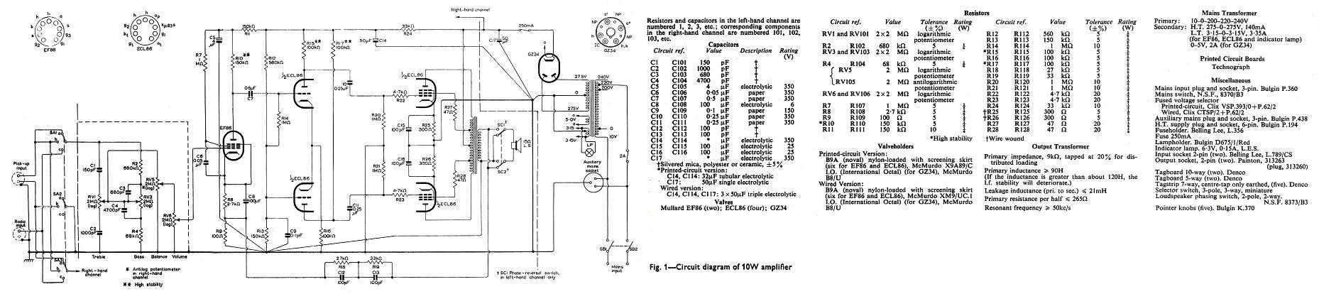

So, your starting point was " this scheme " which is ef40 pentode input, ecc40 phase splitter, push-pull output.
You changed that to ef40 input, ecc40 cascode, single ended output.
Anything you didn't change ?
Besides that " 1st ecc40 connected to grid of 2nd ecc40 " does not describe a cascode .... ?
I am completely lost .... don't expect any useful answer unless you post a schematic drawing of what you actually tried to build.
You are right, i mispelled the world from cascade to cascode, wich is a really unfortunate mispell.
Anyway, i provide below with the scheme, is the cascade of the ECC40, the exact copy of what i did.
I've measured the voltage on the cathode and it's close to +4v on every triode, and i forgot actually to draw on the scheme the B+ line, but i think you get it.
I hope this will be more helpful 😀
You still don't show what you did with the output stage.
Is it still running in pentode mode or triode ?
Did you adjust the cathode resistor for a single EL41 ?
Did you realize that the original PP output stage had feedback from the transformer to the 1st ECC40 ?
And that the 2nd ECC40 had no gain at all, just providing the inverted signal to the other output tube in PP ?
Did you just leave the FB out ?
Anyway, your cascAding is a major problem.
EF40 into ECC40 into another ECC40 into EL41 in pentode ... that is way too much gain.
The pentode input unbypassed) has gain of 30, the 1st ECC40 (unbypassed) gain of 20, the 3rd ECC40 (bypassed) another gain of 30.
Which gives: 30 x 20 x 30 = 18000 !!!
Anything more than 1mV of input will drive your EL41 into clipping.
And the sheer amount of gain in your setup will most likely cause oscillation, too, both high frequency (causing distortion) and / or low frequency (motor boating).

unless there is something fundamentally wrong with the output stage or the FB , suspect oscillation... i have just a low mushed sound.
another indication that your amp oscillatesAnd it's strange, if i connect the el41 to the ef40 i have more gain than the ecc40.
that could be a quick fix:
take out the ECC40s and connect the EL41 to the EF40 as you already tried;
now connect the feedback resistor 22K from the transformer secondary to the cathode of the ef40;
ground the other end of the secondary;
you should now have the proper gain for line input signals;
(if it doesn't work well, you have to reverse the secondary)
you need feedback anyhow to make pentodes sound;
and use grid stoppers - 1K resistors short and directly soldered to control grid pins.

Thanks for the time you took for me, so, the thing is i really don't know a LOT of thing and i'm just messing around with things that i scavange from old radios 🙂.
BTW, maybe i was just clipping the hell out of that EL41, and in fact with one EF40 it's just good, you're definetively right, i'm just an idiot and i haven't took in consideration the fact that the second ECC40 triode was just a phase splitter for the PP. But even if i was connecting only one triode it was the same so... definetively i'm missing something.
And yes, i changed the section of the EL41, and obviously with a different OT.
I've also tried to make 2 EF40 one after another, but i just multiply the noise XD....
I also tried to put grid stoppers, but if i use one EF40 does not make any difference, if i try to put it in the second EF40 (the one i added for experimenting) it make a real difference, but also basically exclude the tone controls.
I will also try to put just the ECC40 alone, skipping the EF40 just for the sake of see what happen.
I've created a benchmark (using an old radio chassis), to test various tubes and experimenting while reading electronics.
Thanks again 😀!!!
OK,
now the EL41 output is triode connected, which means lower gain, lower distortion and lower output power than in pentode,
don't expect more than 1 Watt undistorted with your 250V PS.
Yes, skipping the EF40 and with one ECC40 as input this should work without feedback. Take the one with bypassed cathode resistor.
But believe me, the output EL41 does require grid stoppers, 1K on the grid and 100 ohm on the screen, too.

Noooo, i committed a scheme crime. The G2 wasn't connected to the plate but to the beginning of the B+ of the OT.OK,

Today i also experimented a little with the ECC40. Basically with one triode of the ECC40 everything is fine, if i stack up the second triode (in cascade 😆), it start motorboat. I have to learn what happen when it start motorboat like that, is funny because the choke that is held just by a screw start oscillate too 😆, it's just funny to see that, magnetic field that fluctuate so much that it vibrate from the holding leads!
Thanks Sorento (are you also italian?), you really helped me figure out what i was doing wrong 😍!
