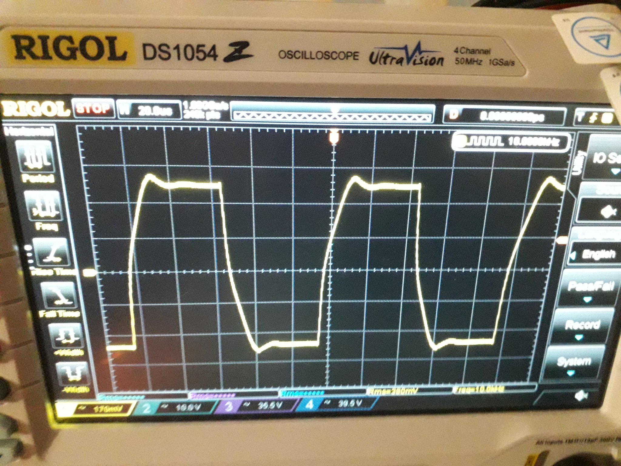

You have the measured damping factor and 1620 datasheet, why do you not calculate the exact ri of 845 ?
From what I remember it is much lower than you suspect.
A very important factor to troubleshooting the amplifier:
A 20kHz square wave in Post # 12 looks 'textbook perfect' at the input tube, driver tube, AND the output tube Grid.
(There was no negative feedback during that multi trace capture).
The only things left that could cause the odd shaped output from the output transformer secondary are:
The 211 Tube (not likely the cause)
The 211 filament circuit path to ground (not likely the cause)
The non-inductive load resistor on the 8 Ohm tap (not likely the cause) [I hope a good resistor was used, not an open, and not a loudspeaker].
The B+ filtering at the top of the output transformer (not likely the cause)
And, the Only thing left . . . The Output Transformer.
Just my opinions
So . . . how about another 50 Posts to give "fixes" that do not fix that 20kHz square wave shape.
Either Live with the shape; OR Replace the Output transformer; only the original poster can do that.

SQ at 10khz, -6db GNFB, and compensation cap.
Better?
So it is a problem with capacitances. Nothing to do with saturation, class B and other similar stuff because 6 dB fbk will not remove them like this. Moreover, core saturation you would see already at lower frequency where induction would be higher and higher. As I said, from the practical point of view you might not hear anything strange. Unfortunately cannot compare the sound with and without feedback to tell something SPECIFIC about that SQ feature because feedback completely changes the way the amp drives the speakers. This also means that sound might be better without feedback. Try and see what is better for you.
