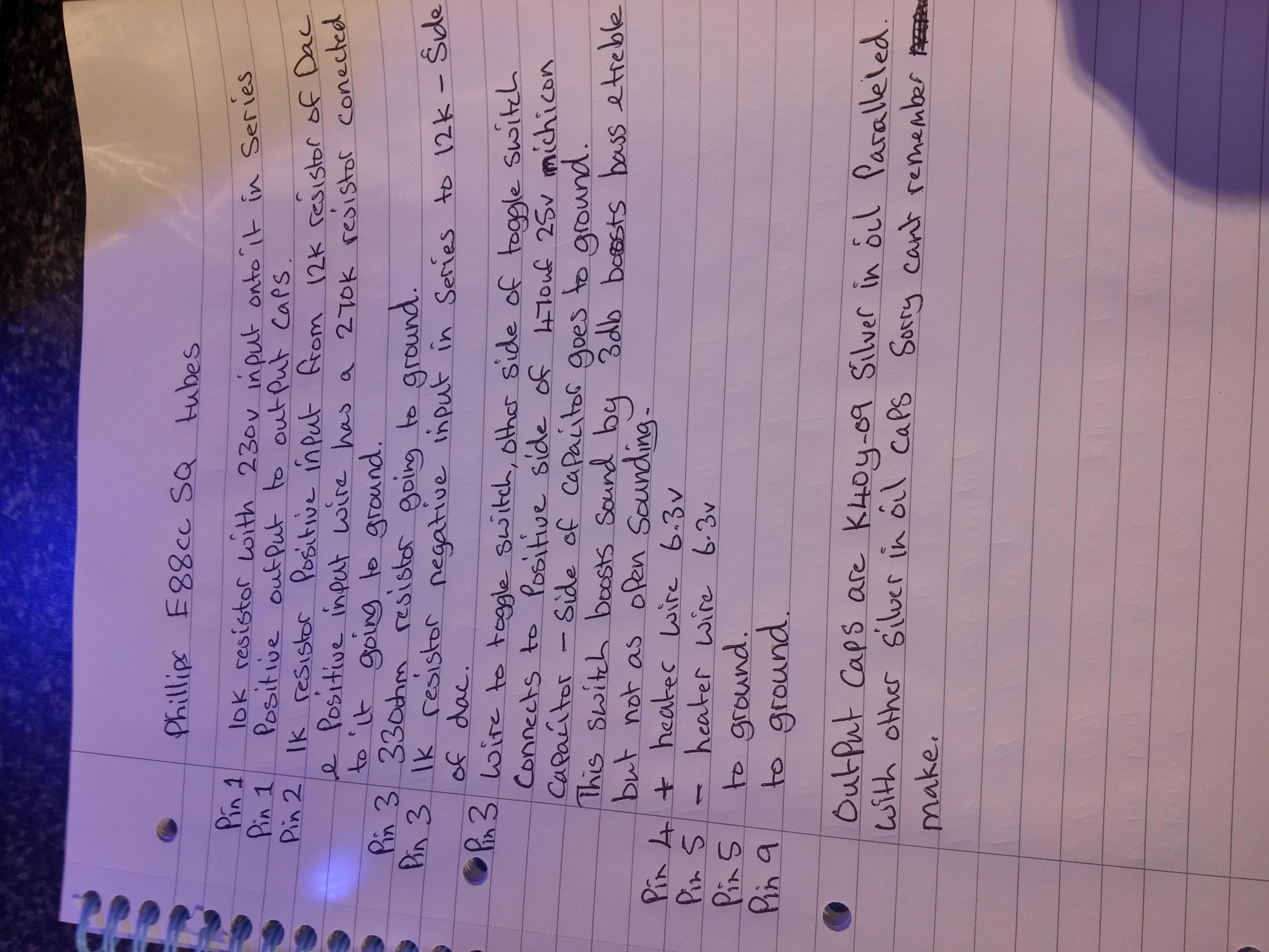

I don't no if this is logical or proper but I have connected after 12k resistors from AK4399 chip direct to phono sockets.
- to outside of socket & + to centre pin & it sounds great clear open lots of bass no noise !
It still sounds much better on tube output but surprised it works so well !

AK4399 dual mono dac has + output & - output on each channel.
Took the + output from 12k resistor to centre pin of a phono socket & the - to the outer conection.
Note nothing else is to be connected to this socket no ground or anything.
Do the same on other channel.
Its at your own risk but sound good on my valve amp with no problems.
I havnt got anything connected after the 12k resistors because I normally use tube output stage.

I understand that, you have used only one chanell per dac, without summing two of them.
DAC direct out was once very popular with AK4395/6 here on DIYAUDIO...

Yes you are correct it sound good but I still prefer it tubed output.
