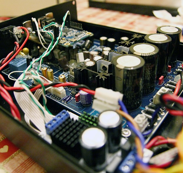

I just took 2 solid AWG22 wires from I2SoverUSB spdif outputs and inserted them where Weiliang's XMOS board should be connected.
To identify the right contacts, you can use DAC's schematics attached: View attachment schematic of dual AK4399 with software control.pdf
Look in the upper middle of the schematics, to the left of AK4113 chip you can find the 7-pin USB connector where Weiliang XMOS should be connected.
Just insert spdif ground wire into pin 6 and spdif + wire into pin 5 or 7 (please choose the pin that has a small smd cap following, i can't remember if it's 5 or 7).
That's so easy.
Sorry i can't take a pic to show that better, because there is a really small room; but follows a pic of the board inside the chassis:

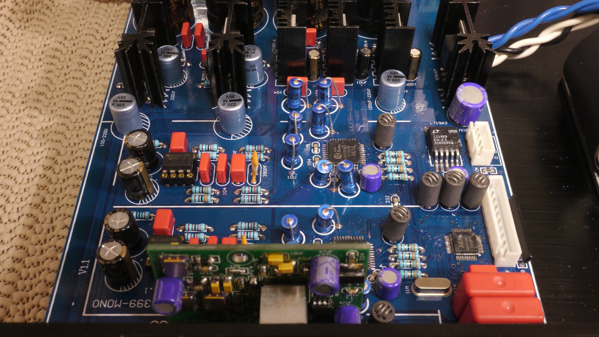

As usual I'm late to many of these DIY parties. I recently purchased V1.1 of the AK4399 Parallel DAC board and AK4118 USB soft-control board. I also purchased this XMOS board for it too.
I know this is dumb question, but there are only 2 ways this daughter card can be fitted and the most obvious way is with the components facing the back of the DAC board. The other way makes it interfere with other components. I looked around the thread for similar pictures, but can't find any with the daughter card fitted to the DAC PCB. Can someone please inform of the correct positioning.
The reason I ask is that my computer is not recognizing the USB input and therefore I'm suspect. I also did the fool-hard thing and solder it. So if indeed it's in wrong it will take a bit more work to correct it. At the moment I intend to use the board without mods, but first I want to get the XMOS board working. I guess there's also the possibility the XMOS card is faulty.

Rick,
It looks correctly installed.
Did you use the dealer supplied xmos driver?
If not contact your dealer or pm me
I believe my XMOS board is bad. Can't measure any voltages at all. I've asked my seller for another one, but do not know for sure whether he'll oblige me. The Toslink and coaxial connection both work, so I don't suspect the DAC board itself, but perhaps that may be an issue. Seems the quality control is a little lacking.It seems now this 7-pin blue XMOS board is hard to get any more (New Xmos USB 7 Pin Asynchronous Daughter Card for AK4399 DAC7 ES9018 SN | eBay). They want to provide the newer version of XMOS U8 USB board (New Asynchronous Xmos U8 USB Module Compatible for AK4399 DAC ES9018 7pin | eBay). I tryed to install the new U8 board to Weiliang DAC V1.1 board, but cant really get it work as needed. There remains always strong crackling disturbance with signal. Drivers I used are v. 2.24, I got them here: http://diyhifishop.com/download/Weiliang_XMOS_Driver_V2.24.rar There are pretty good installation instructions included, better than with older driver versions. But it does not work really. I tryed on WinXP and Win8.1, both the same result. Does anybody have experience, are those v.2.24 drivers right for the U8 board? Or should there be used some other? Or is my U8 board just bad? Otherwise the DAC works as supposed to.
Regarding the drivers... I installed 2 different ones the latest being 2.23 I believe, but understand they are specifically modified for each brand of XMOS card. My computer still does not recognize the device. I'll keep the thread up to date on my saga.
Rick
All is well now. After installing the XMOS CORRECTLY the board came to life and everything appears to be working now. Funny how that works.

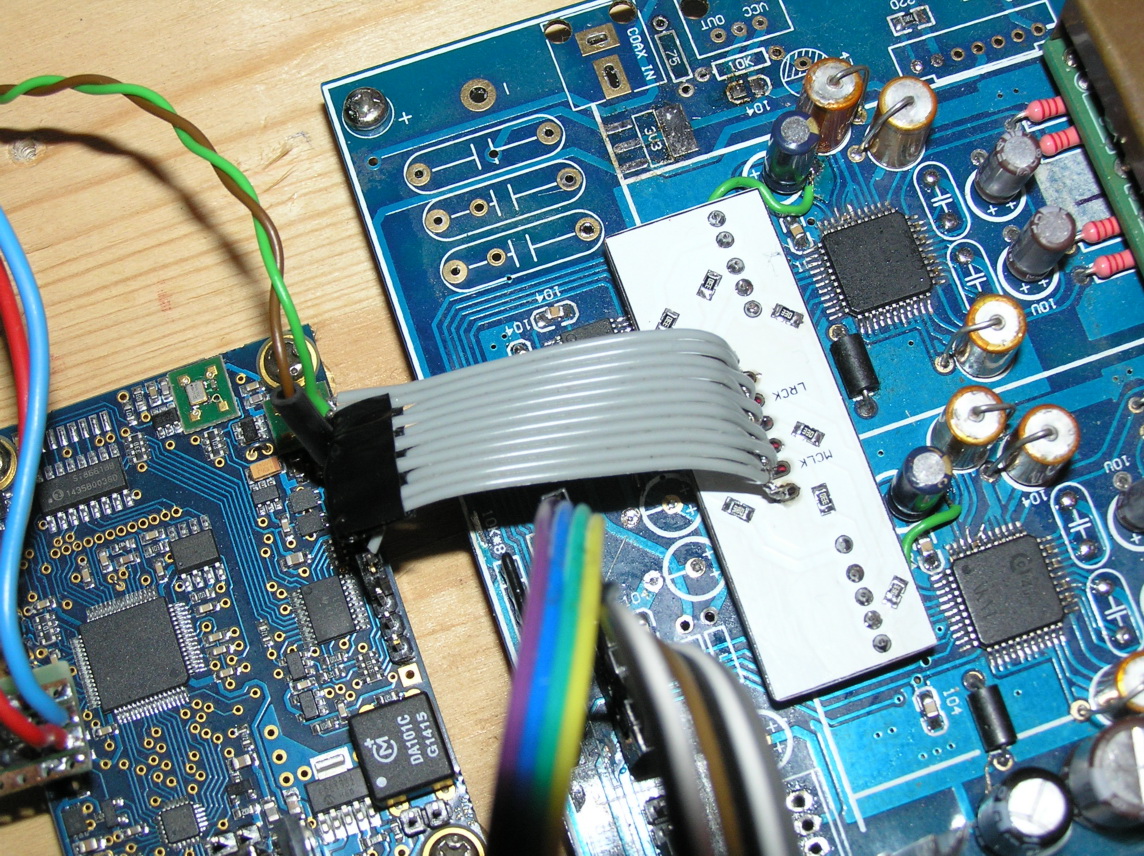

i2s implementation
I installed my new 'i2s-distribution board' with success, eventually, see picture.
At first I had made a ribbon cable, using the GSGSGSGSG scheme, to carry the i2s signals. When I tested the DAC, the sound had become a bit dull, less bass and 3D image was gone. My previous cable was more of improvised nature (see my previous post), but it was also 2 cm shorter, and attached to the resistors of the left DAC (and thus made i2s signal path shorter for the left DAC) . The new cable was even longer (15cm), the total length of the i2s transfer (for both DACs) became too long, about 20+ cm.
So I reorganized my setup a bit and made a ribbon cable of ~5cm, and with the added track length it totals ~10 cm now. SQ has dramatically improved since, it's even better than I ever had, fantastic!
My conclusion is: For a proper i2s implementation use a cable as short as possible and distribute the signals over the two DACs with (close to) equal length. This way the dual DAC approach really pays off IMO.

Hi Nino,
Nice to see you have implemented external i2s with proper approach. Probably I just observed same dull sound as you described because of non optimized i2s connection including desperately long cables which were approximately 15 cms.
