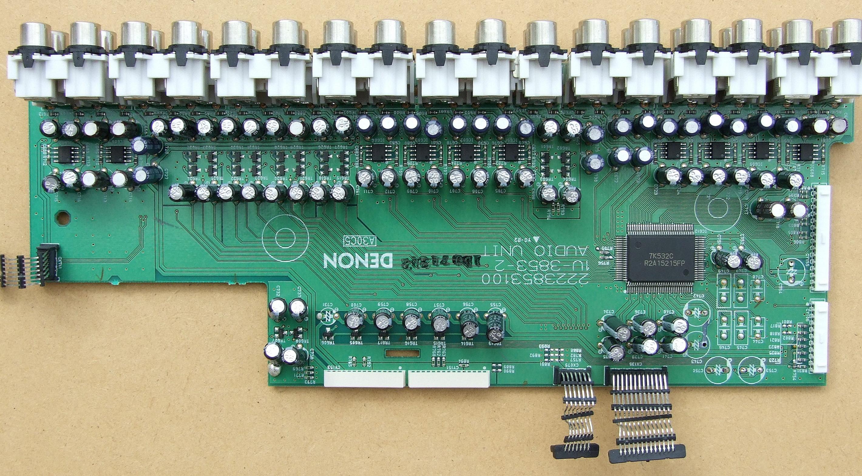

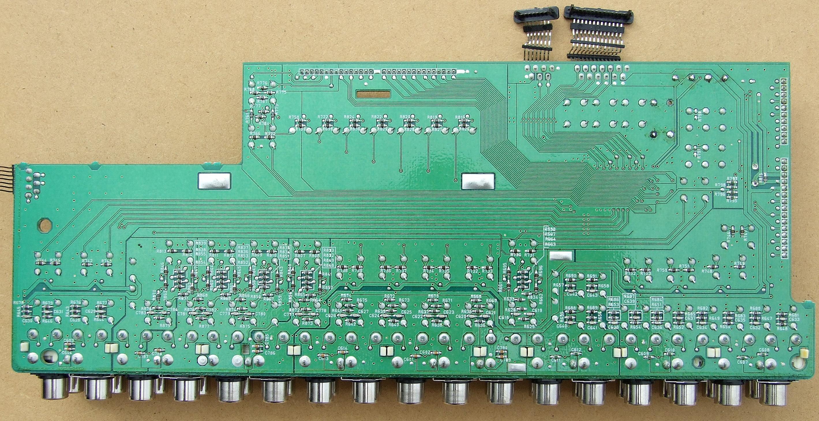

The Denon boards use JRC4580 OP-AMPs. Not JRC2184 as postulated before. "2184" is a FET-driver, it must be a sign of age of my brain.
Can't you keep the TDA7498 amplifier connected permanently to the left and right front speakers with a line-out from the Denon, when you watch films, and switch the TDA7498 input to another source when you want to use it for music?
I took a photo of the top- and rear-side of one of the boards from my Denon AVR 3208. This is one of probably 7 boards, not all with the same density of components. It leaves you with an idea about how difficult it is to modify such a construction. And, why routing of the music signal is quite complex and doesn't leave top-sound.
