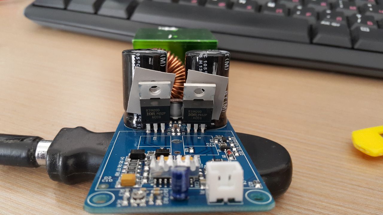

I have this module. It works very correctly, but the out filter coil is very hot. Even with minimal load. It should be like this?

I connected two modules to the bridge. When one module is running alone (not BTL), the drop of Vc to 56V does not matter. But in BTL shutdown at 63V. I have 4 pairs (4 BTL). Connection completely identical. Only one works without downtime. And it also heats up less. The other 3 falling out and warm up IRS2092.
Where can the error be?

You might want to check a few things:
1. The non-inverting op-amp should have 10K-100K input resistor to ground- missing in your sketch
2, Check the IRS2092 Module for the updated resistor Values. R13 from 100 to 3.01K Ohm and R11 from 10K to 8.2K Ohm
3. Set RV1 for 400 kHz (both modules set to same frequency or offset > 25 kHz from each other
4. Ensure power supply droop is not excessive
I believe the resistors are 1206 outline from the E96 series. And please let us know what you find. Thanks- EVMan

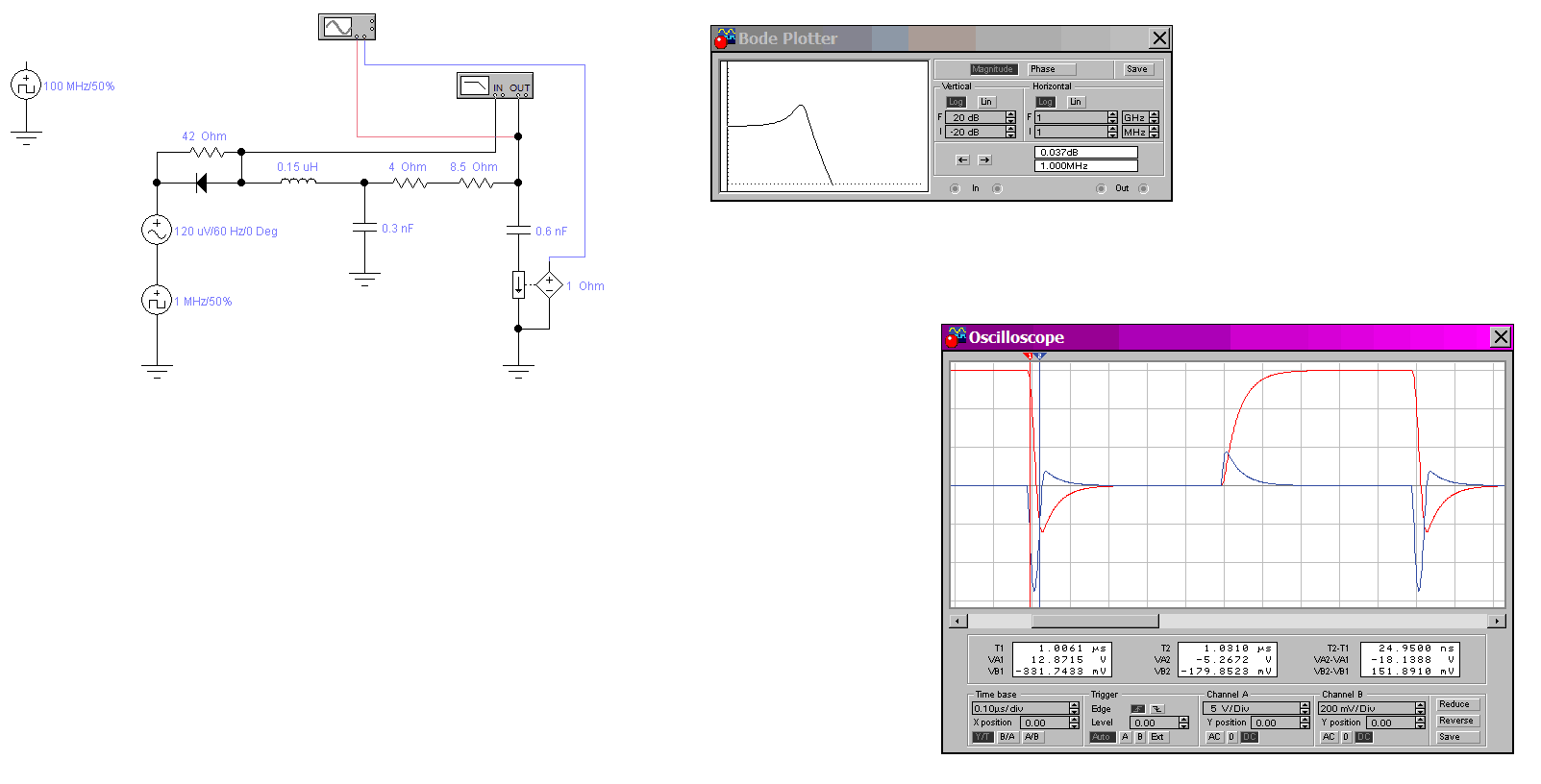

D7 and D8 are positioned before the inductor in the scheme but there are no diodes in parallel with drain and source on the board.
The mosfets are 31N20 with trr of 200ns and require the body diodes to be replaced (they must be before the inductor and in parallel with the drain and source). I suggest adding something like the mur120 with a trr of 35ns to the board, or replacing the original mosfets.
