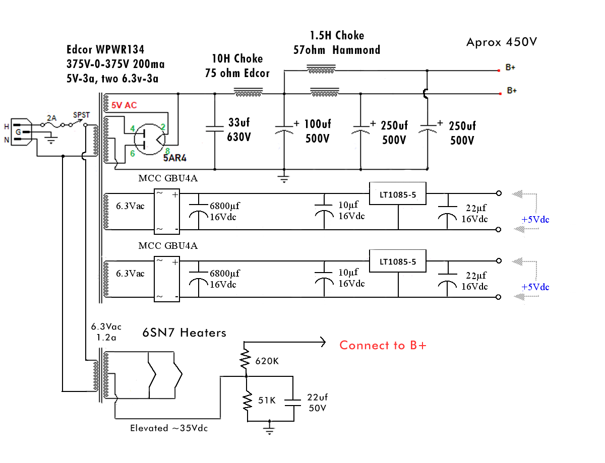

I ran across an interesting 300B kit on ebay.
Without tubes or Iron it is $69.99.
HiFi 300B Vacuum Tube Power Amplifier Board DIY KIT Class A Stereo Audio Amp 16W 832681726807 | eBay
There are several other sellers with the same board/kit. This is the only one with a schematic.
The circuit board does not match the schematic as there are two bridge rectifiers on the board not shown in the schematic, as well as the filament supplies missing for the 300Bs.
There may be other mistakes as well.
I will trace the PCB when I get it and make a schematic in LTSpice to post.
The Grid Stops on the 6SN7 can be increased.
The tube set is listed as PSVANE 300B+Russia 5U4G+Russia 6SN7, however the symbol for the second tube is not a 6SN7. I suspect this is a mistake as the tube sockets are two 4-pin, three octal.
I plan to build it as-is when I get it, then experiment with changes once it get any bugs out of it.
There may be a serious design flaw as there are only two 5Vac connections. It should have three, one for the rectifier and one for each 300B.
Transformers will be XPWR105-120 (EDCOR), three Triad Magnetics F7-X (5V 3A) and One ELectron UPT-3 output. The choke will be a Triad 200mA 5H choke.

2 - 5v: for 300B
2 - 6v: for Rectifier and 6SN7
2 - bridge rectifiers to convert AC to DC for 300B filament
AC: 320-0-320 but why you order XPWR105? Maybe XPWR247 is the best solution where you can increase 10R to reduce the voltage.
XPWR105: 360V(180-0-180)@250mA CT & 6.3V@3A
hammond 260k
or
XPWR247: 660V(330-0-330)@325mA, 6.3V@4A, 6.3@4A, 5@4A & 5@4A

Stephe, not enough sockets for another tube. It looks like three octals and two quads.
I may have miss-read the XPWR105, I have it on the shelf.
I will test it in the coming days. I thought it was a 640V (320-0-320) transformer.
One nice about this design is the possibility to change the bias resistors for the output, A few divider resistors in the PS, switch power transformers and convert to 2A3 or 45.

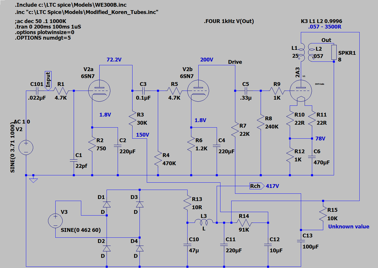

TheGimp,
Post # 2 shows 78V across a 1k self bias resistor.
That is 78mA in a 2A3.
Really?
Do you want to run a 2A3 that way?
15 Watts / 0.078 Amps = 192.3 Volts from the 2A3 Plate to Filament.
It takes a lot more than 192.3 Volts to get 78mA with 78V bias from a 2A3.
And that will far exceed a 2A3's maximum 15 Watt plate dissipation.
Otherwise, correct the schematic to say 300B, not 2A3.

Alishaka - I am trying to use a transformer I have on hand. The XPW105 is too low for B+.
I have a Hammond 270FX on the shelf. it is specified as 550Vac at 115Vac in. With my line voltage of 130vac that puts me at 621Vac vs the specified 640Vac. Close enough to play with, it measures 661Vac no load.
I have a 200ma Choke on hand. It will have a slightly higher DCR compared to 250ma choke, but should also suffice.

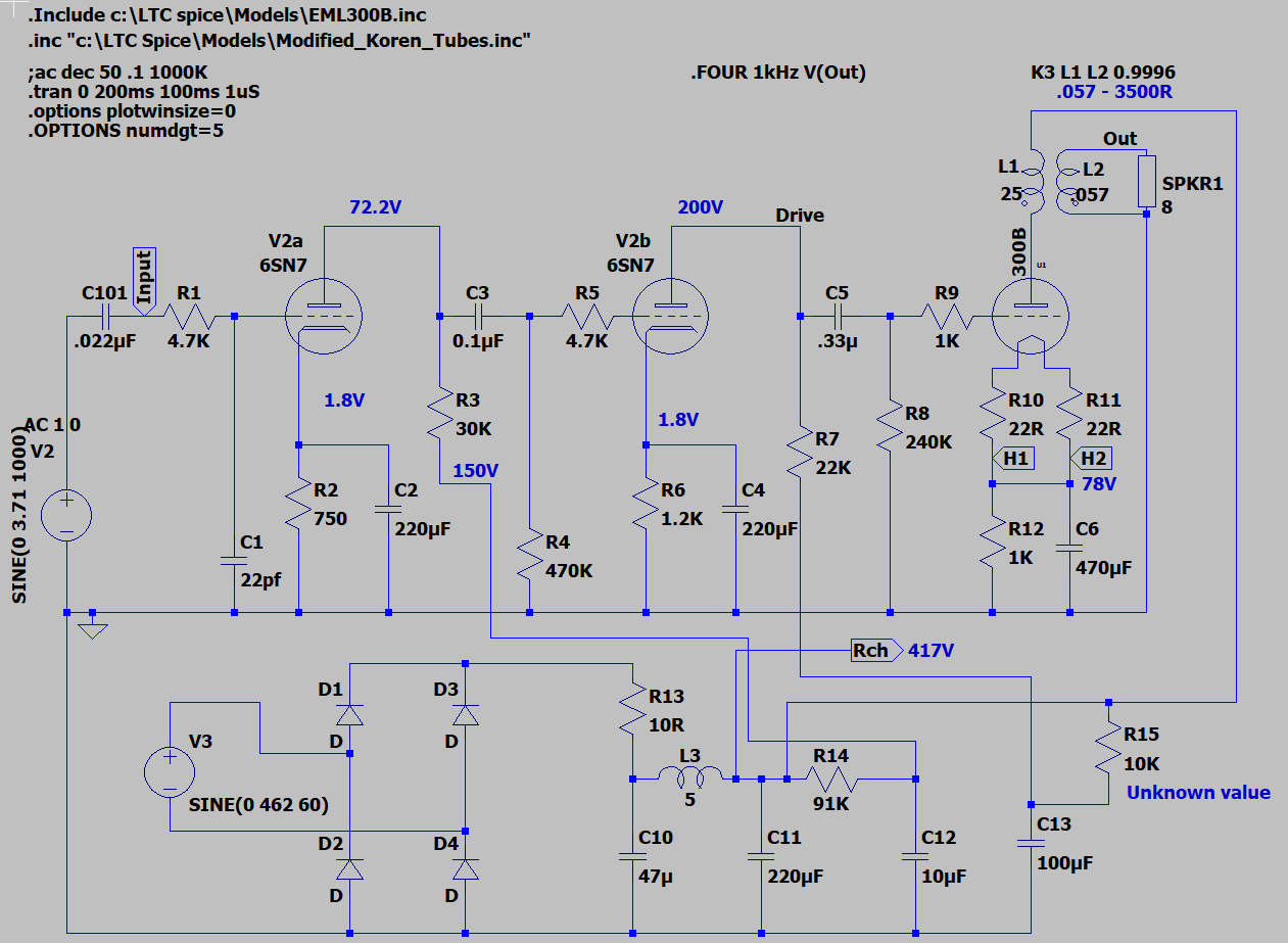

6A3sUMMER - I stated I would change the bias resistor and transformers if I switched tubes.
The voltages on the schematic are from the ebay listing and presume the 300B.
Schematic corrected for 300B at U1. I was originally using a 2A3 spice model as I did not have one for the 300B. Sorry for the confusion.
TheGimp,
Please understand. I did not mean to be critical.
In fact, I am always glad when a schematic is posted, even if it is not 100% correct.
There are Newbies that will see that schematic, and build it exactly as posted.
But there is hope for them . . .
With a schematic posted, all of us can discuss any hints, kinks, or problems and their solutions.
There are many schematics posted on this forum, and unfortunately some are not
woking as posted.
I was merely trying to teach the un-knowing about some fundamental principles.
You could print out a .PDF file, and use a little white-out, and make corrections (or use a red pen), then scan the corrected schematic and get a .PDF file to post.
We might have fewer frustrated builders.
Your schematic, Post # 8 has the 1k grid stopper Before C1, the 22pf to ground. Perhaps that is intended to be a low pass RF filter.
But if it is intended to be a grid stopper, the 1k should be after the 22pf (or use two 1k resistors, one before and one after C1).
Most 6SN7 do not need a grid stopper, but some without grid stoppers do oscillate in similar cascade stages.

Good day 6A3sUMMER,
No offense taken.
I have input the schematic into LTSpice from the schematic in the ebay link in post 1 as I use LTSpice for schematic documentation as well as simulations.
I did not copy the schematic from ebay, to avoid copyright infringement but provided a link for others to see it.
I can attach the .ASC file if people want it.
The series resistor and 22pf cap to ground are in the original schematic so it is drawn as such.
Thank you for pointing out the difference between LPF (Low Pass Filter), noise suppression cap, and Grid-Stop topology.
No offense taken.

Looking at the WE300B datasheet under 350V plate voltage and a 3K primary the recommended current and bias are 60mA and -74V.
My choke has 56 Ohms of resistance and my output transformer has 286 Ohms for a total of 342 Ohms. At 60mA the drop is 20.5V.
The Hammond transformer has a resistance of 50 Ohms, So I can figure on 150mA current dropping the open circuit voltage by 7.5V.
Starting at boilerplate spec for the transformer I see:
550/2 = 275
275 Sqrt 2 *130/115 = 439.6V Peak output corrected for line voltage.
5% core loss in the transformer puts it at 439.6 * 0.95 = 417.6V.
417.6V - transformer Resistive loss is 410V
Rectifier loss is say 30V so now we have 380V at the 10R resistor and choke which drop another (66*.06) 4V for 376V (does the choke drop more than the DC loss? I think so, so this is optimistic.
OPT drop is 17V so we are down to 359V at best, probably more like 340V.
-74V bias would require the bias resistor to change to 74/.06 = 1233 Ohms. two 5W 2400R resistors in parallel would be close.
I will use separate transformers for the 300B filaments so the Hammond will not be fully loaded. It will supply the 5U4 and 6SN7s. If necessary, I have an additional 5V transformer I can use for the 5u4 to reduce loading of the Hammond. This should help with voltage sag.
Once I have it built and can make proper measurements with the Hammond, I can decide on a proper power transformer if the Hammond is too low.

Mine is running at 430V at the plate, 70V on the cathode with an 880ohm resistor @ 80ma using a 375-0-375 trafco through a 5AR4. If the trafco is wound for 110V you can lower it with a bucking transformer, but I would go with one wound for the voltage you plan to use. I did use 500V caps in the PS to be safe.
[T]he symbol for the second tube is not a 6SN7. I suspect this is a mistake as the tube sockets are two 4-pin, three octal.
Yeah. That's indeed odd. Last I checked a 6SN7 contained two triodes, not a triode and a tetrode. 🙂 The third octal tube is marked 5U4G on the board and the text says "board prevails", so that's not the mysterious driver tube.
There's no bias adjustment on the 300B. Not that I can tell anyway. It looks like the part of the schematic that's smeared out is a humdinger pot, not a bias adjustment.
The 16 W must be Chinese watt or measured at 200 % THD. Two channels of 8 W each on a good day, maybe. Given the relatively low bias of the 300B, I doubt you'll get more than 5 W out of it (3-5 % THD).
That said, the 6SN7 can be a nice driver tube for the 300B. If you don't mind a little sand in the glass, it would be worthwhile to consider adding something like Tubelab's PowerDrive: Power Drive | Tubelab to drive the 300B and lower/eliminate the blocking distortion.

An Edcor XPWR134, using the 5V for the 5AR4, the two 6.3V to power DC through 5V regulators to the 300B heaters and a separate Hammond 6.3V center tap 1.2a transformer for the two 6SN7 elevated to 35V. I'm running the JC Morrison design that direct couples the two 6SN7 triodes and has one cathode at 1.4V and the other at 75V. I'm also running a split rail setup with 2 chokes after the first LC network. If you try this, make sure you use solid tantalum caps on the 5V regulators.
