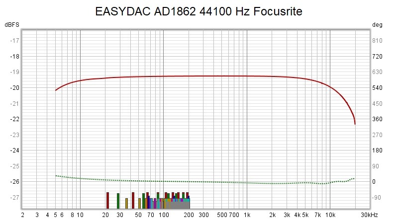

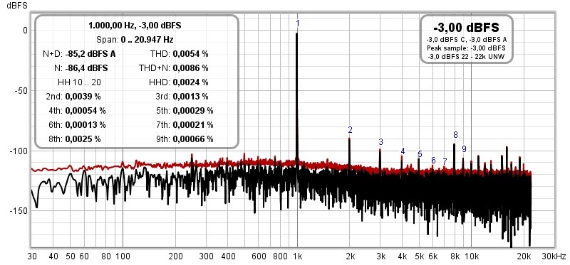

Hi guys, I accidently did a kind of measurment of my EasyDac these days, when I had my Focusrite thing and my EasyDac on the table. Did a 1kHz distortion plot and a frequency plot. Just to know, how it looks like and for these, who like to look at this. Don't look at the absolute db level, just at the relaive level. Nos droop is good to see and in my eyes a relatively nice distortion spectrum. Btw, in my AD1862 DAC, which has adjustable distortion and PSU2, the noisefloor was better by about 10 db and I could better disortions by almost 20 db, if I remember correctly. Will have a look into it. Anyway, I was surprised.
@ernesternest The parameters are very good for USB powered R-2R NOS DAC without filters 🤗
