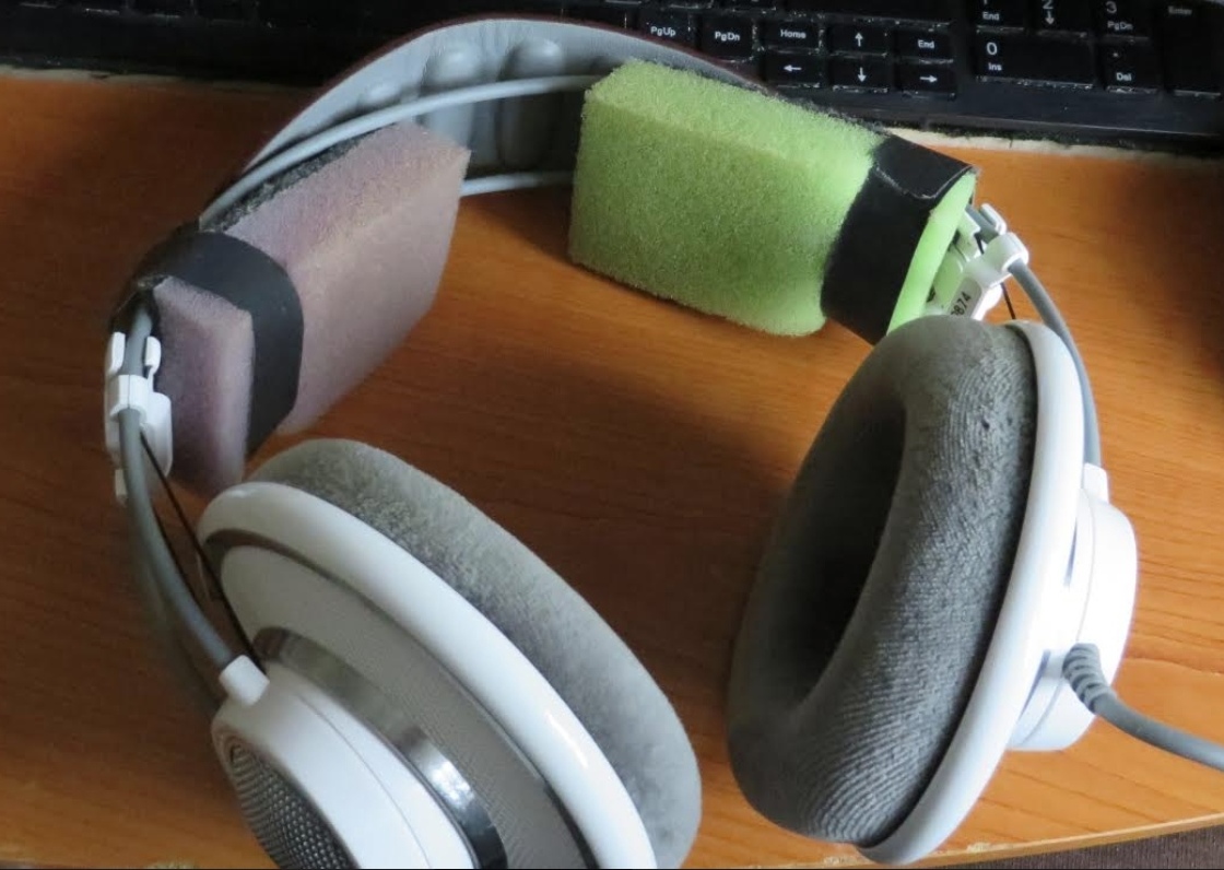

There are many headphones. Everyone prefers something different - not only due to the sound but also the construction matters. I fell in love with AKG K701, whose construction I hardly modified from uncomfortable to the most comfortable 😀

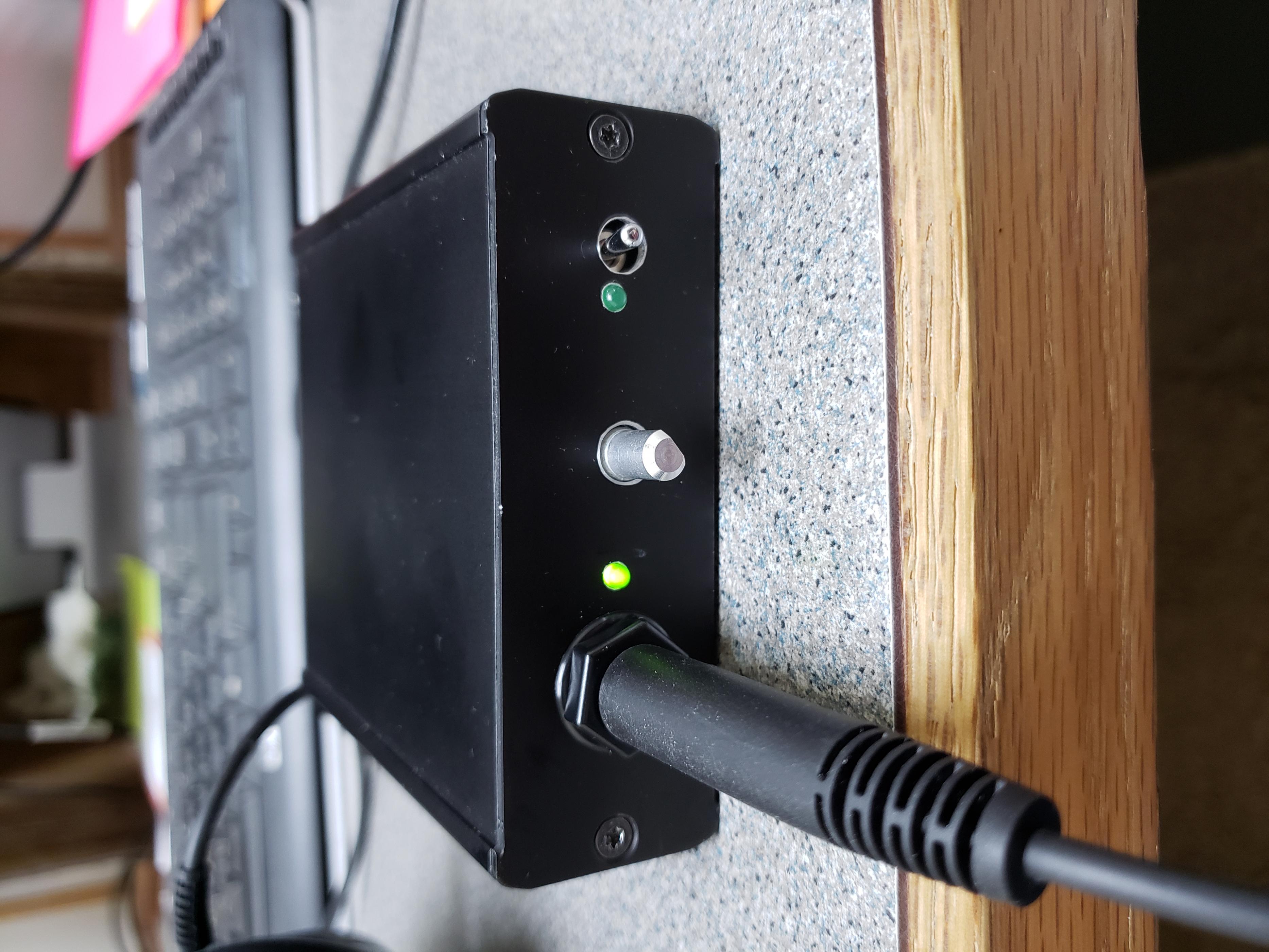

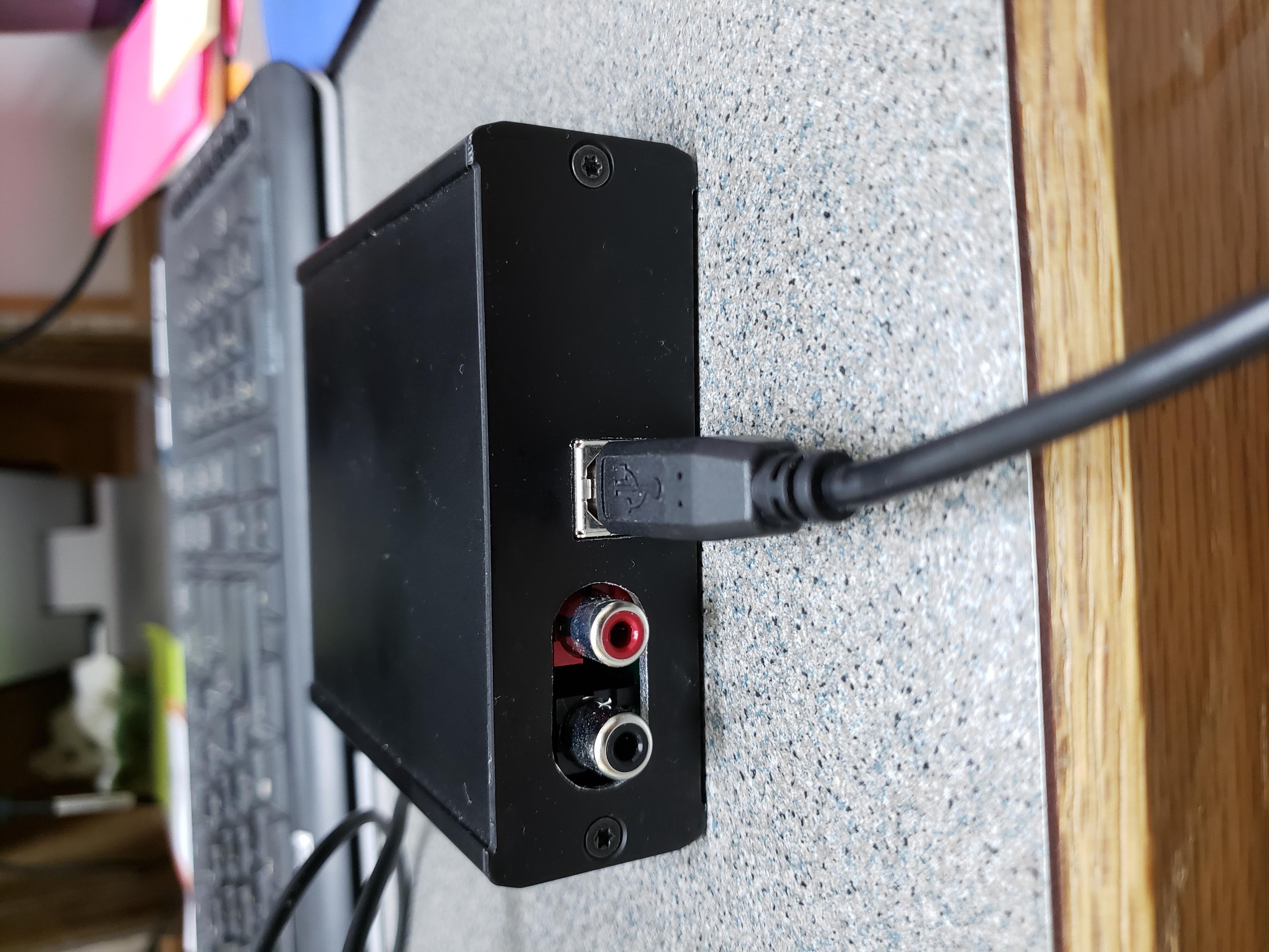

@Miro - I was able to get it to work on one computer but not the other one in my house. Seems like a driver issue.
BTW, it sound really good!
Fixed the other computer, kept trying to turn it into an ASUS 3.0 storage enhancer device, LOL.
@RickRay Perfect, I am glad you like it, enjoy the sound 🙂
LOL the situation is sometimes complicated by new technologies 😀

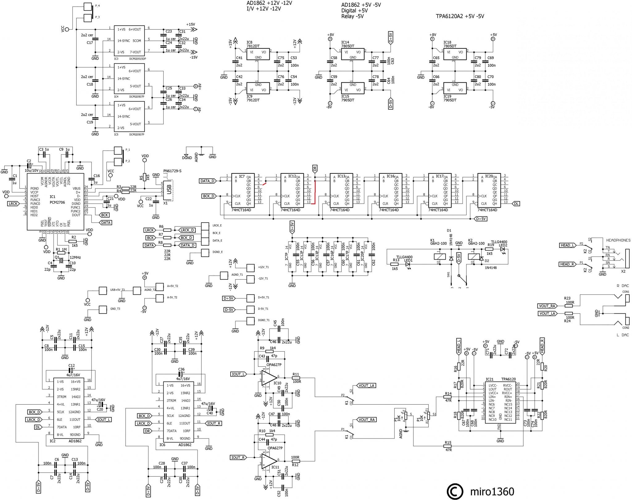

Hi Ernest 🤗 I've thought about it many times and I didn't find definitive solution for:
- how to simplify PSU? ... AD1862 needs +-12V power supply, an alternative could be AD1865 (+-5V)
- which SMD opAmp to use for I/V, single or dual? LM6172 is dual, so one part could be used for headphones amplifier
- PCM2706 (USB/I2S) does not support software controlled volume (in the player only), so what should I do with the potentiometer?
- USB/I2S from STM32F401, which could be programmed to drop the glue logic and the dac would be feeded directly
- drop the relay switch and switching audio through a mechanical switch directly
- changing some critical capacitors for THT
Hello Miro,I like DACs powered directly from USB in small case/design and I like sound based on R-2R. This was reason why this toy was created.
Here in gallery are pictures: DAC gallery
Once again small description:
- NOS R-2R AD1862 DAC
- LINE-out direct from I/V
- headphone out based on TPA6120A2 with potentiometer, easily drives big headphones with a lot of power (AKG K701)
- no additional filters (only RC)
- no caps in series with signal line
- switch between line or headphones (no need unplug something when I choose between headphones or amp), with relays
- for USB/I2S conversion is used PCM2706 (on board are also pins for another I2S), simplicity, no additional drivers, I like Plug&Play and I am listening mostly in 16bits
- power from usb is converted with isolated DC-DC DCP0205xx, regulated to +-5V for digital and AD1862 digital, +-12V for AD1862 analog and I/V, +-5V for headphones amp TPA6120A2
- it can handle custom I/V boards in small design, +-12V
- 4 layers board
I am not sure if it is DIY project, becase it is full of small 0805 SMD parts and few SMD ICs, board is 4-layers
Some build hints:
- first mount USB/i2s part and test with scope if some data signals are going out from i2s
- continue with power supply part and test, if all voltages are right
- dont forget for thermal pad holes
- mount DAC portion with relay, switch and I/V
- connect it to PC and measure with scope if sine is right (or test sound directly), because in this state it must working
- if all is right, mount headphones amp part, better if you buy 3 potentetiometers and measure them for resistance offset (left and right) in few places and choose best one (with lowest offset), dont forget carefully solder TPA6120 through thermal pad hole
- connect it to PC and measure dc offset on headphones connector, it must be small offset, about few mV
- if you wish, you can clean board from solder resin using isopropyl alcohol
- I used SMD thick resistors
- as I/V opamp choose something good, like LM6171, LME49990, ADA4898-1, and many others ...
- if you use external USB/I2S (for example asynchronous XMOS) resistors R6, R7, R8 can be disconnected and also PCM2706 power jumper opened ... on board are pins for I2S https://ctrlv.cz/shots/2017/09/19/DGlu.png
- output voltages can be easily set with change in feedback resistors R9,R10, or for headphones in gain R17+R18, R21+R22
- when you use fast I/V opamp, like AD844, only to be sure - check output for oscillations, I have no oscillations
- only to mention, here is no headphones protection circuit, so after every change in I/V measure headphones output if there is not big DC offset, must be few mV
- in normal condition, there is no clunking in headphones when switch position is changed or device is disconnected
- use linear potentiometer (if there is a link for logarithmic, use linear)
I need thanks to pavouk.org site from where I got I2S/PCM logic and thanks to Dohny for hint about DCP0205xx DC-DC.
I would like to know what if any problem can arise in connecting, on IC7, PIN 5 to PIN 1-2 of IC12; and PIN13 of IC12 to PIN12 of IC13.
