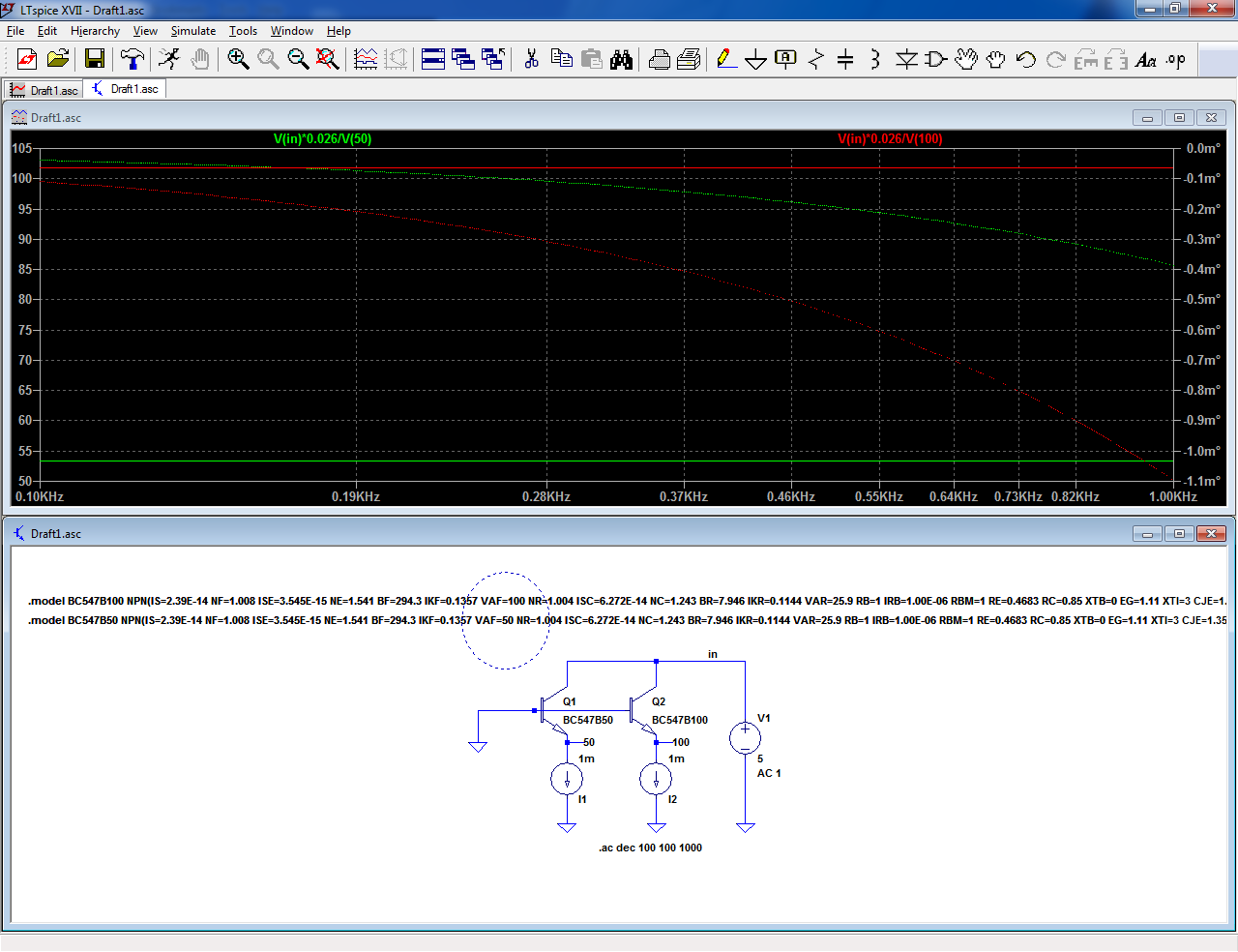

Maths cranked: Vearly = ro x Ic - Vce
The direct and naive methods of measuring Vaf (or Var) detailed in this thread are not necessarily the simplest, most accurate or most effective.
As a food for thought, you could for example meditate on this simulated jig:

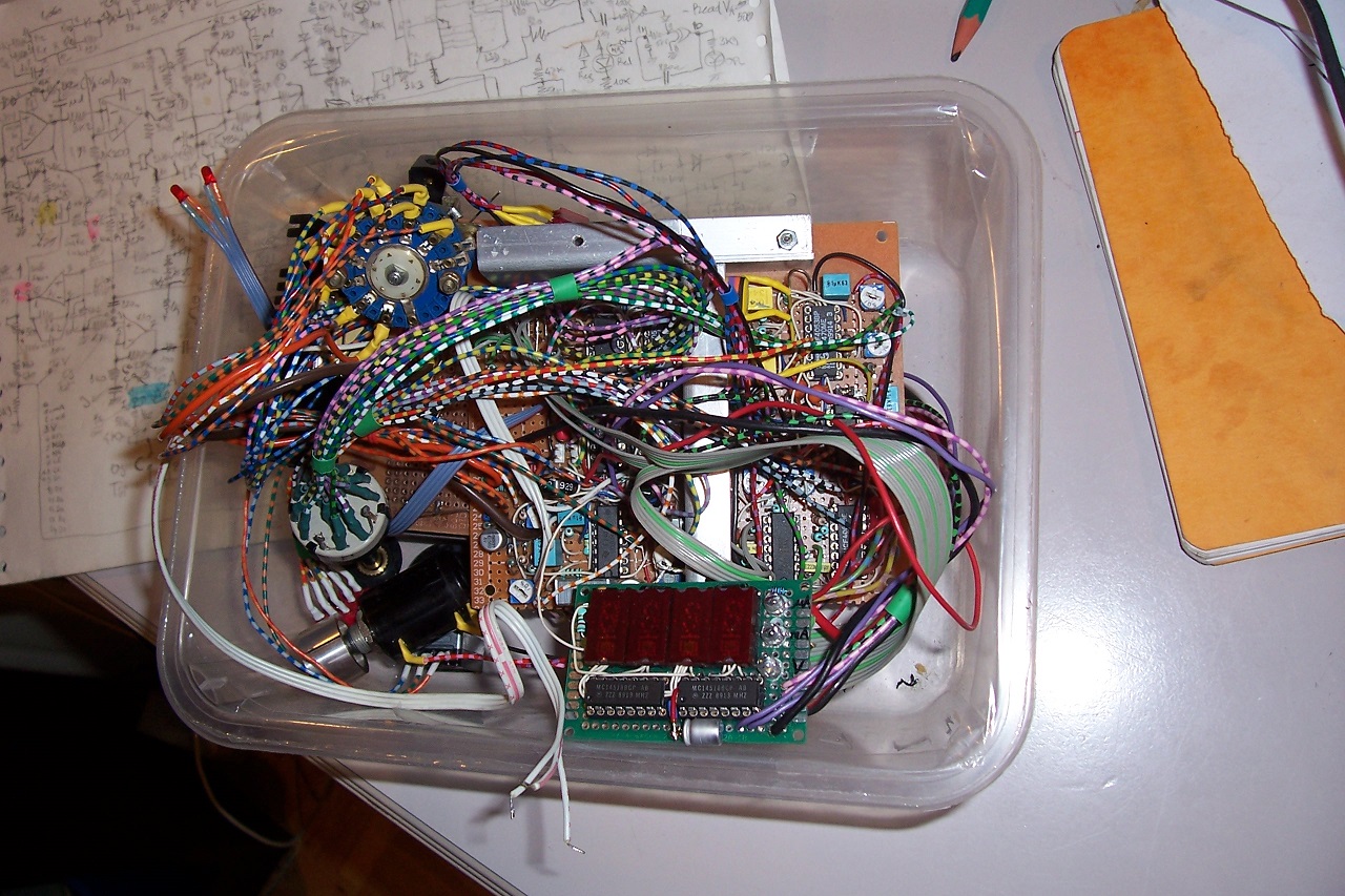

Some time ago, I became interested in the Early effect, and in particular its dependence on parameters like Vce or Ic, to better understand their effects on higher-order non-linearities
I decided to build myself a complete Vaf test set, to properly investigate.
I built a true and complete lab instrument, using an original algorithmic, charge-pump method of measurement, where the DUT itself is part of a dedicated A-to-D converter.
It measures Vearly between 0 and 1000V, with a 4-digit or 0.1V resolution, for P or N devices and the Vce can be set anywhere between 0 and 100V, and the Ic from a few nA to 100mA.
In the end, it was perfectly working and calibrated, and I made a few real test runs, only to realize that such refinements were in fact completely unnecessary: Vaf is just a single, convenient and scalar value but it is a rough metric incorporating a number of phenomenons.
This is why I didn't even care to put the instrument in a case: not that it is completely useless, but a much simpler and less accurate instrument would be ample enough for the task, and I shelved this one.

Elvee, I like this differential way to measure Va. I assume one of the two transistors is a reference with known Va.
_This jig shows the trouble made by Va mismatch in a balanced two transistors circuit like a LTP. Va mismatch clubbers Common Mode Rejection Ratio. This jig goes directly at measuring CMRR.
_It is a good jig to match transistors on Va. Constant current sources are not necessary, you can do with matched resistors ( just a bit more calculus to extract Va).
There is no need for complexity.
2 matched resistors, a power supply, a LF generator ( PC with sound card ) and a DVM.... and a bag of transistors.
A meter that reads microvolts AC.
Yes, that is something my cheapo, 1970 Levell microvoltmeter does easily and routinely, but this was just food for thought: it shows that simple alternative methods do exist, and can work quite well when used sensibly.
I didn't opt for that one, but using "modern" (note the quotes) synchronous techniques, nV or even sub-nV levels should be accessible, even with a properly used, humble CD4053.
I am not even mentioning the likes of the LTC1043, or their more modern versions

The jig does not show the differential value, it shows the absolute value for two different and known (50V and 100V, artificially created) transistors.
You can note that the resulting voltages are not exactly 50V and 100V. That is the result of the simplicity and crudeness of the test-jig for one, and the fact that in reality Vaf is a nice theoretical shortcut for things more complex, also dependent on other parameters that even spice models take into account.
However, for differential measurements, these subtleties mostly vanish, and you can just rely on the difference for matching, provided you have done your homework first, ie. you only test devices having already passed the basic DC matching tests like Hfe, Vbe@ a defined Ic.
Since all parameters tend to be heavily correlated, you should get a good match rather easily if this condition is met (for a given process, of course).
That said, I do not think such a fine matching will bring a big advantage, apart from better even harmonics cancellation.
