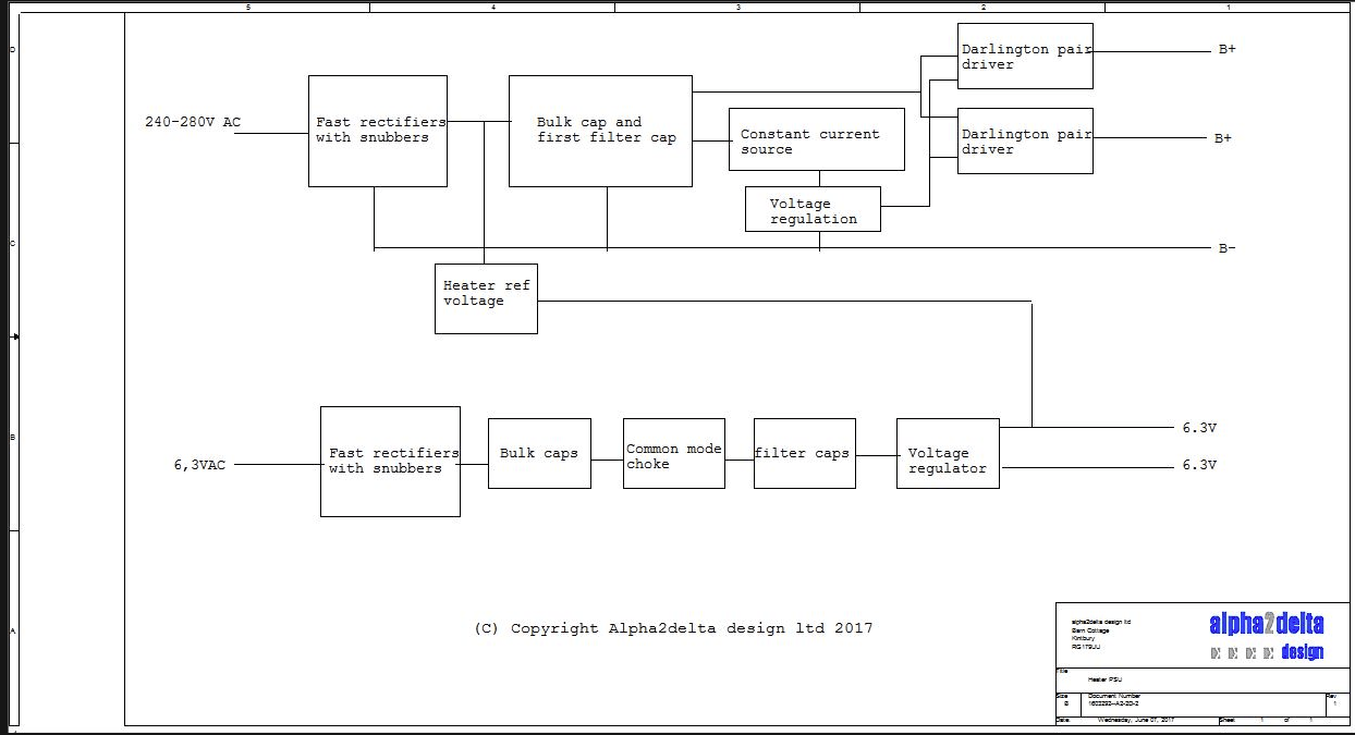

Here's some more info on the power supply. It was designed to power stages like this EAR clone. It was made available as kits to people in the Lenco forum and eventually packaged as a commercial product. The website seems defunct now but the designer is still a regular on the Lenco group.
From her: If you have been following the epic ear thread, you may know that I have designed an improved PSU stabilising the B+ and supplying dual mono outputs, regulating and common mode isolating the 6.3V along with many component choices that are known to improve the sound like diode snubbers and polycarbonate caps."

Excellent! That's a conventional "linear" power supply, except better executed than usual. I was worried, seeing the ferrite core choke and fancy capacitors, that it might have switching regulators, which are fine, but can radiate more noise than conventional "linear" regulators (because at their higher frequency of operation they're better transmitting antennas).
B- can be brought to the PCB along with both the B+ 's, twisted into a three wire bundle. If you had a factory wire with three internal conductors plus shield, you could use that, but an unshielded twisted threesome will probably be fine. Do not also connect B- to chassis directly - ground loop.
