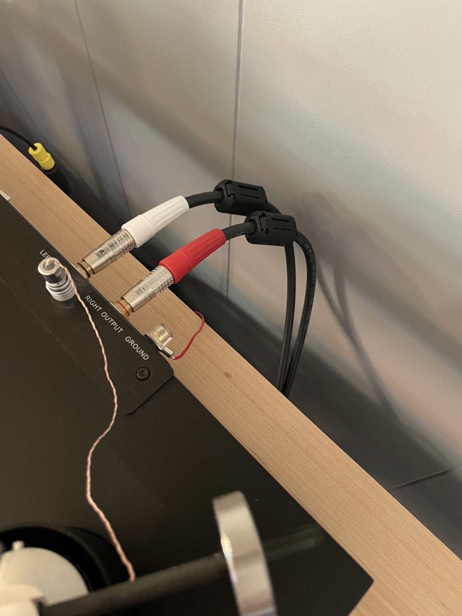

Finally getting around to reporting back...
0.01uF ceramic disc capacitors from the input RCA to ground lugs helped but didn't solve it.
Bundling the interconnects to/from the phono pre with some zip ties changes the antenna effect and reduces the FM intrusion. This is a relatively significant improvement.
Ferrite beads on the turntable>phono pre interconnects knocked out what remained.

A photo please...
A photo please...
