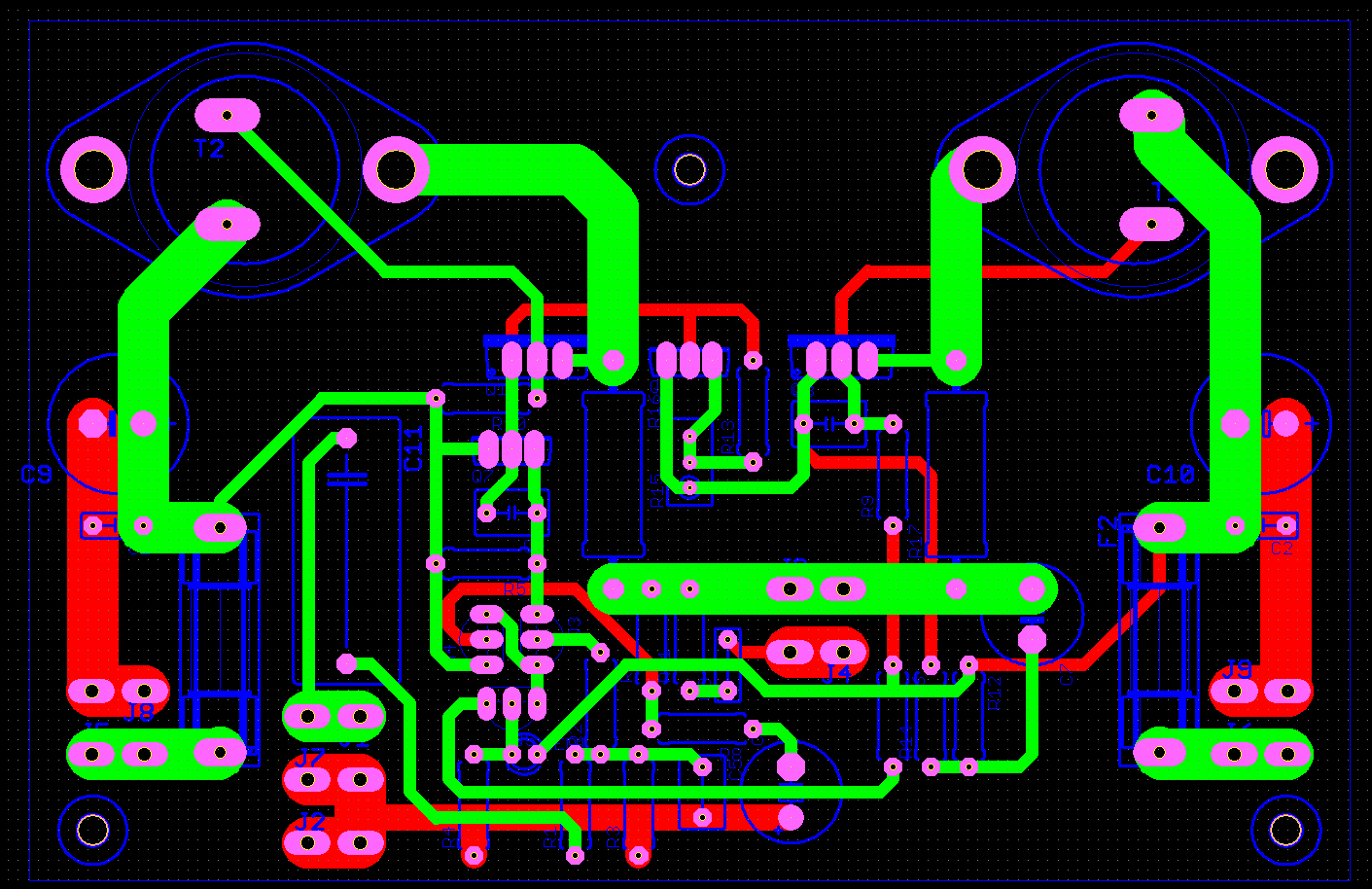

Im having an issue with gerber files generated from Eagle.
Looking at the gerbers with viewplot and everything is okay, except some of the drill holes arent present, on the polarized caps, some of the transistors and the big input film cap.
Whats up with that? and how do I fix it?
Note : Im using the standard libraries that comes with Eagle so that shouldnt be an issue.
Ran drillcfg.ulp, create excellon drill files from the .drl file with excellon.cam and then I created the gerber files with gerb274x.cam.

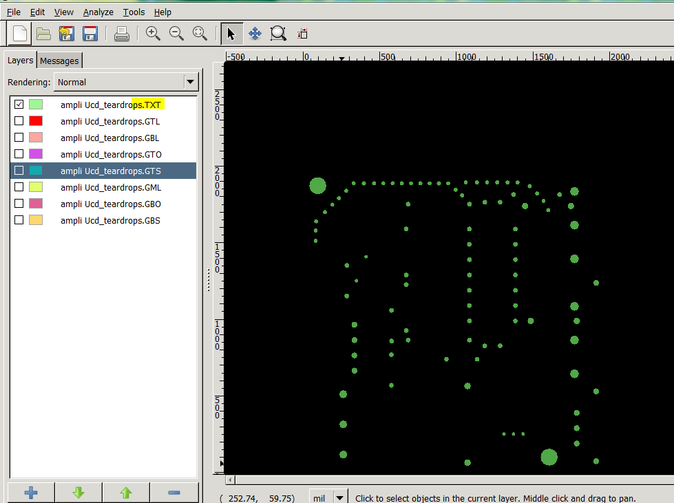

I have no problem with drills on eagle.
To see the drills corectly you will need the right file to be read by gerbv.
The file has extension *.txt , You can get 2 or more drill files as the manufactures needs.
Maybe you have to check again your cam generator settings.

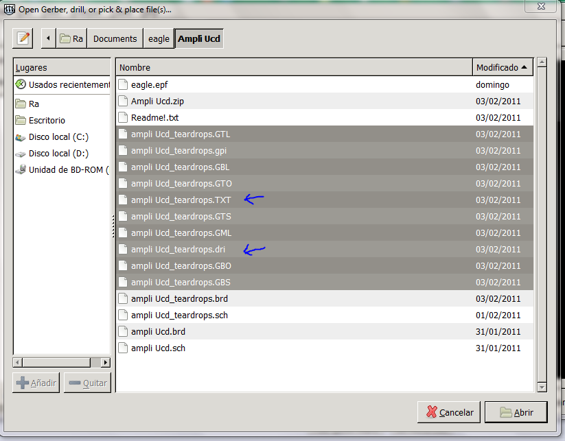

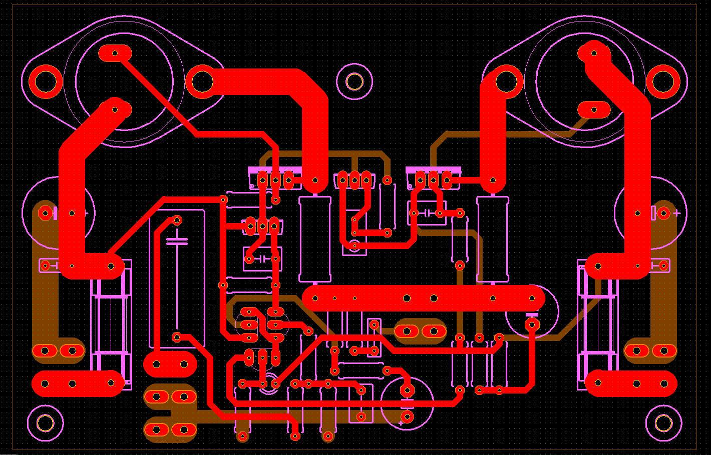

Well, found a cam file from sparkfun(sfe-gerb274x.cam) file that outputs :
* Top and bottom copper (.GTL, .GBL)
* Top and bottom solder mask (.GTS, .GBS)
* Top and bottom silkscreen (.GTO, .GBO)
* Drill file, 2.4 leading (.TXT)
It output a .dri file as well.
And it looks as it should, see attached image.
Would that be enough for most boardhouses or do they need more?
