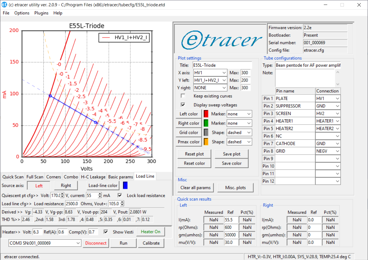

Try this.
It's enough close to the real curves.

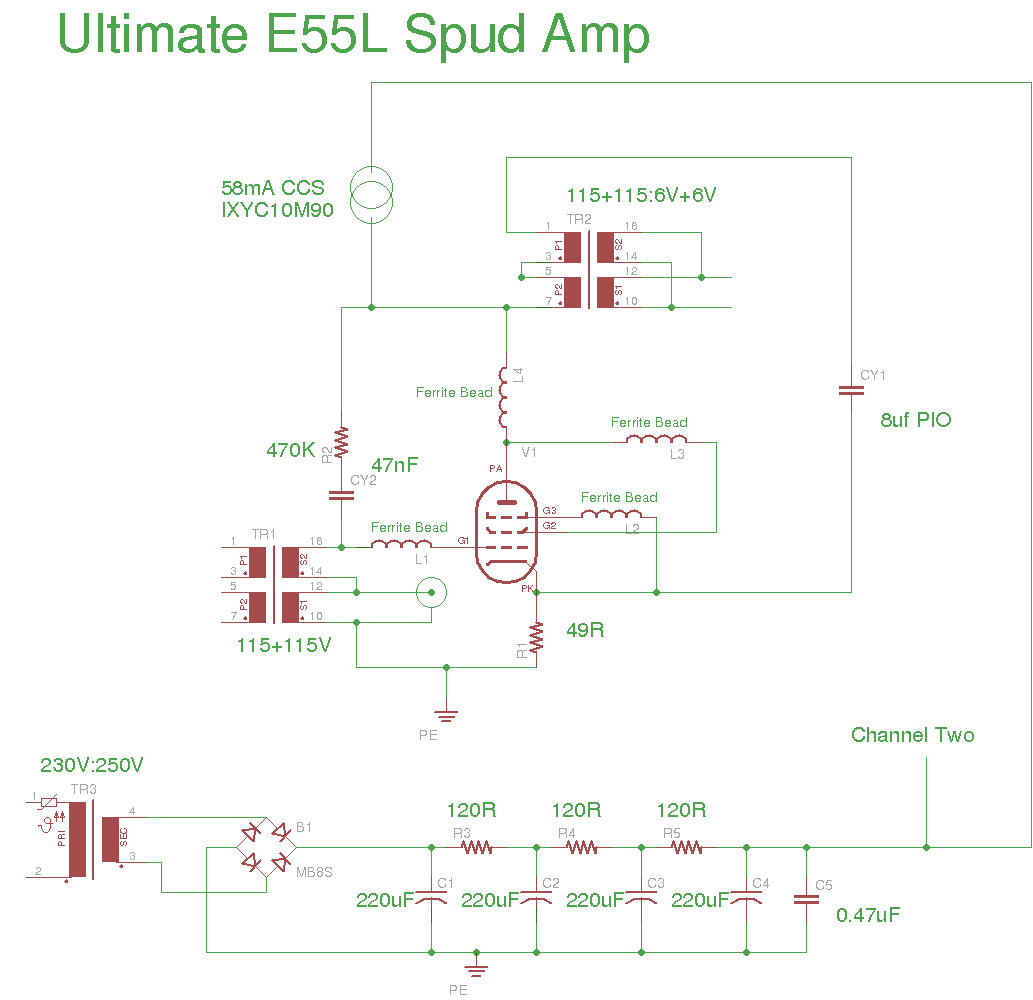

I am using a spare transformer for this project, 325VAC, a choke load is not practical with it.
I see the additional PSRR as only a benefit, which will reduce the number of components needed in the passive supply. The OPT will also have headphone output taps.
Other than the heat, which is accounted for, what is the downside?
IMHO the downside is the parafeed itself.

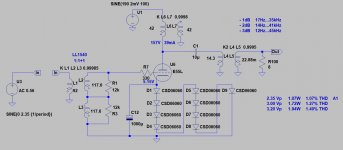

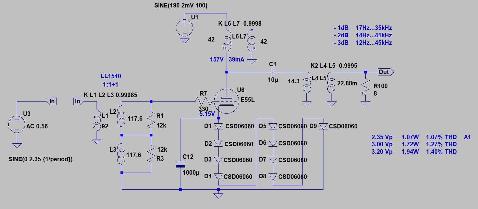

About a year ago I tried -as breadboard- the E55L parafeed layout, but it wasn't better (measurement), than OPT loaded E55L spud.
BTW the tried 1:1 -Slagle- interstage almost as costly than an OPT. :-(

An IXY by itself will have an order of magnitude higher impedance and lower parasitics than any OT so its impacts on the overall sound will be swamped. It can also cope withe the dissipation adequately if heatsinked. A stacked CCS is just overkill in every department.

I usually use cascode CCS as load, but serial connected capacitor and OPT primary, which is represent frequency dependent impedance (due to the loudspeaker and his crossover) always problematic.
do you you have any measures to show the issue? I like parafeed, its better than OTL to my ears. I understand the maths, but is it measurable?

Can you connect L4 direct to V1?
Cheers, Mike
Yes, but I have been persuaded to go cathode bias by the folks who have chimed in due to propensity for thermal runaway and high grid current of these frame-grid pentodes. Updated schematic is in post #27, thanks for checking it out 🙂

Well thanks Shoog, I'll take a look, do some simulations. I was more interested in the increased ripple rejection that could be attained in cascode and reducing the number of passive components in the supply, but perhaps it isn't necessary, will report back.
That is quite the diode string, euro21. In what way was the parafeed setup inferior? Very happy with my 45 parafeed SET. I know many do not like the reactive load, but substitutes high quality cap into the signal path as opposed to last PSU cap and simplified power supply with good PSRR. Bonus for me is I have a Sowter mains transformer appropriate for the project, with CCS load as opposed to choke.
