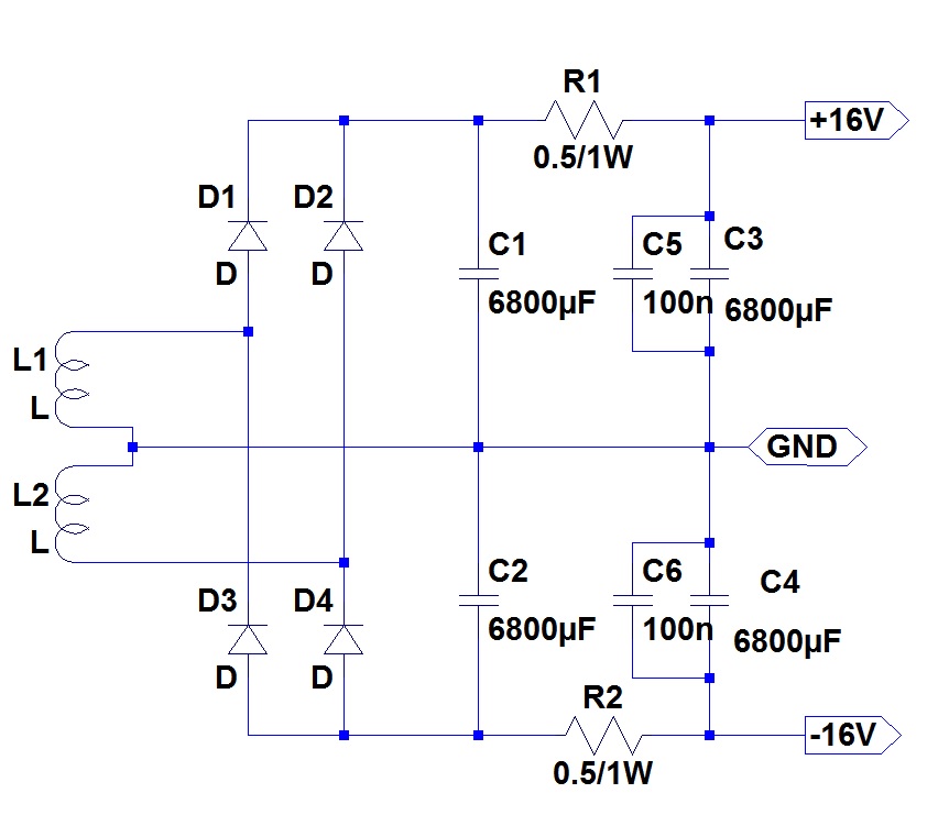

I put snubber circuits on each supply, where the power enters the board, was an improvement overall. This doesn't probably have any effect on humming/ground problems however.
Another great tip I rceived from a most well qualified source, was to place a 22pf silver mica cap across the the gate to rail of the outputs.
Solder the cap right next to the transformer ground. The hum is still there, much lower, but still there.
I used an old cap from my tool box. Not sure how good it is and it may have too much leakage. I will try a fresh cap before messing with the ground traces.
Then, perhaps it does take re-wiring the power supply section to get rid of the hum.
An alternative to having to hack the board could be to build an out-board split rail DC PSU, like the one in the schematic in my last post, to supply the E19 instead of supplying it with the power transformer. Remove the 6,800uF caps and re-use them in the out-board DC PSU, do not leave them on the E19 board.

I have some "LM317 LM337" based DC power supply boards in my tool box. The cap on each rail is much smaller, 1000uF/35V, but it is IC regulated. What do you think of using it?
That will beat the on-board un-regulated PSU hands down, and a very clean, mess-free mod too.
You will need to wire the positive output from the rectifier at the input of the 317 to the input of the 7812 on the E19 board, and remove the 470uF cap you put in.

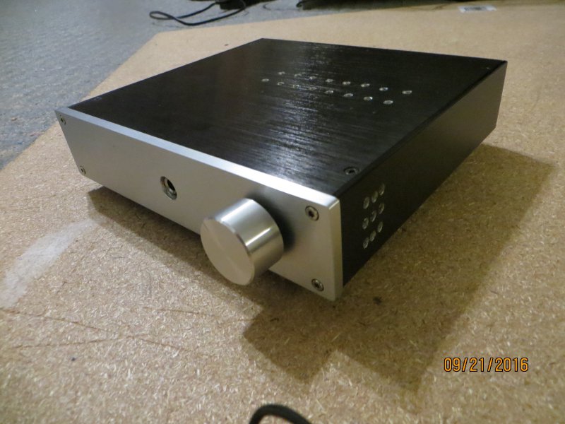

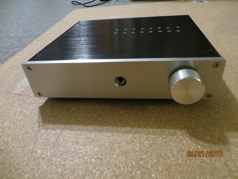

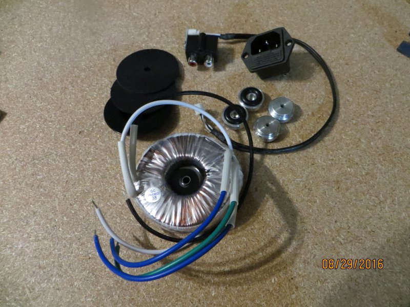

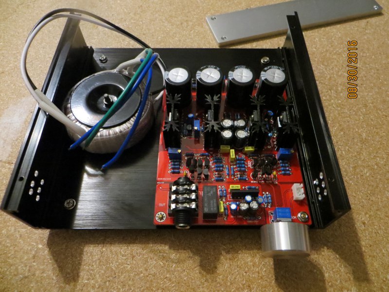

Build log of E19 headphone amplifier
I have a completely assembled E19 headphone amplifier in an aluminum enclosure. The sound is excellent in staging and dynamics, but a low level hum persists. The hum is most noticeable with Sennheiser HD598. With the Sennheiser PXC250 or the very old HD-420, the hum is hardly noticeable. My next phase is to add a fully regulated power supply.
Below is a pictorial building log of the E19 project:
The board
The board
E19 headphone amplifier build log

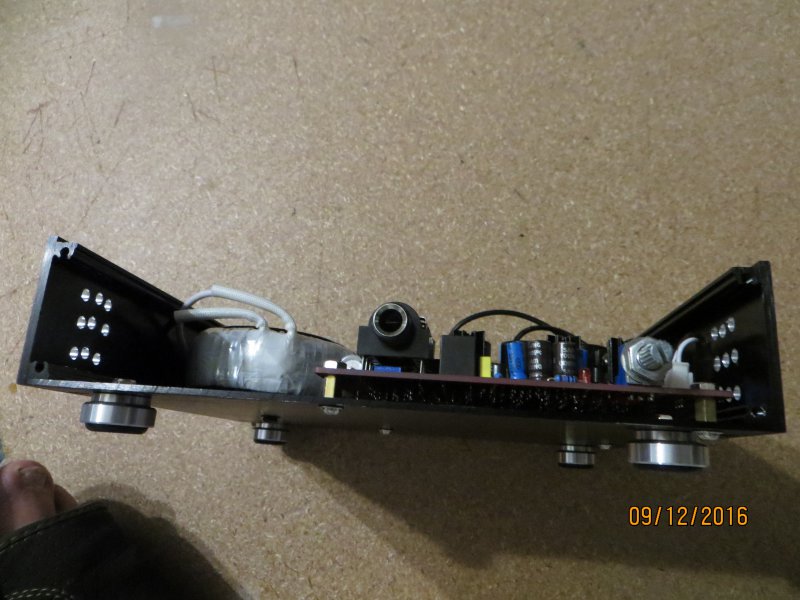

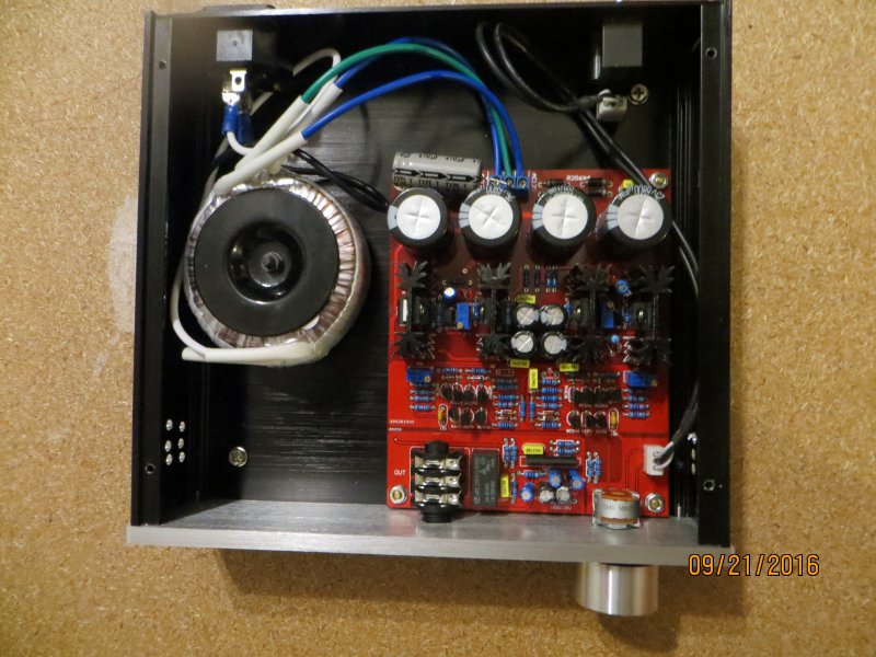

The board looks very good build quality, but has design fault as nattawa pointed out in his post #2.

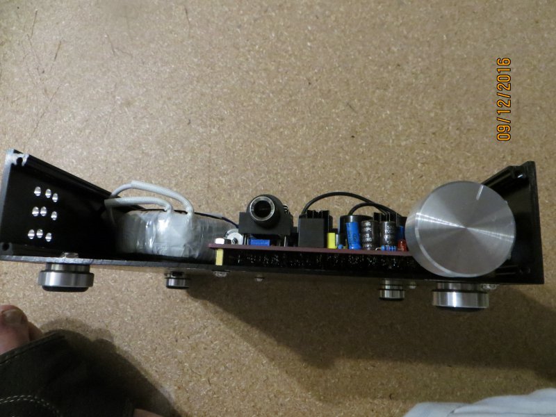

The location of the volume control and headphone jack are different from any pre-drilled enclosure for headphone amplifier. I got a blank panel enclosure. The picture shows the bottom with masking tap for marking the drill location for mounting. I use leftover mounting post from my computer building day. It works very well. It is very difficult to drill the precision location on the front and back panel with a small table top drill press, not recommended. The transformer is a 30VA toroidal. Total parts outlay is just under $100 at this point.
I drill ventilation holes on the side and top panels.
The E19 board uses a small RK9 style volume pot which makes the volume knob sits very low. I replaced it with an Alps RK16, 50K pot. It sells for $7 on Ebay.
The finished headphone looks fine. I added a filter capacitor to the 7812 regulator for the protection circuit. It reduced the hum, but did not completely eliminate it.
I'm sure that hum is very frustrating after all the work you've done.
Too bad the board wasn't designed correctly to begin with.
Yes, I am disappointed, but NOT exactly surprised. It is the nature of getting China-designed-made electronics on Ebay. There were very high quality gems mixed among junks. I tried to identify reliable sellers and come to forum like this to get information. A few years ago, it will not be possible to assemble this professional looking headphone amp at the cost I paid. Most importantly, the amp does sound very good driving the HD598.
I could have purchased the E-5 head amp board and pre-drilled enclosure at the same total cost. I felt like being more adventurous when I bought the E19. With more effort and additional parts, I believe I can get a hum free, high quality head amp box. Wish me luck in my adventure.
The hum is barely noticeable with Sennheiser HD598, but I am very sensible to hum. With the Sennheiser PXC250 or the very old HD-420, the hum is hardly audible. As is, the E19 head amp with the filter cap for the protection circuit may be acceptable to 90% of the users. It is a fun project to add the regulated supply.
