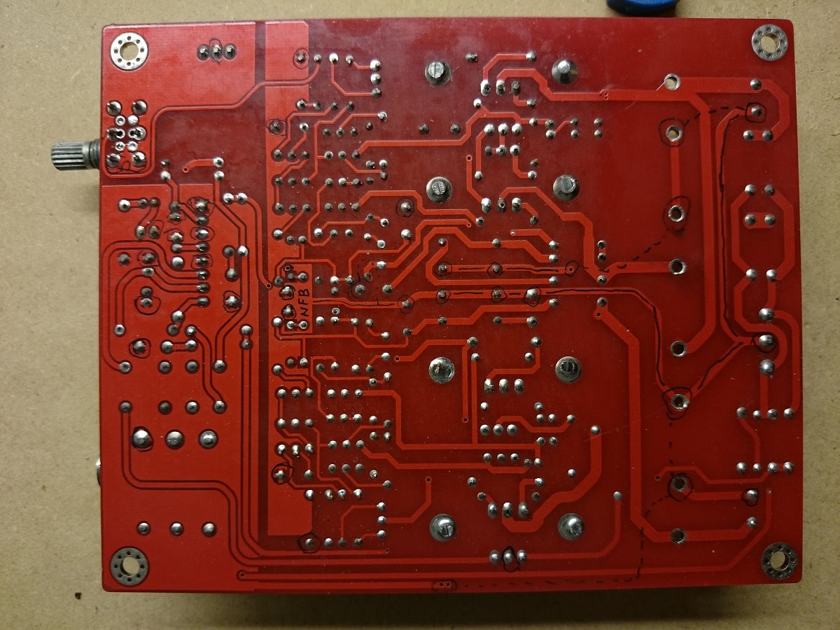

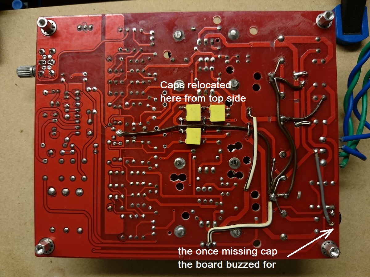

I am kicking myself today. The original toroidal transformer was purchased from a seller in China. I got 2 awhile back and they look like good quality.The upgrade with a regulated PS is finished. I used a simple pair of L7815/L7915. The picture show the stock form PCB vs. the modified PCB for the regulated PS. There are 4 jumpers in red for the positive PS side and one in white for the negative side.
View attachment 688631 View attachment 688632
The good news is it works and the hum is greatly reduced to almost inaudible level. The bad news is the hum is still barely noticeable. But it is so low that I can ignore it. It took me only 2 years to finish this project. In between, I retired from my day job and moved from St. Louis to Chicago.
The sound driving a Sennheiser HD-600 is wonderful with a good depth of the sound stage. It is particularly good when listening to symphonic music where the orchestra is projected in front of me, not in the head. The regulated PS also give a more authoritative bass. The overall sound is very open and similar to the unmodified board.

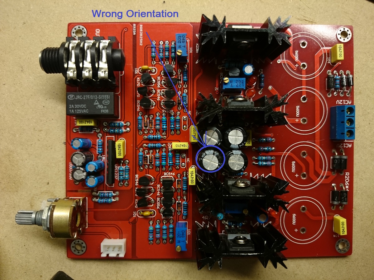

The quality of the E19 PCB turned out to be very good with dual surface trace and plated through holes. It was a real struggle to removed the 4 6800uF main filter capacitors. The headphone amp did not work when I put it back together the first time. I eventually found that one of the plated through hole was damaged and cut off the 12V supply to the protection relay. I added an extra jumper and everything are fine.
One side note on the L7815/L7915 regulators. I purchased 10 of each with the intention of selecting the best matched pair. Alas, the L7815/L7915 are 0.4 volt apart on the average. The lowest 7815 output is 0.2 volt higher than the highest 7915. Fortunately, the E19 seems to have very good CMRR. Despite the unbalanced PS, the output DC offset is only 1 mV on one channel and 9 mV on the other without trimming.

The E19 board has very well designed amplifier topology. The circuit board construction is very good. But the ground loop in the PCB layout is terrible as nattawa pointed out earlier.
I recently get some toroidal transformers from Antek in US, which are much cheaper due to US shipping. I replaced the transformer in the E19 headphone amplifier box with an Antek 25VA/20+20V one. All traces of hum are gone. The E19 headamp is now dead quiet. I wish I try that a long time ago. Oh, well.
I found the hum problem of the Chinese toroidal when I used one to build a linear power supply for a DAC I just got. Well, a $50 purchase down the drain, but I new get very quiet PSU using the Antek units.
Does that mean that the E19 board was fine all along, just a transformer that was made poorly?
Or is it indeed required to improve the grounding within the board?
Since I discover the transformer issue after I modified the board and added regulated PSU, I would not have known how to answer your question. I would not have suspected the transformer if it did not produced hum with the linear PSU I built for an ES9038Q2M based DAC. In both cases, the hum disappeared after I substituted the transformer with units from Antek.Does that mean that the E19 board was fine all along, just a transformer that was made poorly?
It is possible that the E19 board might have been fine, but I have no proof of it. I did not modified the grounding. The hum was barely detectable after I add the regulated linear PSU.

The DAC may have better hum rejection because it is also hum free with a switching PSU (power brick). The hum was pretty loud even with a regulator for the linear PSU. But the transformer change gets rid of the hum completely.
I had forgotten about how the main filter caps were said to have been in series, so it’s not likely to have worked (as well) without some extra work. Still probably worth the effort, the other board that this one appears to have copied works very well.
