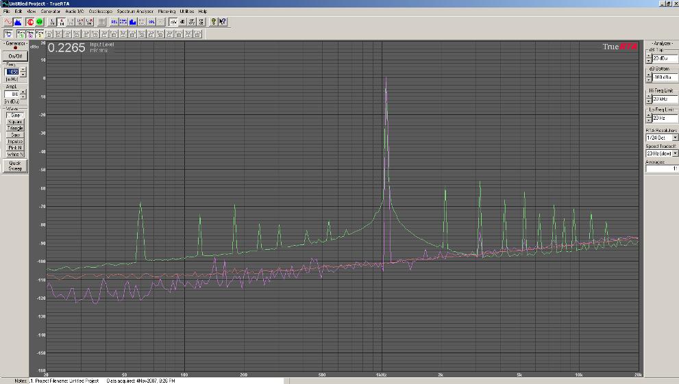

Hi Guys, I am back 🙂
This time I decided to give a try and use a soundcard as a measurement system.
I have TrueRTA software for some time and I was never able to use it with cheap soundcards (major problem of course was the noise at mic input).
The attached picture represents three measurments:
1) soundcard in and out looped, no signal (red)
2) soundcard in and out looped, 1059 Hz sine wave from TruRTA generator (purple)
3) 1059Hz sine wave form my BK Precision Dynascan 3030 functional generator unbalanced out to balanced in (green).
When soundcard in and out are looped (purple), there is almost no 2nd harmonic and the third one is at -84db, which translates to less than 0.01% HD. Not bad at all 🙂
bad news is that my Dynascan generator sucks 🙁
