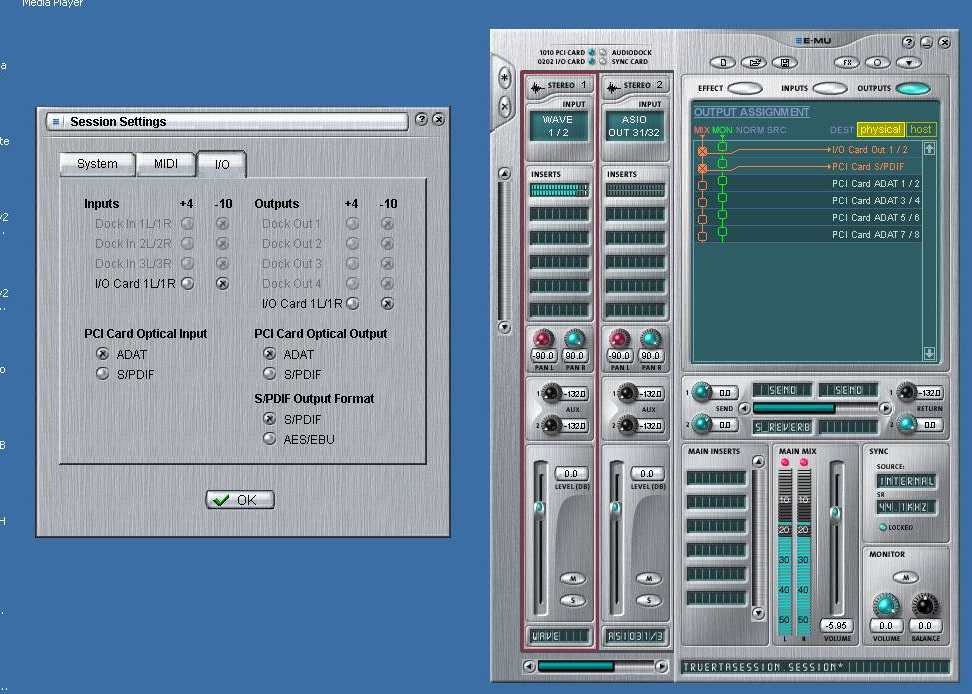

Hi again guys,
Today I tried to use analog out of the card. Spend an hour and can't make it work, both analog inputs and outputs are dead 🙁
Dont believe that daughter card is defective, more likely I am doing something wrong.
I am attaching a screenshot of a simple session where I wanted to send WAVE to analog out. I have sound at S/PDIF but not at analog out.
I really appreciate if somebody could point out what's wrong in the setup.

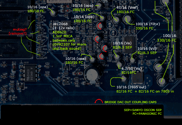

Come on, this is DIYAUDIO, get that soldering iron out of the closet 😛

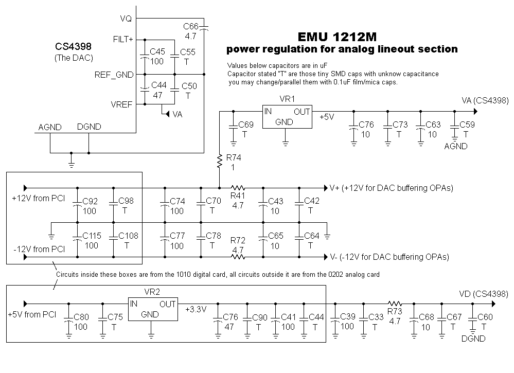

Schematic (sorry, caps marked with T are ceramics 100n 0805).
Oh, another worthwile improvement not marked in the pic is changing the caps on Vd and Va on the DAC to 4.7uf 0805 ceramics instead of the 0.1uf originals, and change R74 (the one after the 7805 reg with a suitable inductor - this one is actually huge improvement).
Of course, use regular OSCON SH if you can't find OSCON SEP. And maybe change the Pana FC to something to your taste.
And if you don't have any caps on hand for starters bridge the coupling caps between the dacs and the buffering OPAs. Be prepared for jaw-drop mode.
Another tweak (if you have a next stage with suitable impedance is bypassing the output stage alltogether - just remember to use say 22R resistors to isolate from cable capacitance on the CS4398 out - download datasheet to see what goes where as signal out - mmm balanced).

Thanks for the schema and the pics, lucpes.
What is the total DC-offset after bypassing the DAC caps?
My system is totally DC-coupled and even a small offset creates SQ and DC problems at the amp output. I had picked up 47 uF FC caps for the output, and was considering ordering some BG 47 uf NX caps for those positions.
Also Iron dreamer on the Head-fi forums did extensive mods (wait a minute, weren't you there too?) and found there was no benefit to increasing cap values, just upgrading to better caps was enough.
Lastly, did you or did you not add local bypass to the 2068 or replacement opamps? The creamics are quite some way away from the opamps, and maybe the opamps will benefit from supply bypassing.
